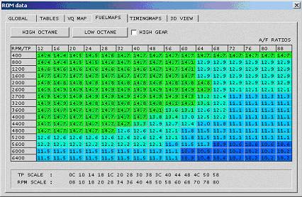

Ok as we now know the full spec I can see you mention the injectors are 440cc, may as well stop right there as we never sold any chips created for 440cc injectors, given that it is likely set for standard one`s there is your over fuelling issue right there, however if the chip is set for 440cc injectors then it will not be a Zedworld one or has been modified by someone.
When connected to a ConZult or similar diagnostic you can easily see what the injector size the map is for by clicking on the GLOBAL tab as in the image below, I would suggest this is the first thing that is checked because if this is wrong your wasting time and money.
