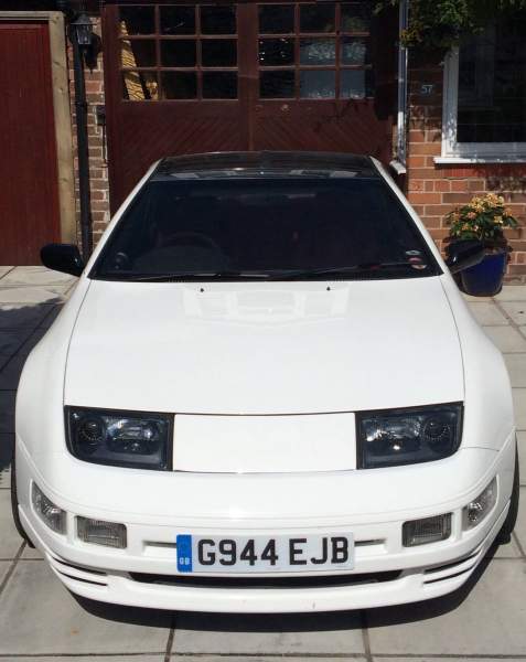

I am 16 and i recently purchased a 300zx 3CP7bee3.jpg and it will be my restoration project for a couple of years.
The car is 1990 automatic Twin Turbo targa top.

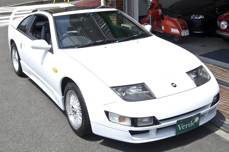

- (apparently) really rare JDM from and back bumpers but missing the side skirts in the set (if someone could identify the bumpers that would be great so i could find the skirts for it watch?v=EfbMa9s61v8
