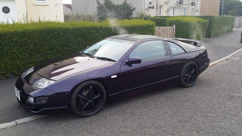

MOT - First in three years.
The rebuild is complete and its MOT time.
Driving to the garage that done the respray at about 8AM tomorrow for a quick check over
then they will take it to the MOT station for a 1:30PM test.
Nervous as hell about it so hope all goes well.
The only issue I can foresee is that its a 1996 and I decatted it but I'll just say it was a 1992
and it was imported in 1996 or something.

Gutted for you Lee:( so much work gone in to this,I was looking forward to seeing your zed so you must be gutted,these cars are very testing at times.
Most of the issues don't seem too bad
The front upper wishbone is so think that I believe can be got around with a letter as it is part of the design, so I have heard
The last two can be sorted.
The rear wheel bearing is not a bad fix, just have to get hold of one.
The engine is probably a setup issue, have you boost leak tested it, is the timing correct (auto conversion), are your pcvs ok. I'm sure it's something small

I checked the top camber arm last night and it turns out its just the adjustable bolt that's loose, although I took the
full bloody thing off before noticing and now I cant get it to line up properly to fit the bugger back on.
With the wheel bearings Lee also suggested they don't often fail and they are on a spline and more than likely the bolt
is loose; well then I remembered two years ago I had the full back end off when I fitted my Driftworks kit and I never
torqued up the bolts so they likely are slack.
The side indicator on the drivers side was just a loose bulb which was working the night before which was fixed onsite.
I also discovered that both my alloys are slightly buckled so I now also have an excuse to get new ones. :)
Small problems that can be fixed and i'll update on the engine tonight when I take a proper running video.
Have they actually told you why they believe your engine to be knackered...?
Same question here tbh
Membership No 0780
INSURANCE GOOFA
All they said was it sounds like a bottom end issue like the crank / shells.
But they said I shouldn't be driving it as it may cause more damage.
Also said that it had low oil pressure, but after I checked the manual I think that's ok for idle.
I'm going to wire up my aftermarket gauges tonight to get a proper digital reading.
I bet all you have is a bit of lifter rattle as it's been sat for so long! It's burning off residue etc. Needs a good few hundred miles under its belt. Where does the needle sit when the car is up to temperature?
I'll do a full video tonight and its booked in for an independant mot in troon tomorrow.
This time i wont mention anything before hand and see what they say.
Apart from the engine there is 4 faults which i can fix today and tomorrow.
Slight play in both rear wheel bearings, front left camber needs fixed.
Thats it.
check the bottom crank pulley hasn't separated the outer section from the centre piece..... mine did this and it sounded just like that...... the give away was my timing marks said I was miles out using a timing gun...
The dampener goes and it slips.....
Just an idea......?
