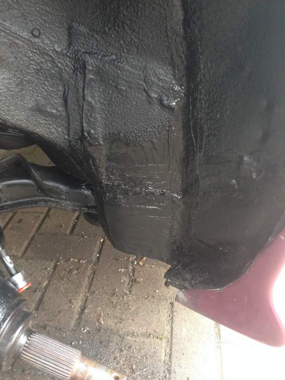

I am now inspired to rebuild her again....... suspension, brakes, all undercarriage is coming off and being media blasted, treated for surface rust, checked and powder coated or painted.....
I am going to soda blast the rear diff to remove the rust and corrosion.....
I now have a media blaster, workshop, Bilthammer rust treatment, new drop links, new brake pads, Caliper paint and am ordering new brake lines now.
I just need to get new discs all round, top shock mounts, handbrake shoes and bushes....
I am also going to weld up the spoiler holes and rear wiper hole....... replace N/S front wing and fit side skirts I got from Dan........

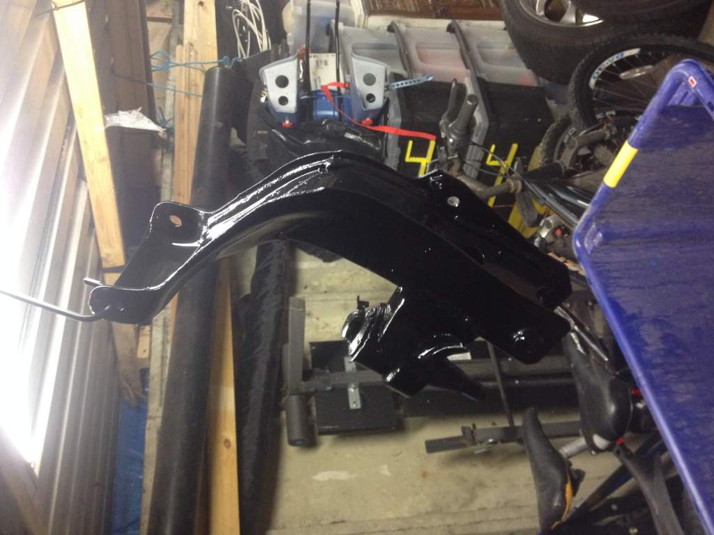

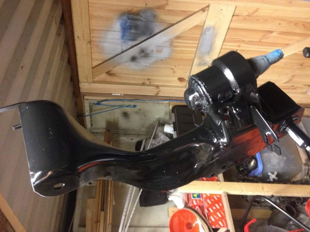

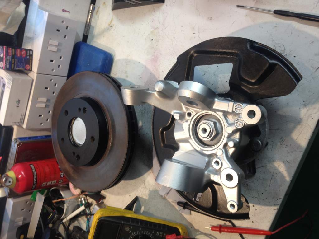

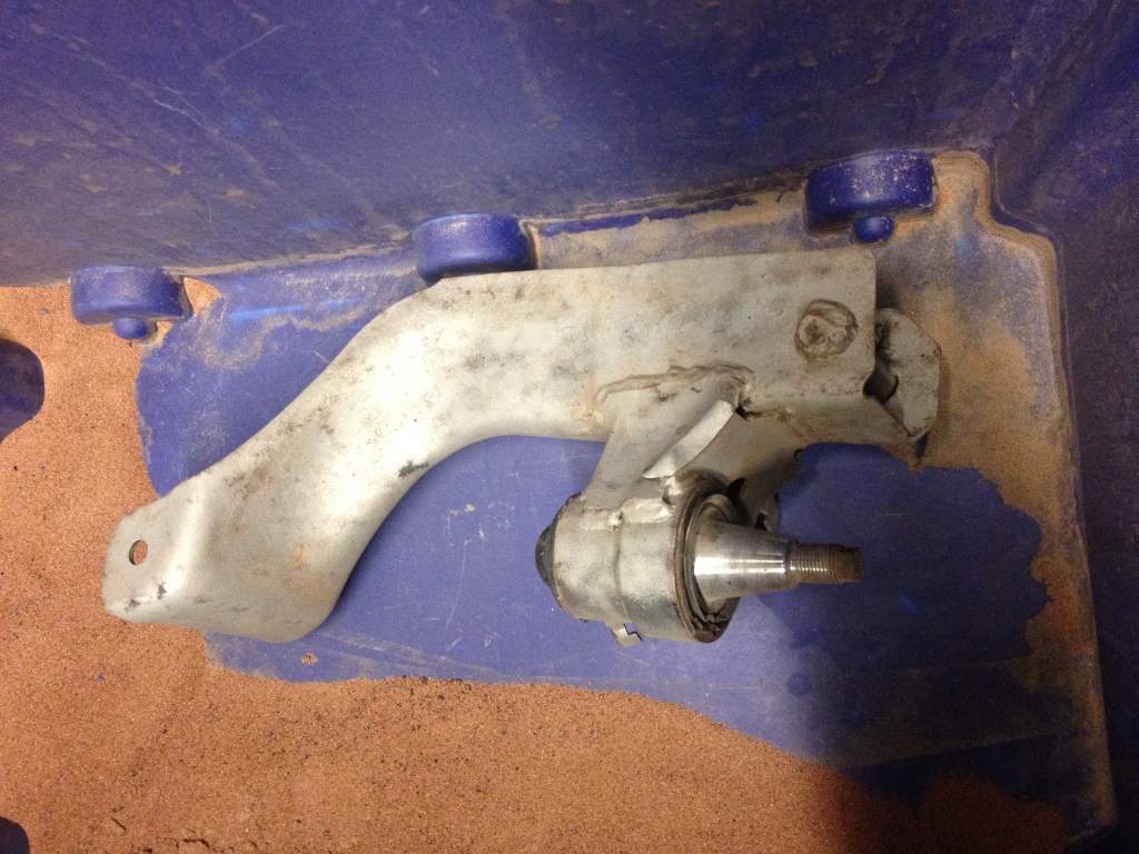

Stripped the N/S front leg and was left with bare metal part..... It made a lot of mess outside my workshop, so need to build a cabinet to reuse the media so it drops into a container.
Next it was treated with some Deox-C rust killer and wire brushed with small brass brus, finally washed off with clean water and dried.
Next part was to zinc primer it to stop any rust coming back and now painted with satin black to look like this.....
Not 100% happy with the finish...... so might be stripping paint off again and rubbing down to get a smoother finish......

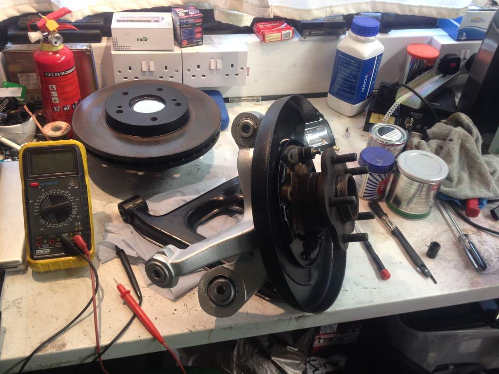

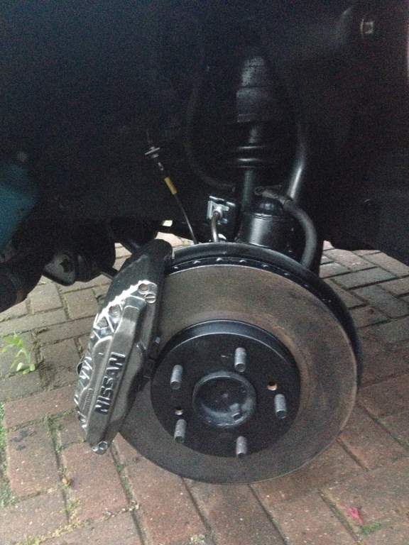

Well I am nearly ready for the refit saturday...... then I need to do the same with the O/S front and rear as well.....
Some pictures for you lot..... lol
  • 1 month later...

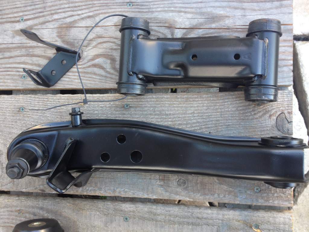

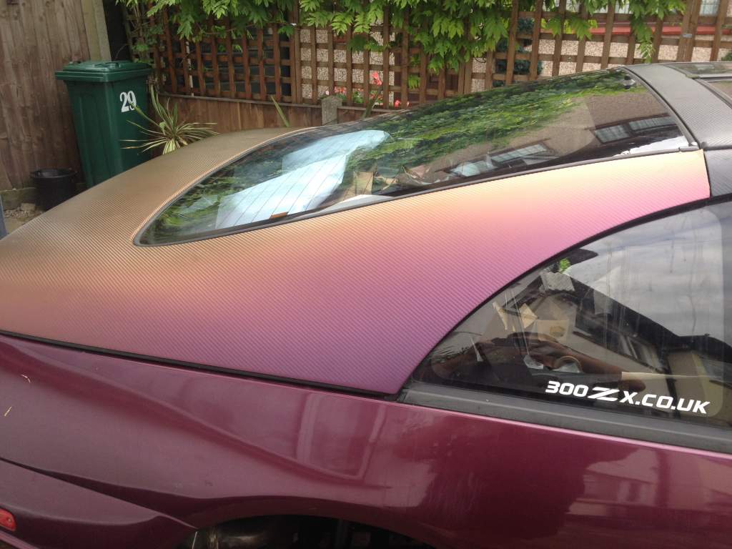

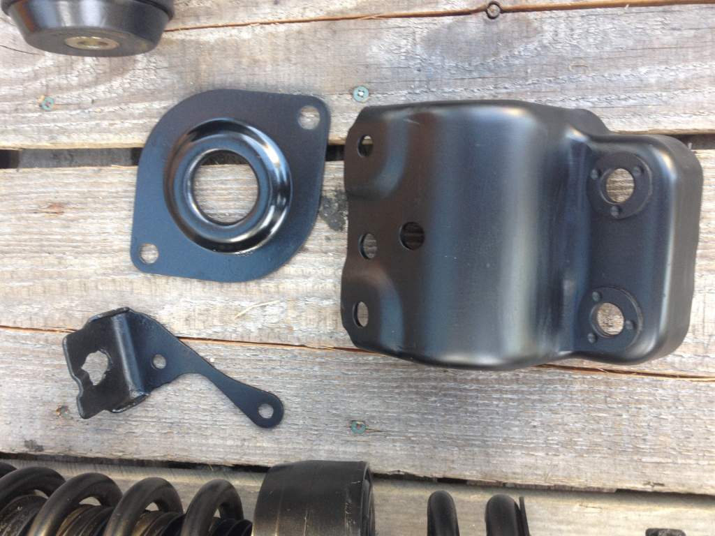

Up to date pics of suspension and boot lid's temporary wrap till she gets sprayed.....

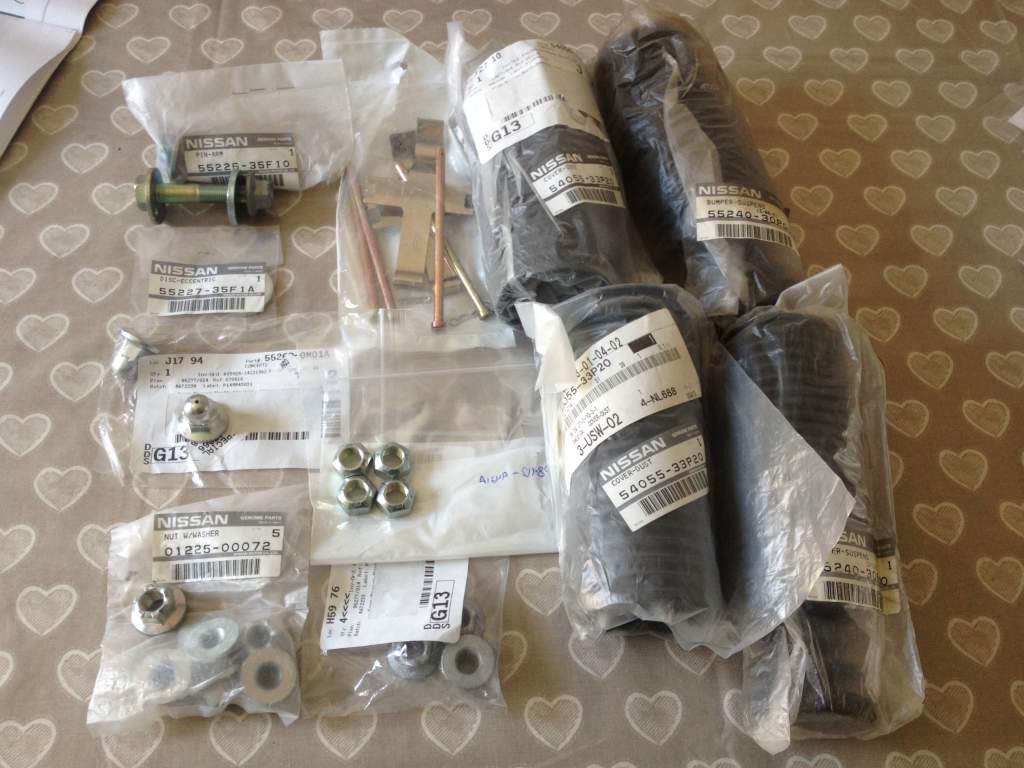

Also received the parts I have been waiting for from CZP.... just too late to fit them before the MOT or Beaulieu......
New front and rear shock absorber boots and bump stops, brake calliper pins, suspension nuts + Eccentric bolts and washers
Thanks to Stephen sending me his spare Eccentric bolt I managed to clean that up and use my old washer..... So shall be sending it back all clean to him for a spare when I fit these new ones....:thumbup:
Looking good.
Did you manage to wrap the boot lid in one piece?
I did..... Was a royal 'PITA'..... measured out a piece big enough and then folded in half. Removed half the backing paper and started from the middle of boot window working downward. Then worked from middle to edge of boot lid lifting and repositioning when required.... I can still see the areas where the paint was missing from boot lid, but at least it will keep water off for a few months till respray....
I have got one problem area on O/S rear corner where it has decided to crinkle up.... think I over stretched it a bit or not enough in other area's..... going to use hairdryer when I get a chance....
I cut out the window area after fitting......
