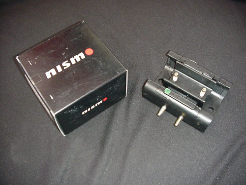

The Transmission is now mated with engine successfully and split rear mount temporarily fitted for testing purposes only as I had to order a Nismo one from the USA as they could get it here in a week thank god!
