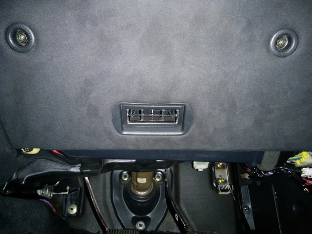

Driver's side under dash vent

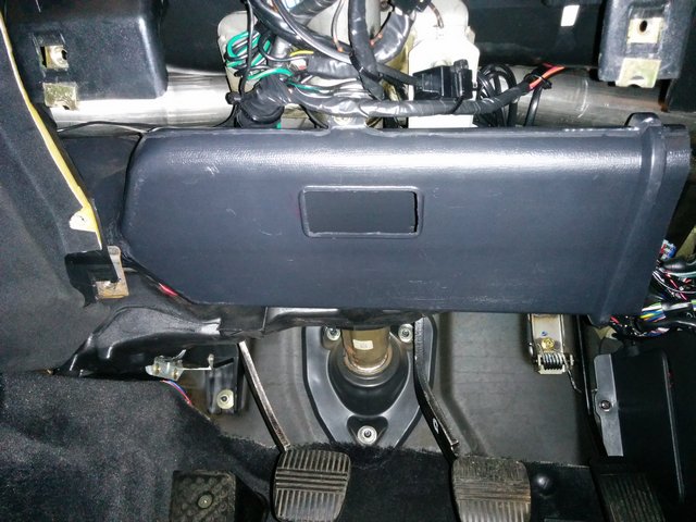

The driver's side under dash vent was missing (not factory installed) on my UK car and I'm pretty sure it is not on imports either
(possibly only early 89 cars). The vent installs below the steering wheel on the lower trim and when not present normally has a
plastic cover in its place.
The part itself is NLA from Nissan (part #68905-51E02) and mine came from a breaker in the States which a fellow Z32 owner
sent over to me - thank you.

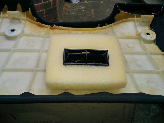

The install just involves cutting the ducting where the raised section is with a sharp knife and fixing a small piece of foam on the
back of the panel to provide a seal when the panel is back in place. The vent is adjustable to point at the feet or alternatively at
the crotch which is handy on a hot day!

i installed one in my jdm a year or two ago along with the factory precut duct tube panel and from my research information it was an optional extra you could choose to buy along with all the other options on the z. as for function it serves a purpose and it does make the aircon keep the driver cooler better with this vent installed on hot days as well as warmer on vold days. highly recommend it if you can find one.

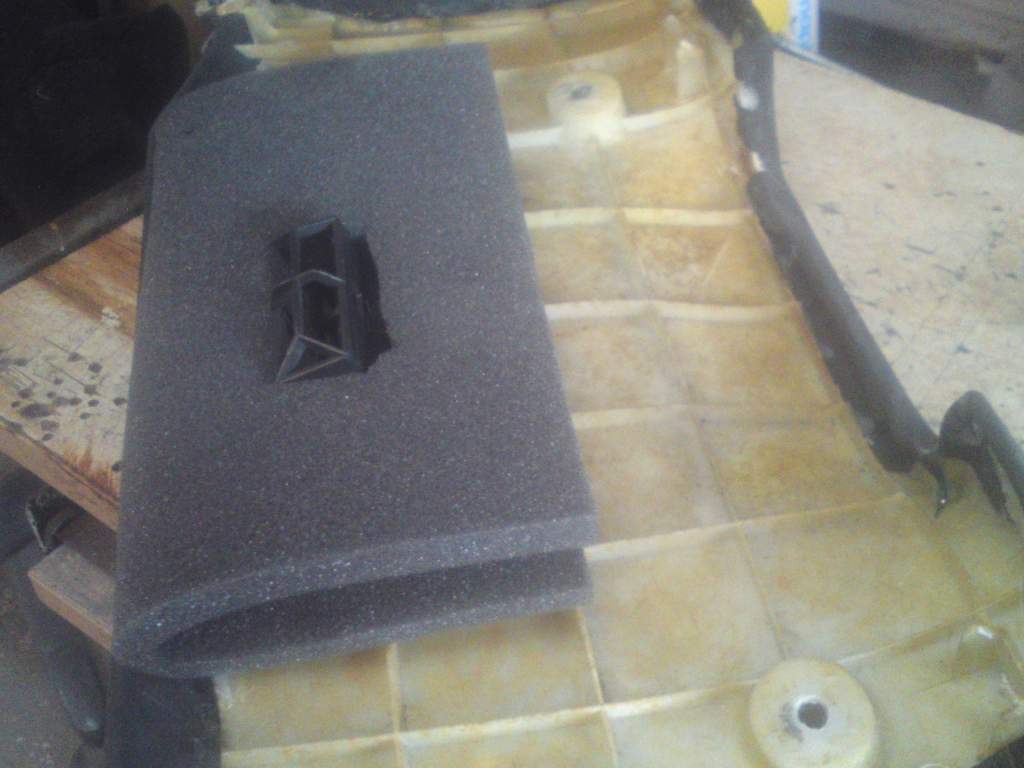

To seal mine, i had the foresight a few weeks back to save some decent foam, i did think about neoprene, opted for the foam and a simple fold over with a cut out, works a treat, next time the trim comes out i could tidy, cut down and secure but really there's not much need.
