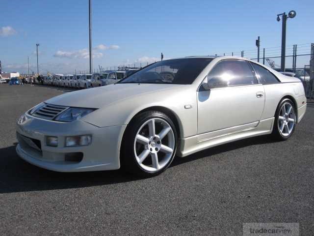

Mines an import!
Here it is in UK!

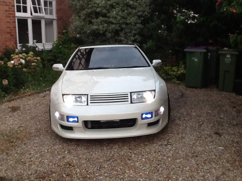

And a here & now photo
No mention of rust on my MOT inspection!

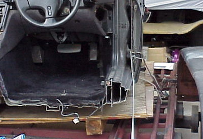

When you are using cavity wax in the sill sections (I used Dinitrol aerosol cavity wax with 60cm lance) it helps to know
where you are trying to get to with the product. This photo shows the complex sill structure in cross section. You can get
at the various sections from inside the car, the plastic door sill plate fixings and the hole at the front of the sill located
behind each front plastic wheel arch liner.

You have all the best reference material! Great pic!
When you pull back the carpet from the inner sill you'll see tape over circular holes in the inner sill metal. Remove the tape to open up the holes and put the probe in there. You have to finesse it about in order to get through as many of the steel sections as possible. The holes go right through to the outer sill but they're staggered so it's not straightforward.
Time consuming and as Si says very messy but a great investment.
