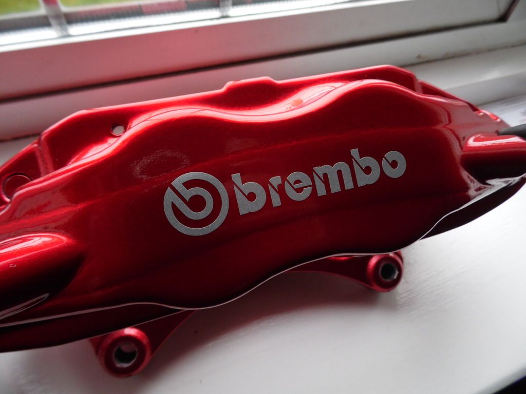

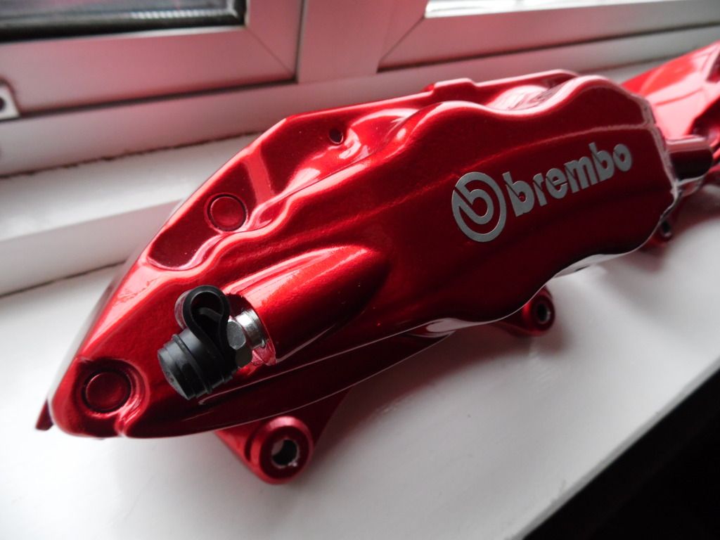

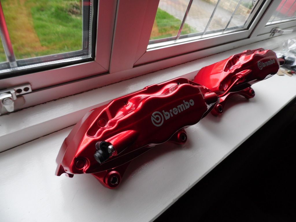

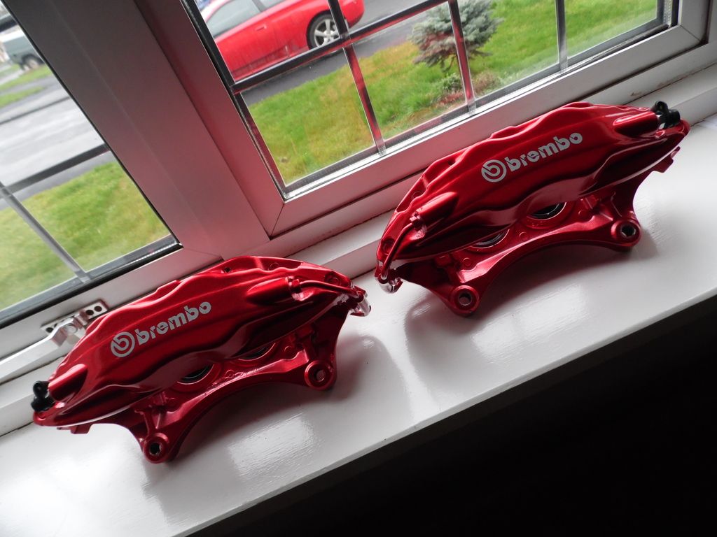

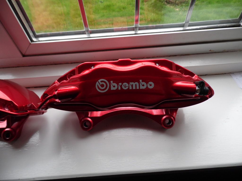

I feel like we've been here before... nevertheless, here (at long last!) are my second set of Brembo calipers back from the paintshop:
These are from an Evo 8 and, with the help of a pair of adaptor brackets, I'll be able to run a pair of 350mm discs up front. :)
The pistons are absolutely fine so I'll be reusing them. All new seals are ready to fit and they now have new stainless bleed valves.
I'm honestly hoping that this will be the last upgrade to the front brakes... :innocent:

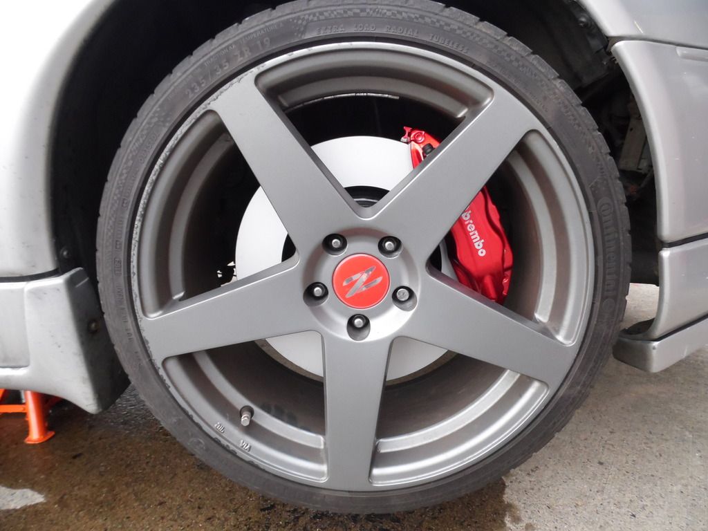

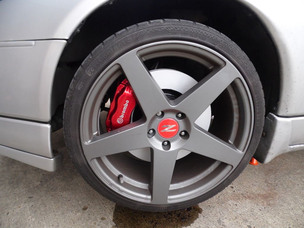

Partway through fitting, it turns out that I have to cut a sizeable chunk of metal off the hub - just above the upper mounting lug - so the adaptor brackets will fit.
Then it turns out that the fitting on my current brake lines isn't deep enough for the Evo calipers! So whilst I can screw it in, it doesn't seal... so my car is currently on axle stands at work and I need to spend yet more money...!! :(
But here's what things look like fitted anyway. If nothing else, the brakes no longer look completely lost within the wheels...
What a day.....
Should be Andrew yeah.
I seem to recall this lump thing being removed off the hub in my mind, but it recall it being like a thimble. Slitting disc and a heartbeat later it was gone.
Is that brake fluid all over the floor Simon [emoji848]
Of course it is.
Is it not a banjo fitting on that caliper type?
It can be either. For example, the 350Z lines I bought to fit the previous Brembos had a 90 degree "standard" fitting - it's this fitting that's too short for these calipers. So I need to buy a pair of Evo lines or get a custom pair made up.
Yeah, it wasn't a huge amount of metal but it still came as a shock that I needed to whip it off! :blink:
I must say, they look really well, if not a little lost behind those 19's:whistling:
:innocent:Just saying like:innocent:
Could you not get bigger:whistling: :lol::lol::laugh::thumbup:
Club member no. 779:thumbup1:
If you are getting lines made up then banjos would be my choice.
Evo lines are a banjo fitting as standard so, whether I get a pair of those or get a pair made up, that'll be the fitting :)

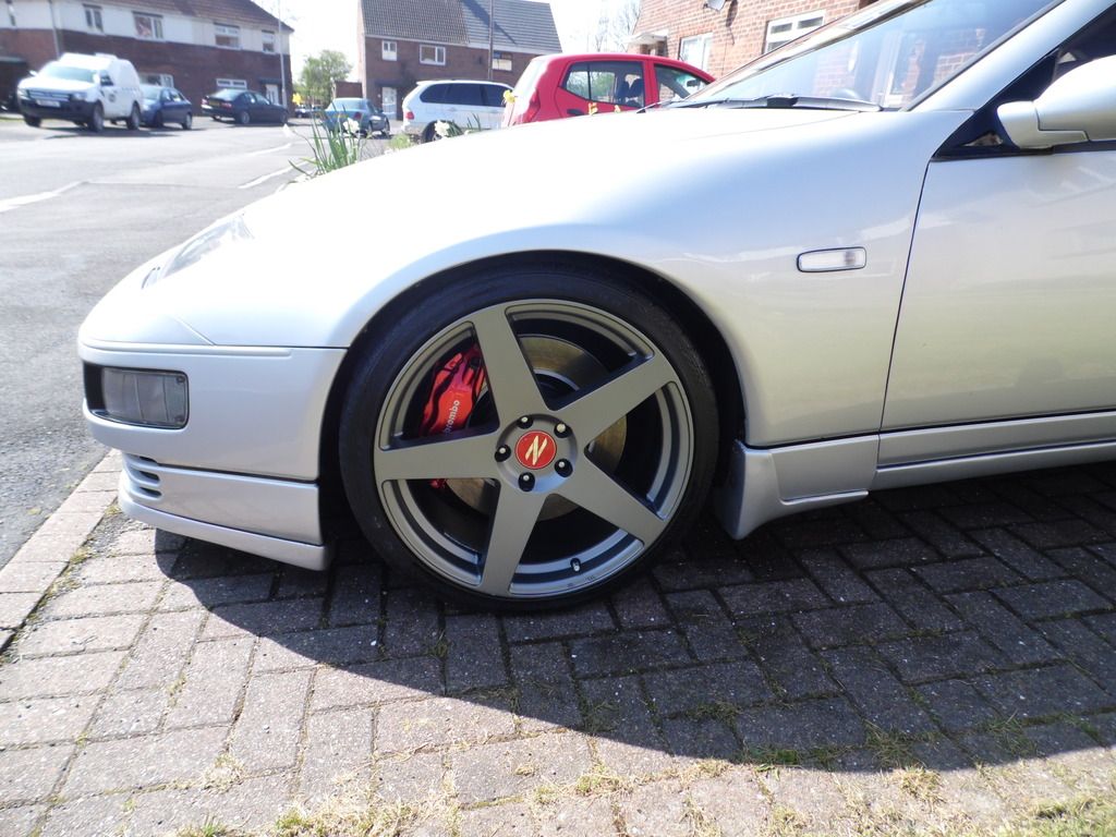

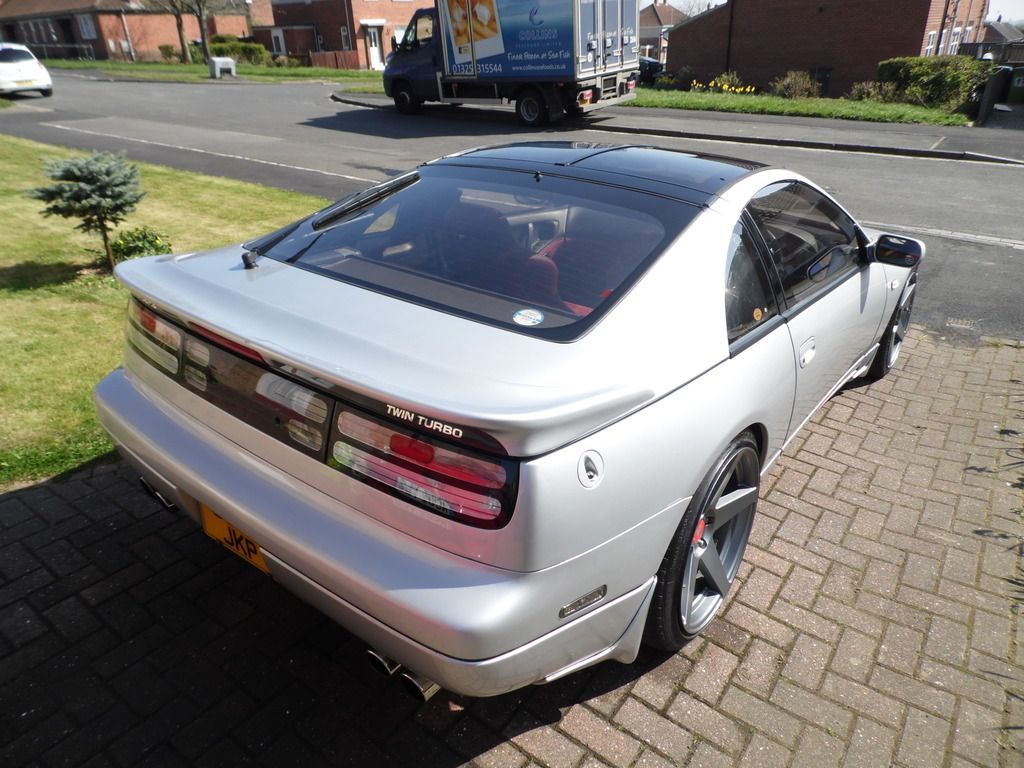

Got a small local show tomorrow so I thought I'd better give the old girl a bit of love:
And especially for people like Richie, here's what the new front brakes look like now the wheels are back on the floor:
The weather forecast suggests it's going to be really nice tomorrow and, as luck might have it, the show is literally round the corner from my workshop so I might have to indulge in a spot of networking :detective:
It's nice to see her looking all clean and shiny again, I must say. Now I just need to lay my hands on my Autosol for the exhaust......
Looking good buddy:thumbup1:

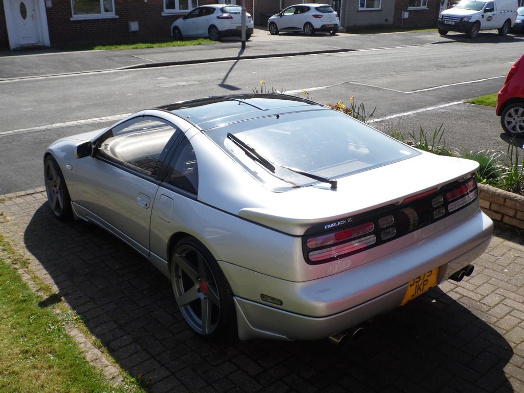

I've made a (forced) decision now: seeing as even Mike Feeney can't source me a Kaminari rear spoiler and everywhere else involves ludicrous amounts of shipping, I'm just going to keep the Car.Mad one I've currently got and be done with it.
I've just bought a spare dashboard and also been donated a full set of S1 interior panels so I'll be slowly swapping all the plastics over for newly-trimmed ones, once I've actually done the work of course!
Pretty boring update, really... :lol:
I think that's a good omen personally. Your current wing looks better than the Kaminari wing.
