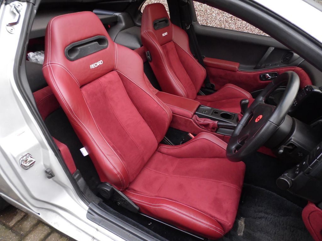

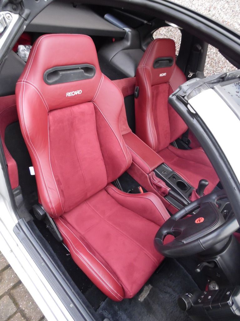

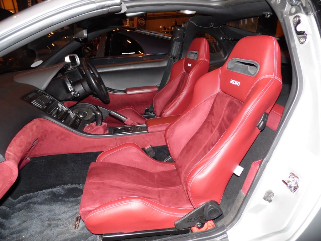

As I've said in the past, last year's retrim was a bit of a rush job and I was never entirely happy with it. I always felt the seats especially could look better and more eye-catching.
Version 2.0, however, I'm very happy with so far! I'll be even happier once I get the doorcards and rear sections done in the new design :thumbup1:
Both seats finished and refitted :)

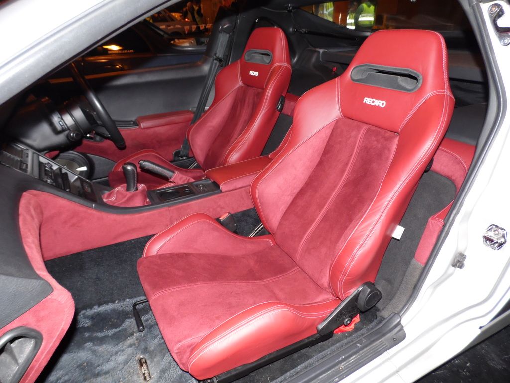

The rear and central trims are now, well, trimmed! :lol:
I'll get them refitted in the morning and then it's cleaning time, before she heads off to have her new anchors fitted :thumbup1:

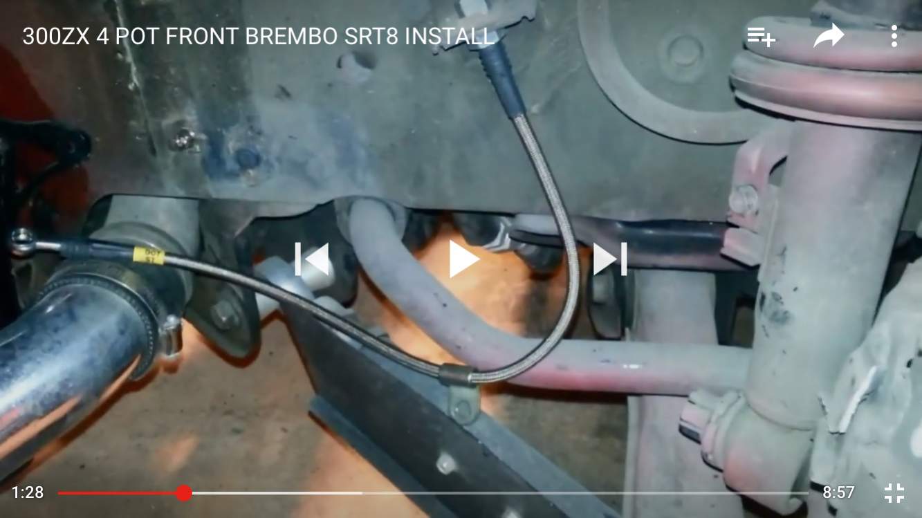

Mixed fortunes this afternoon for me. I'd been advised that the standard end of the Z32 brake line is compatible with the Brembo calipers so I headed over to Middlesbrough this afternoon to get everything fitted.
The first thing I found out is that my current front discs are indeed 345mm in diameter, so I'm going to lose some girth with the replacements...
Then we found out that the standard brake line isn't compatible with the Brembo caliper! So my journey was wasted and I'm still running my "old" front brake setup. :(
So I'm trying to fathom out how to attach these damn things now. I can buy a pair of Z33 flexi lines that will attach to the caliper without issue. But I don't know if they'll be the correct length to replace the Z32 flexi and the small hard line that runs from the flexi to the caliper.
A bit stuck!! Any help or advice would be greatly appreciated. How have people who've used the Skyline Brembos got around the brake line issue? Or do those Brembos utilise the stock lines...?
Aside from that, I'm pretty much set for my journey to Birmingham tomorrow morning. The carpet could do with a hoover - hopefully I'll be able to do that at the services.
So yeah... that's me done for a few days... :)
My Evo brembos use stock fitment lines. A banjo style fitting. I brought a full set of braided lines from Driftworks.
Do your braided lines replace the Z32 flexi and the hard line that runs from it to the caliper?
Yeah. All the way from the hard line and retainer on the body to the caliper.
IMG_4552.jpg line runs straight into caliper
Club member no. 779:thumbup1:
When I had R33 calipers fitted I used the OEM hard lines and stainless brake lines shown below. The R33 calipers I had
were not machined to accept banjo fittings. It is possible that they might form a good seal but not in my case.
Pretty sure those are the exact flexi lines I bought from you, Andrew.
Looks like I need to replace the existing flexi and the hard line that runs between that and the caliper then. That's (hopefully) sorted that then.
Thanks, guys :biggrin:
