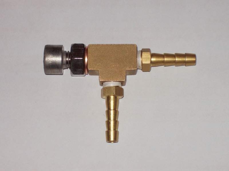

What do these manual boost controller valves that Noz sells looks like?
regular brass T piece body with an 8mm hex head bolt to preload the ball and spring....the great part of Noels kit is that its not just a bleed valve that delays the boost signal but actually has a spring loaded ball bearing that does not come off its seat untill the pre-set boost is acheived. Great bit of kit.
Also featuring a bespoke spring with a high spring constant giving a large adjustment range (I run up to 2 bar on my Pulsar) and minimal spiking, plus a lightweight delrin ball bearing :D

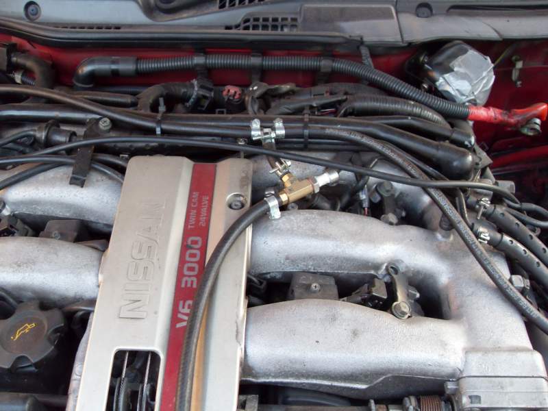

Remove the actuator lines from the intercooler pipework and route them both to the bulkhead. There should be about 6" between the open ends. You'll need some vac hose (5mm), 2 joiners and a tee (both 6mm or 1/4") for the actuator side. I usually come off the balance bar where the stock boost gauge is attached for the pressure reference and the MBC situated nearby. This keeps all vac lines as short as possible.
^^ Slightly different brass body now than that pic and with PTFE tape on the adjusting bolt.

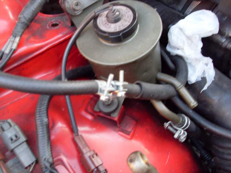

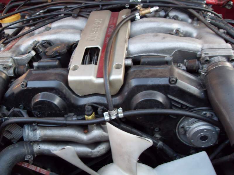

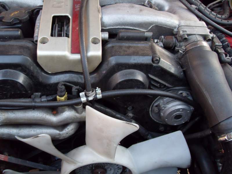

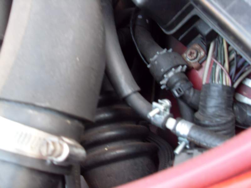

here is how I did mine there is a neater way to do this job but mine was just set up for function not looks as it was just temp anyhow as the engine is going out for rebuild if you look at the pics you get a idea of how it work SDC12452.jpg
Would you happen to have any pics handy mate, I'm not sure where the stock boost gauge attaches at the balance bar?
Top left of the engine bay (driver's side). There is a black rectangular box with a vac hose going to the underside of it :)
