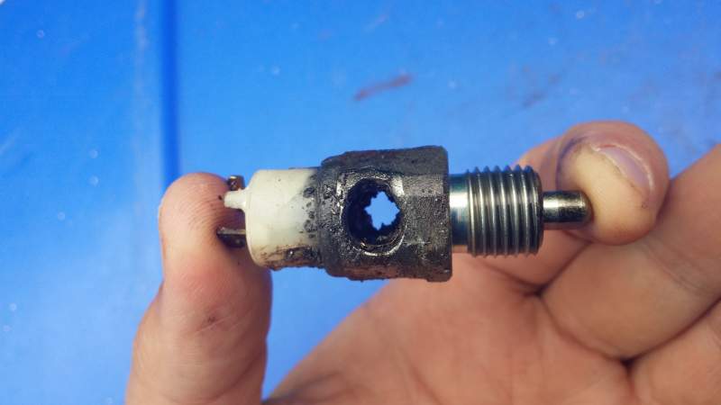

Damn Lee you didnt need to take the gearbox off to get to the sensors, just drop it down slightly lol, good practice for you though :thumbup:
Had too unfortunately as one of them is broke and wont come off.
I'll likely need to take a drill to it and try push a small bar through it to spin it off.

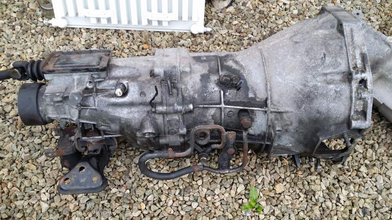

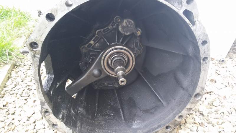

mine looked like this replace the input shaft seal deffo i have mine hear ready for when the box next comes out
Going to replace all the seals while I have the box out.
I'm guessing I have to drain the box of fluid before unbolting the back end ?
What's the best way to drain it when its off the zed, and will giving the whole thing a power wash do it any harm ?
Drain it out of the bottom drain hole or if you only have the side entry, tip the box on its side to empty, you can jet wash the box, but make sure the sensor holes and breather pipe are bunged/sealed as you dont want water in the internals, then give it a coat of silver enamel paint like i did with mine ( remember) looked like it was silver plated :thumbup:
oil level is below the seals Lee...unless you want to change the oil at the same time.

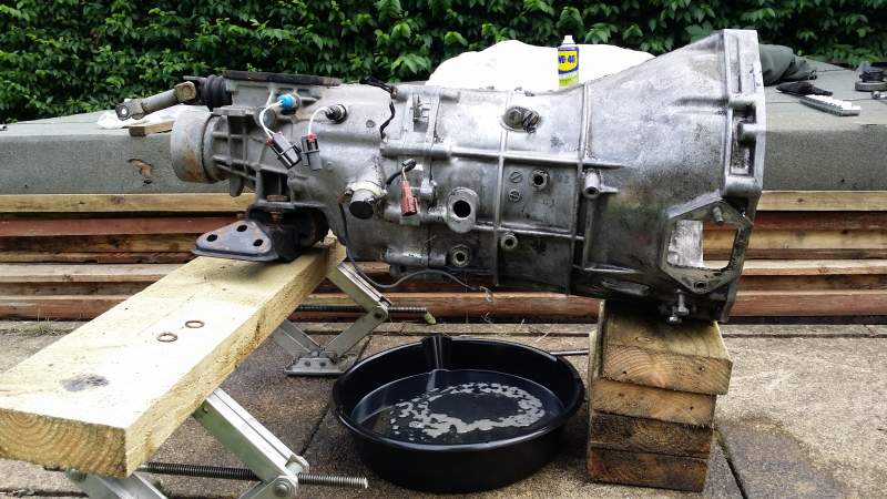

Working on the gearbox today and I've managed to give it a good cleanup.
I started of with giving the full thing a rinse down with a high pressure hose then I went onto
degrease the full thing with engine degreaser.
A few rinses later and a good scrub managed to clear 80% of the old crud that was sticking to the box.
Also made up a make shift stance with some wood and two scissor jacks

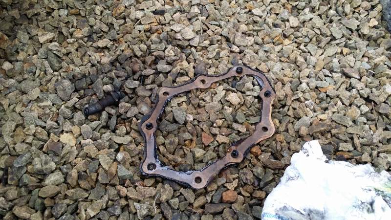

After I drained all the oil from the box I removed the inner bell housing cover and found
the issue that was giving me the leak - a home made gasket !
Although it looks fairly real I believe its just been stencilled out of another one.

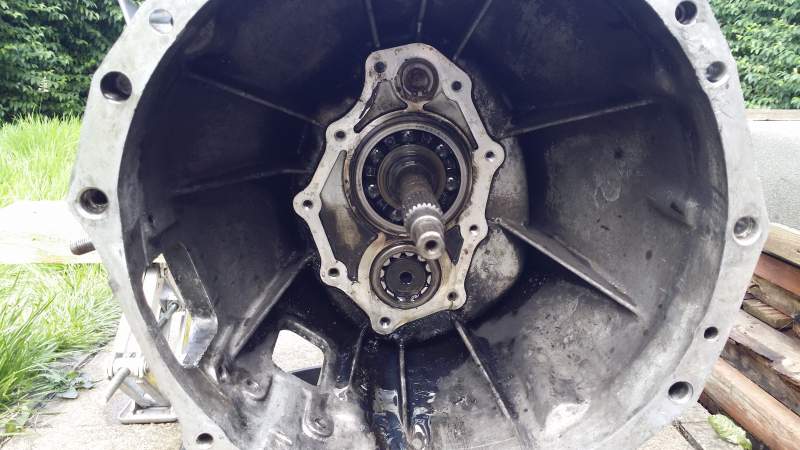

More engine degreasing I carefully cleaned up the inside of the bell housing and fitted the new gasket

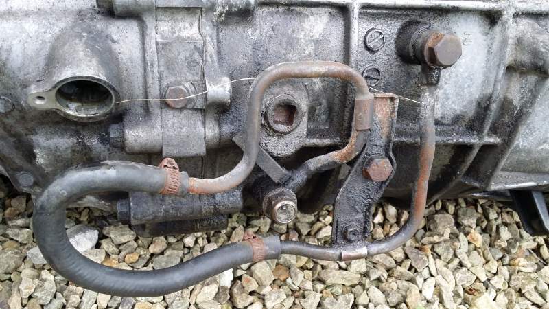

I also replaced both oil seals and also the pivot ball and springs.
Box back up right I also removed the old rubber oil lines which I intend to just block up now.
[ATTACH=CONFIG]91065[/ATTACH]
when you say both oil seal do you mean the input shaft seal and out shaft seal? or was there 2 to change behind the inner bell housing ?
There is a seal at both ends which isn't pictured.
One is on the plate that you remove in the bell housing and the other is at the drive shaft side.
am with you now, the one on the propshaft side what did you need to do to remove it ?

Not painting the box though?
