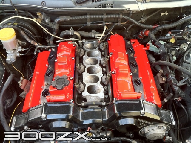

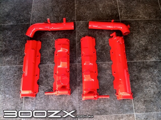

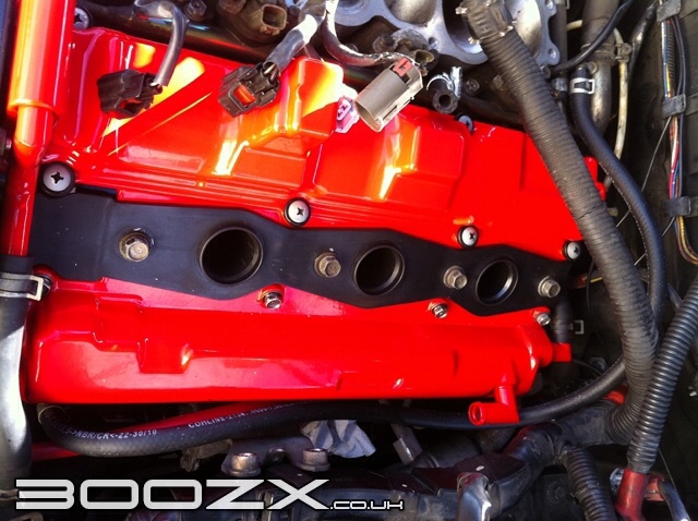

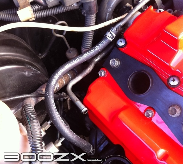

Powder coated mine and never had any issues
[ATTACH=CONFIG]78267[/ATTACH]
[ATTACH=CONFIG]78268[/ATTACH]
[ATTACH=CONFIG]78269[/ATTACH]
[ATTACH=CONFIG]78270[/ATTACH]
Didn't the heat from the oven melt the plastic parts inside the rocker covers bud??
the plastic bits seem like the can handle the heat,
just make sure no grit gets in there...
Just seen a set powder coated and the plastic bits are fine...
Cheers for the input guys :)
Mine were fine mate as terry said the plastic bits are like a bakerlite material handles the heat well
