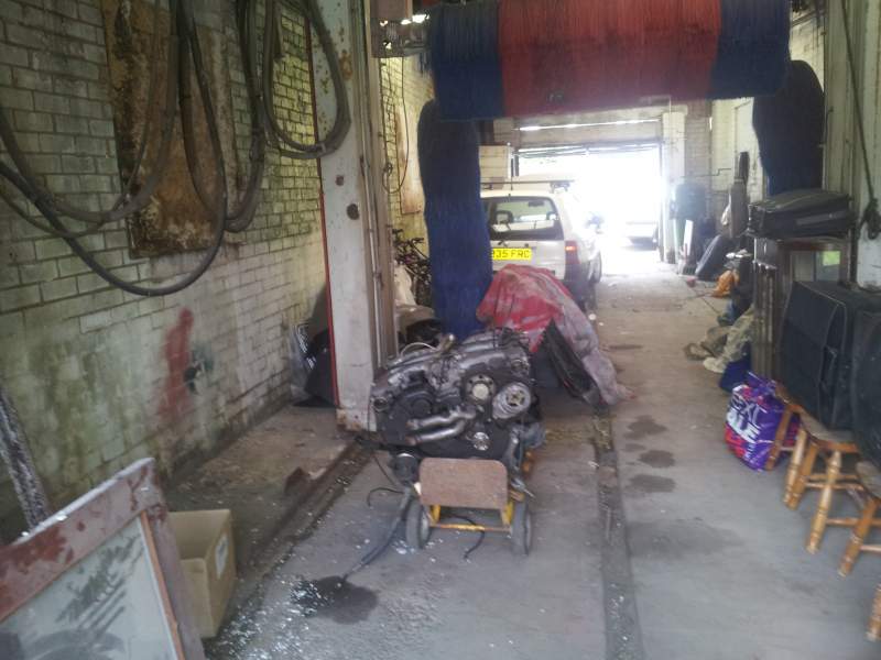

Re the rusty engine pulley, this sounds like I have stored the engine somwhere it can get wet, and therefore contributed to the problems. This is not the case, it was stored within an old car wash behind a local garage (friend of my dads) , where I also garage my car during the winter as I don't have a garage at home
I got some pics today to show where the engine was stored (and my spare one is now) just to dispell the opinion it was badly stored and got wet
