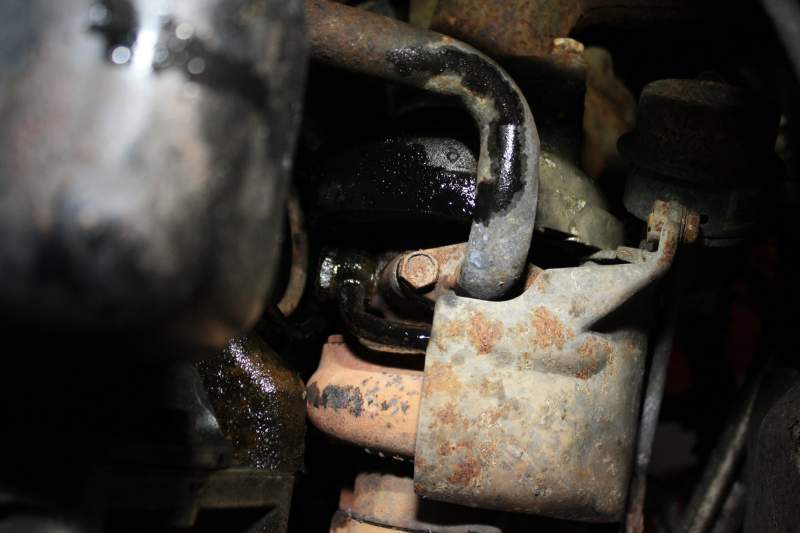

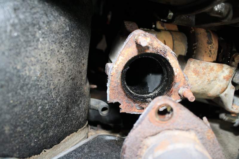

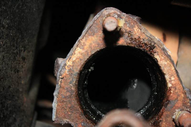

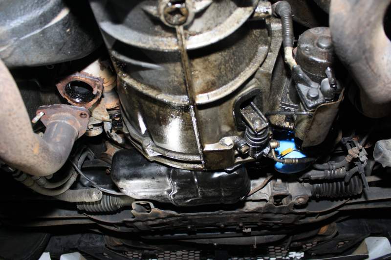

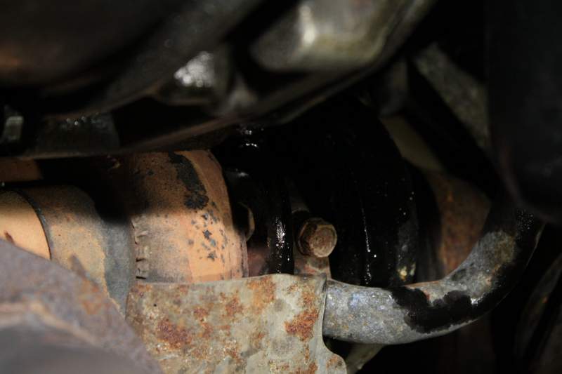

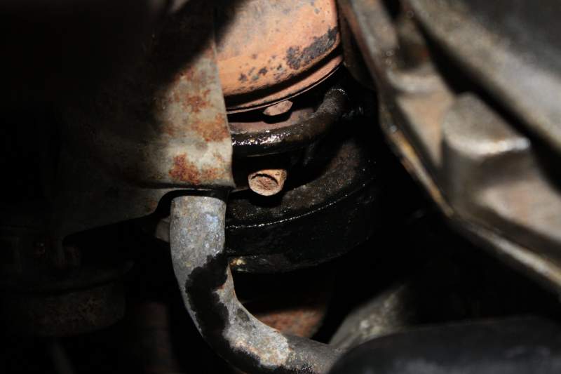

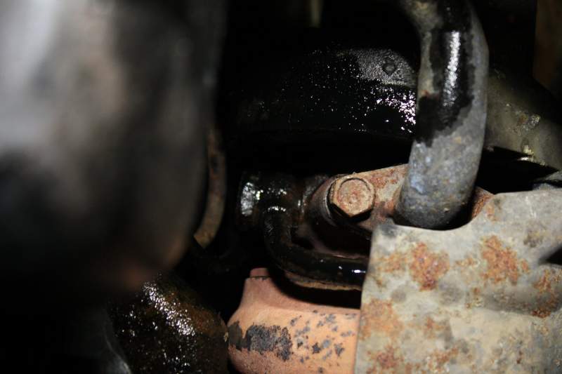

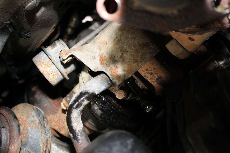

Well I am not sure if this is the only problem I have (unless someone can explain how this would cause so much oil to get into the nearside cylinder bank)
However I would have to say the nearside turbo is 'not a happy bunny' even though i am not a mechanic
Also there seems to be rather a lot of oil under the car in general, on oil feed pipe to turbo, gearbox housing etc
He didnt' drop the other side pipe (even though I asked) and says it is all dry around there
Also one of the pins is broken off the turbo elbow and there is a nut and bolt in it's place. The elbows are not on my old engine where I got it back - I don't know if this one is off the new engine or old but the garage mechaic said it's 'not very clever'
So here is some pics (two sets)
Rich
Set 1
Second set
Would the turbo problem also explain all the oil esp in cylinder 6 and on the plugs, and the cylinder drop-out ?.
This turbo is the same side that is smoking bad

ok you most defo have 2 problems m8
Cam cover is Leaking directly on to the tub and in to the plug hole ... Very Common
and the tub its self the seals are shot ..
oil around the gearbox is over spray from the oil leak its self
