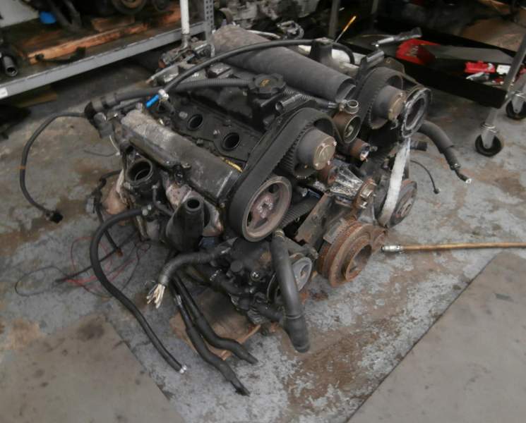

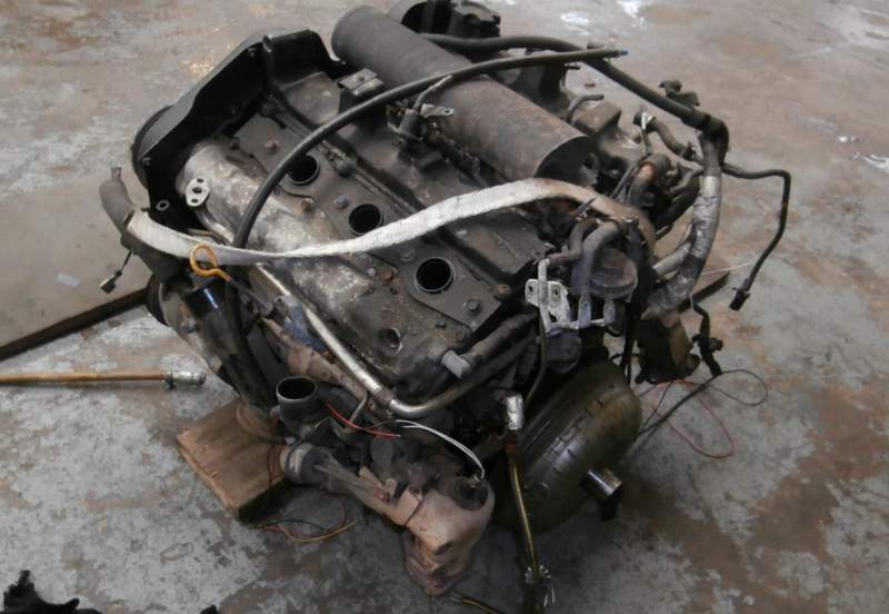

PS once again this is where the engine was stored before fitting (for about 3 months) - on this same trolley and with the doors shut of course. I also garage my car here over winter without the engine rusting
Edited by dicky96
Is that the same engine or the one removed from your car?
Edit: Never mind, it's a different engine.
Edited by Noz
Exactly - that is my old engine.... actually though I will pop up to the garage and take some more photos of it now, to see how it has faired these last few months in the same location and on the same trolley I stored the one you sold me for three months
