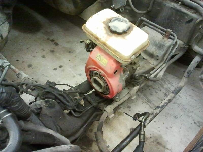

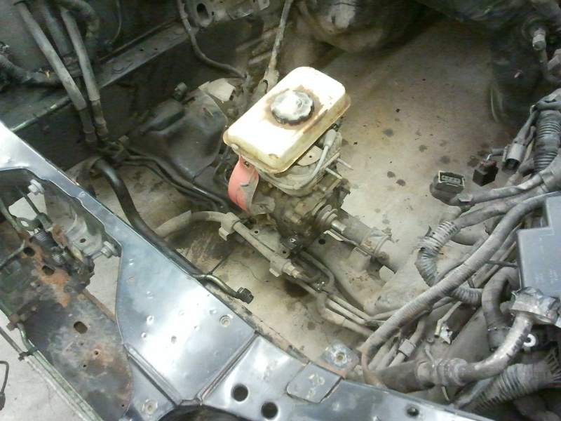

Dicky has sent me a pic of his engine so ile pass it on
The deletes really free up the engine bay and make it so much easier to work on.
Did someone say mikey supplied it............ROFL
yea and took three days to fit it:w00t:
