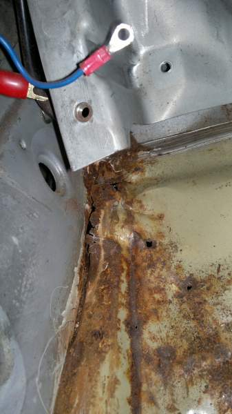

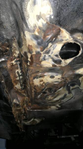

I got underneath the car to do some sealing and rust preventative and managed to make 2 holes using the wire brush and a paintbrush covered in underseal.....
Can anyone advise me where to source section of panel I need ?
I want to cut out section and replace.......
I am trying to track down anyone I know who can weld.....
I am going to clean area up later with drill and wire brush to see how far the rot has crept......
Is this sill section or floorpan?
any idea of thickness of metal to use to make replacement section if I can't get replacement?
I even thought about aluminium mesh and JB weld for about half an hour......( I was a bit depressed when finding this so please forgive me!)......lol
I am getting more and more upset finding how many things need doing now.......

  • I think the primary concern should be to isolate the cause and rectify that. If the rust isn't too far gone you could use a rust converter, dinitrol rc900 is also good stuff and comes in an aerosol so

    I would get the carpet up, you can check the sills pretty well; through the inner sill holes with a torch. Give the outer sills a poke with a screw driver. Also lift the passenger front carpet up, w
just pop "rust" in the search field.... you are not alone with this.... 20 year or cars all have rust .... (unless they have been extremely well looked after or fixed).
outer sills are available, see the traders section ...
clean the metal up, when you see the rust ends, go another 4 inches past that for good metal.
I use 0.8mm for car bodywork stuff, its a little thicker than the OEM stuff but helps add some strength.

Not to sure I understand where those photo's refer too. Are they front left and front right? are they the jacking points?
Firstly, as ruishy1 said, you need to clean back so as to see the full extent of the rust.
On past experience you may well find more corrosion as you delve deeper I'm afraid.
The degree of repair will depend on you future aims for the car. Are you intending to patch up just to get by? or are you thinking long term?

Looks like sill area but has side skirt fitted

Well I have had her since 2000 and can't bear to part with her.... So gonna get brutal and cut out all rust found.....
The outer skin on N/S was replaced due to major side impact, looks like they left floorpan buckled and dented..... not a good repair... but no rust on outer...
Looking in hole there seems to be little rust to be seen. It appears to be the jacking points have filled with water where it has sat for 6 years without moving.....
I shall do some investigation work tomorrow and see how far the rust stretches, or how much I can see.....
Just had thought.... father in law has one of those camera in long flex stick things with monitor..... gonna borrow it and look inside the sills...... at least that way I can see extent of future problems and deal with it before hand....
If it isn't too bad I am gonna fill sill with waxoyl after it's welded.....

Just picked up camera and monitor from father in law and had a scope down the sills on the way in........ haven't got any way to record the video out from the camera at the moment.....
The N/S sill is localised to only the front jacking point with no sign of rust all the way down in either the inner or outer sill..... fed camera through hole between sills.....
The O/S sill looks like the titanic's underwater pictures from the film.... lol
The lens is so small even a tiny bit of rust looks massive..... but, the inner sill looks okay, but the outer skin is covered in rust..... no holes, just very rusty and covered by the side skirts.....
A question I have is....... Would it be possible to inject something like Kurust into the outer sill to harden the rust as a temporary measure till I can get it replaced next year?
I am thinking about using a washer jet on a long piece of clear pipe, feeding it right in and pressure feeding Kurust through pipe, rotating it and slowly withdrawing pipe......
I was thinking this may slow the rust till next year...... possibly adding waxoyl on another pass?????
Also, is it possible to buy just the jacking point section of floor pan / sill ????
As the holes are about 5cm long by 2 cm wide at most..... or is it a make your own only option?

I think the primary concern should be to isolate the cause and rectify that. If the rust isn't too far gone you could use a rust converter, dinitrol rc900 is also good stuff and comes in an aerosol so you can use their 600mm extension wand. That's what I used to inject the cavity wax throughout the whole of my sills/box sections.
i would wait until you got the time and money to repair correctly. then take the skirts of to reveal the extend of the rot but be prepaired for some root that you cant see. and if its a uk car be even more prepaired and take a seat bud, dont despair and repair. long live the 300.

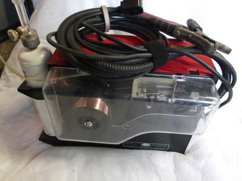

Errrrrmmmm.... then I bought a snap-on/Cebora 880 welder from someone locally..... it is mint.....$(KGrHqJHJEEFGviDgnBkBRu,vNTL3g~~60_12.jpg
guy used it once or twice and decided to get someone else to do work for him..... I picked it up for £80....
So now I need to practice for a while till I feel confident to do the work needed.....

that welder was a abrgain mate, cebora are good welders.
First off get rid of the disposable gas bottles, they last like 15 mins of your lucky, buy a proper regulator and get gas from BOC, not only do they last alot longer, but the gas is a lot better for welding.
Dont try and butt the metal together, overlap it, butting together you tend to blow holes.
Set your gasflow to about 15 litre per minute, make sure any metal is as clean as you can get it.
Now when your welding rather than trying to do one continuous bead, do it in pulses to get the stack of dimes effect like when you tig weld, do a small pulse for like 1 second, if it looks good then the next one pojt your wire at the leading edge of the one you just did and do the same thing.
Its tedious mate, but it ensures good welds with it being alot less likely to blow holes.
Again, if you were closer i would show you how to weld and help you do it, your just a little bit too far !
Bloody typical Ruishy1 being too far away...... thanks for the advice, I am gonna have a go at practicing sunday... If there is any gas in his bottle...
I will have a chat with BOC as I get my medical oxygen cylinders from them.....lol
Better not use one of them or might be a large explosion.......lol
Thanks for the advice I shall be trying to get gas bottle and regulator tomorrow, if I can't I will grab a couple of disposable till monday..... I will try the overlap and pulses...... bet I blow lots of holes though......lol
Thanks Ruishy1.....
you want it on minimum power setting with a wire feed setting about 65 percent of maximum

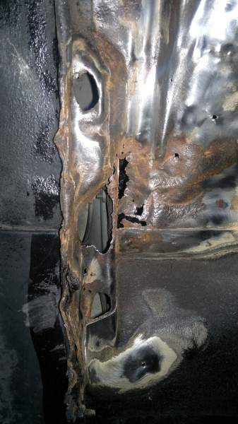

Started by wire brush on drill over front N/S floorpan and found a cover up job over accident damage...... the floorpan had been badly buckled, outer sill replaced, front seat mount replaced and all covered with filler, seam sealer and tons of underseal....
After cleaning most of the muck off I found 3 tears in the floor, 2 holes in the bottom of the sill where it meets the floorpan, the jacking point is half rusted away and the front corner where the floorpan meets the front bulkhead and sill has rotted away.....
I was thinking of cutting out the jacking point and replacing with right angle piece of metal closing the holes, separate piece for floorpan beaten to sort of match angles....
Going to get angle grinder tomorrow and cut out what needs to go and clean up what's left.....
Tried Mike for new floorpan section, he can get sill parts but not floorpan....
Looks like fabrication is the only option left....
Any thoughts?
yeah get your self a good sized ball pein hammer mate, and as your welding the sections, beat them with the ball side to shape them. the heat from the welding makes the panels more pliable

So far so good, at least you are now getting an idea of what lays ahead.
I would suggest not doing anything too hasty as yet until you know the full extent of the corrosion.
Nissan went to a lot of trouble so as to design multiple sill sections and floor pan to maximise rigidity, the last thing you want to do is compromise the structural strength.
If I was you, I would also use paint stripper so as to clearly see the transition from corrosion to good steel, that way you can be sure of cutting back to none corroded steel.
As you say, take some time to remove the trim etc', that way you will be sure of the extent of the corrosion. That way you will be able to plan the sequence of repairs. It is too easy to tack a piece in, only to realise it has to come back out so as to allow access to another area.

From your pics I'd say it your Zed doesn't look too bad, and is totally repairable, but I really would check everywhere. Even when I thought I'd finally finished finding rot, I'd find more, hence why I gave up trying to repair it, there was baely any good steel left...plus a shell turned up locally.
As for your question about using angled steel for the jacking point, I had the same idea when looking at my rear subframe mounts, but drilling holes and bolting it on, as well as welding. I never got to that stage though.
