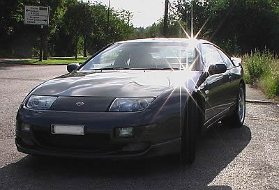

Right, Noel (Turbonoz) has had my car for the last week and has set it up properly. He's installed some colder plugs, fixed a couple of boost leaks and a small fuel leak, produced a new custom map and setup my Profec B spec II. Many thanks to him for his patience and professionalism
So, any guesses? :) Relevant spec is as follows...

Results are in - collected the car from Noel on Wednesday night and drove home to South London in the driving rain. She ran well however, much smoother than before, but I obviously didn't push her in the wet..
520.7 BHP and 505.9 lb/ft
Not far from what I was expecting, so I'm pretty pleased. More than anything I'm just glad that I can drive her with confidence again :D
