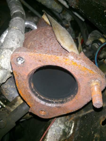

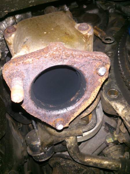

Any ideas of the best way to go about tackling these, ive tried drilling through one and using larger size drill bits to increase the hole, but the only one that managed to get through was a tiny one, the others are just going blunt (HSS cobalt Dewalt drill bits :( ). drivers side needs 1 drilling out, one stud actually undone, and one nut came off as normal, passenger side how ever, 2 snapped 1 undone as normal.
I can not for the life of me get this damn drill bit to eat the stud that's in there, so at the moment, my clutch change is on hold. i want to get these elbows sorted while the gearbox is off the car as i have more room to play with.
I have a stud extraction tool BUT, last time i used one the damn things snapped in side the stud so that left me back at square one where by i had to then drill through that and the stud (when i did my blue car) so im a bit apprehensive about trying that again.

Take the elbows off and using a thin cutting disc on an angle grinder cut a V section out where the stud is it will then come out and when re-assebling use nuts and bolts with washers either side, works every time.

I had wondered why my last lot of elbows had that V cut into them, thought they might be after market ones lol, thanks jeff. shall give it a try in getting these elbows off (lets hope none of them snap as well)
I took my studs out and re-tapped next size up thread..hook my down pipes up with nice stout bolts now
What i did is use a really thin 0.8 slitting disc u can cut right through the studs like jeff said but if you go straight through the stud should come out leaving the thread undamaged with tiny slit then u can just use a bolt with original thread..
dont try drill them with a hand drill mate..it will end in tears believe me.Need to come off and be clamped in a pillar drill..slow,hard and firm with cutting oil to keep them a round hole and not looking like a keyhole:biggrin:
Slit them like in pic, Screwfix sell 0.8 cutting disc go through it like butter lot easier then drilling.
Soon has u cut through there will be a gap in between two parts of the stud u can push one side out at a time, then put a bolt in cause rest of thread will be fine.
If u use thin slitting disc dont move grinder left or right cause they will shatter and try use some goggles..

I used a 800w corded drill, i started off slow and steady with the small drill bit, that ate through it and left me a nice guide hole, i then upped it to the next size, i started on that, on slow, but wasnt doing anything, so upped the speed to half, then full, by that point the bit had gone blunt and was glowing red hot, so got fecked off and lit me fag with it and took a break lol

Cobalt bits need to be run at a slower speed vods, what size bit do you need?
all done now mate, used an angle grinder and cut V shapes in, and carried on till i cut the stud in half, couple of whacks with a mallet and they fell out.
