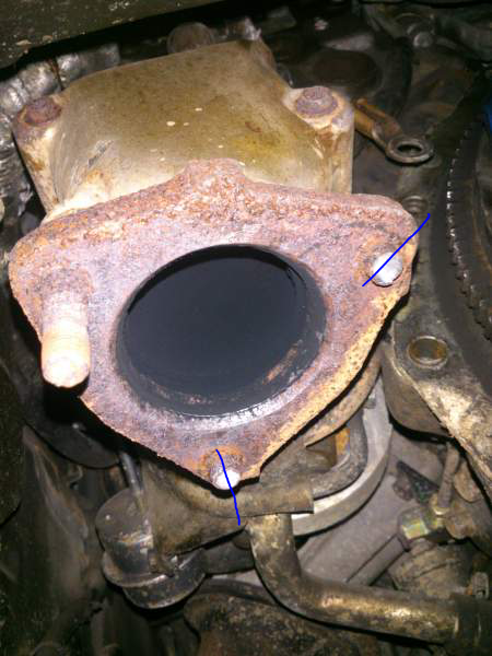

On the original elbows its studs screwed into them with thread to use a nut on to hold the exhaust in place as per this image.

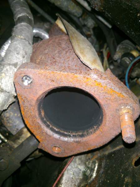

as you can see, due to age, heat and just being a stupid design, the studs thread had rusted to the point where undoing the nut, snapped the stud (as per the image above)
To get the stud out, i had to cut a V section into the elbow and then cut through the stud, i then hammered the two halves of the remaining stud together to get them to fall out.
For the replacement exhaust, ive use Nuts bolts and washers to secure the down pipe to the elbow, a much better design as if i need to remove the exhaust at a later date and the bolt snaps i just replace the bolt, rather than having to drill out snapped studs and add V shapes to the elbows.

Just slit it like this right through flange and stud the 2halfs of the stud will fall out leaving a threaded hole with a small slit in the flange on one side.
New nuts, bolts and washers,
And your away lol..

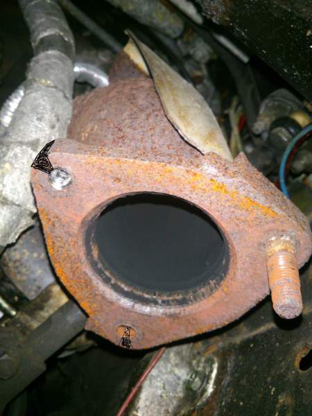

the above image is my actually elbows ive just sorted out.
with the power of paint invested in me, basically cut out the black painted on parts in the below image with a angle grinder.

Thats much better then my drawing lol, I did do mine on my phone.
Don't say u did too, cause I'll look even more crap at drawing
MS paint, awesome tool lol
