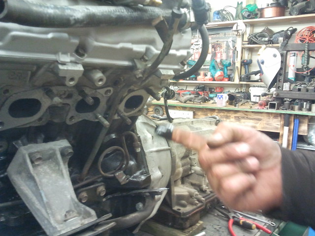

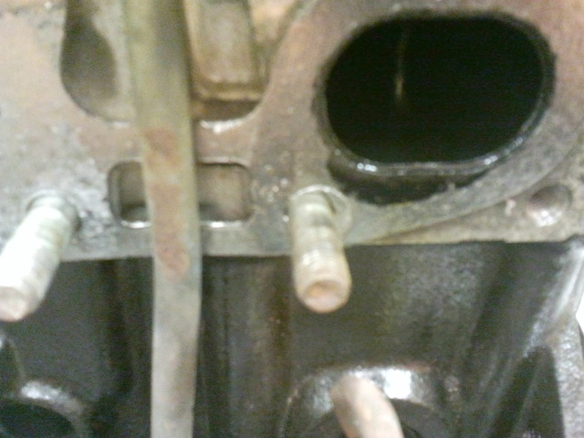

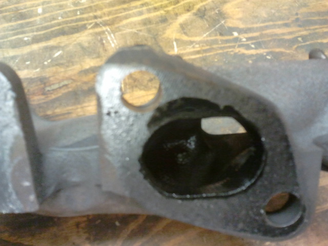

well it looks like the machine shop that skimmed my heads never put the new valve seals in i asked them and paid for...number 6 exhaust port is full of oil and running into the manifold...also checked behind all the other valves from the back of the heads and theres oil on top of the valves.WTF:mad::mad: load the pics later

They may not have fitted them properly, so the stem seals popped out of place. Troubld is there so hidden in thhe head, not like an old ford pinto sohc or crossflow :( feel for you bud. Is it only on the number 6 exhaust valve? Both, one or more?

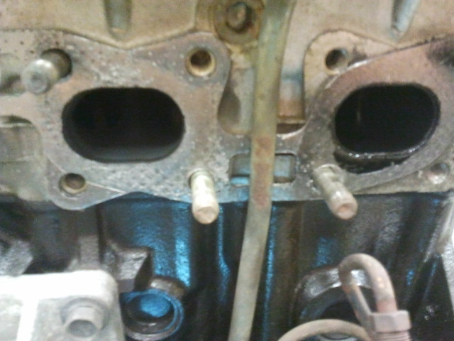

number 6 exhaust is drenched but looking behind the valves from the lower plenum and all the rest have oil behind the valves..some worse than others.
Great, thinking about it, if was a case of old ones the block would have smoked like a pig, so its probably a case of improper fitting.
never buy a gasket set from ebay....the lower plenum gasket on both sides had allowed oil to get past the head oil passage and was being ingested by the ajoining inlet ports. The gasket is only 200 miles old and touqed down to correct spec but the rubber inserts in the steel was as hard as the steel:confused1: anyway gave me a chance to get my tubs checked and upgraded seals so not all bad,the show goes on as always:biggrin:
So valve stems were good? The gasket kit was at fault?
valve seals good...tubs good...lower plenum gasket shite and this part has made me have to take the motor out,remove the heads to check valve seals ect but on the goodside its gave me an excuse to get the tubs rebuilt
