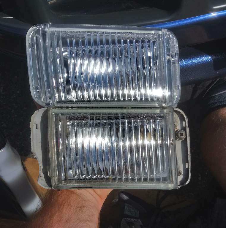

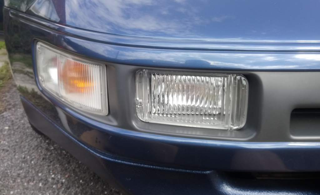

Swapped my fog lights for some brand new ones

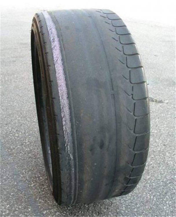

Sunday, gave the Zed a nice wash and wipe over with Auto finesse Glisten. Today I visited Just Tyres for a pair of 265/35/18s as, whilst washing it, I discovered the rears had breached the tread-wear bars :oops:
Great service from those guys - as usual - and got plenty of nice comments whilst it was there.... Now I am ready for a little planned road trip on Saturday...:cool:

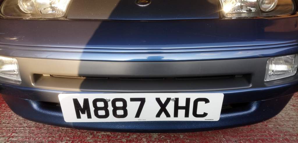

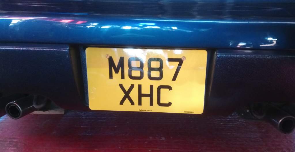

Fitted new number plates front and rear to the vert.
The front was looking tatty and the rear has always anoyed me as it was the wong size
Painted the front blate bracket whilst i was at it
Broke the plastic bolts taking them out, so bought some new ones from halfords which were supposedly m6, but they were more like m6.5. Managed to retap the rear ones to m6, but ended up stripping the white ones so used metal bolts on the front plate

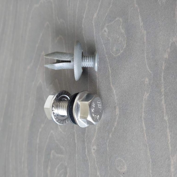

I'm changing the upper component to the lower components - can anyone guess where it's from and why? #mostboringpostthisyear
I'll play - Rear Bumper Fasteners.
Haha! Yes! I've been chasing a tinny rattle from the back of the car for what seems like an eternity. I've gone full-retard on rear sound insulation which made a dramatic improvement, but that tinny rattle was still there over slightly rough terrain and low speeds. The rest of the car is pretty much squeak and rattle-free so it really annoyed me.
I was up underneath the car last weekend and noticed that the long tabs on the bumper mounts which were secured by nearly-new OEM fasteners would move up and down ever so slightly, but enough to cause the tinny rattle as they're secured to the aluminium crash bar (yes, the new fasteners are silver plated mild steel as SS would have caused a galvanic reaction). The plastic rivets just can't seem to grip enough, so a nut and bolt job it was and it's gotten rid of that rattle!
So, if anyone gets a rattle from the rear of their car which they struggle to locate, have a look under the rear of your car to see whether there's movement between rivet and crash bar.
