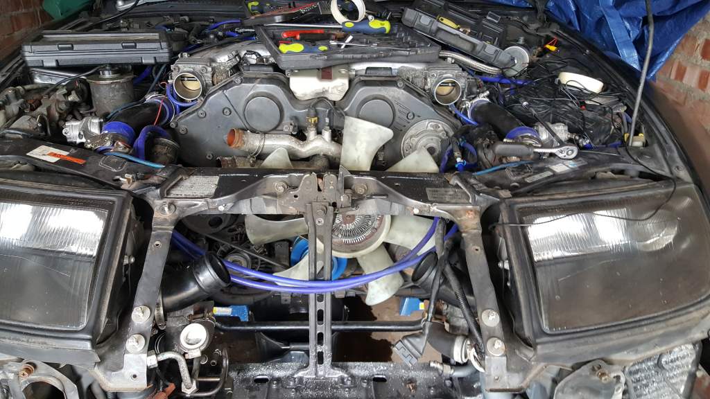

Well made a start with the engine pull, bit like the road to mordor its a long way to go ....... :scooter:
It’s not that bad tbh. First pull is always the worst, label and photograph everything. It’s only nuts and bolts once the loom and intercooler piping is out the way it’s pretty clear where to go.

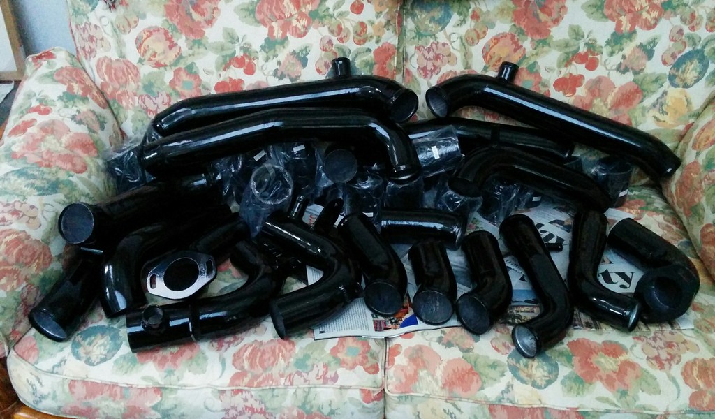

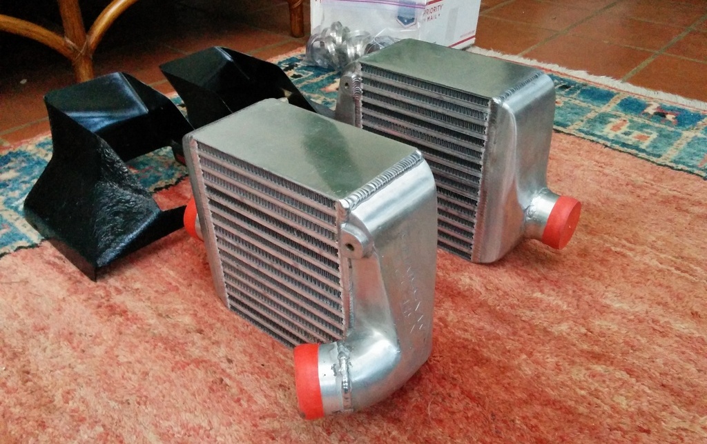

Collected a large and surprisingly heavy box from Parcelforce today together with a rather substantial payment to HMRC.
Contents include AshSpec Massive SMICs which as their name suggests are indeed MASSIVE! together with AshSpec 2.5"
IC and planar kits together with associated bits and pieces. I'll post up pics when I've worked out which pipe goes with
which but in the meantime there are a lot of them as you can see! Compared to the stock pipework this stuff looks MUCH
larger. I've pretty much got everthing now for the "bolt on" engine upgrade for Jimmer to put together before the full
bodywork respray later in the year.
[ATTACH=CONFIG]111860[/ATTACH]
Is that center bar between the headlights a stock part? :confused:
The vertical one? If so yeah. It’s behind the sub fan. The horizontal is the anti roll bar.

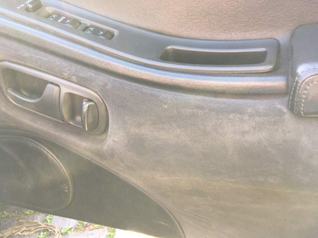

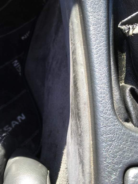

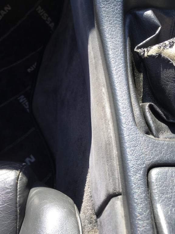

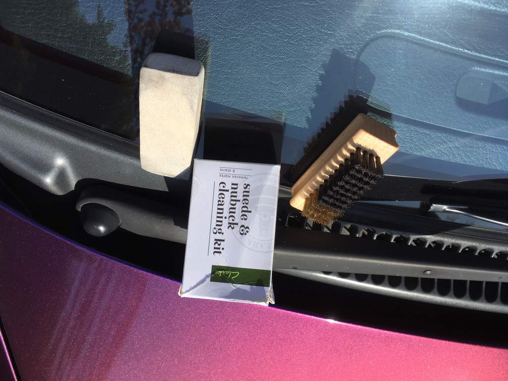

I had a great result today doing a mornings work on the interior. First job was to see if I could rejuvenate the alcantara interior. It had gone so flat in places it had started to look like black plastic. First thing I tried was a stiff shoe brush and although this was making what already looked ok better it wasn’t really having an effect on the flat areas. Then I remembered an old cleaning kit I brought from Clark’s to clean my Timberlands (go on, take the piss if you must. Long live the ‘90s!). The kit comes with a small wire brush, stiff brush and a, what looks like, compressed sand “rubber”. Using the rubber in small circular rubs the alcantara pluped right up. Then with a sweep with the stiff brush it all came together nicely. Don’t get me wrong it’s not perfect BUT it is so much nicer than it was.
Product...
Doesn’t really show how bad it was but, before...
After...
This section was the worst but, as I wasn’t expecting great results, I didn’t take a before picture. But here’s the after...

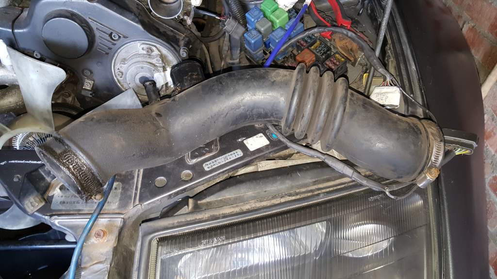

omg an hour of my life take of 1 pipe :cursing:
[ATTACH=CONFIG]111931[/ATTACH]
Lol, off is the easy way, try getting it back on again! :lol:
don't say that :crying:
Just hope the pipes that connect on the top don't split, I went through 3 pipes because they kept splitting. And they have weird restrictor things in them so not easy to replace.

Exciting!! What’s in the box?
No better way to eat breakfast! Go on you know you want to. [emoji12]
Now that is a thing of beauty! Thanks Ash!
They aren’t that bad just require a knack. Front end first then push forward and pop in the rear. Done forethought about Jose clamp placement and you can do them up with a ratchet and an extension bar nice and easy.
As for the pipe that joins them to thexam cover, that’s part of the PCV system and I’d highly recommend you replaced these with a nice new supple silicon kit. In fact I’d highly recommend to replace all the hoses, most like the little ones down the back can be purchased by the meter and cost very little.
