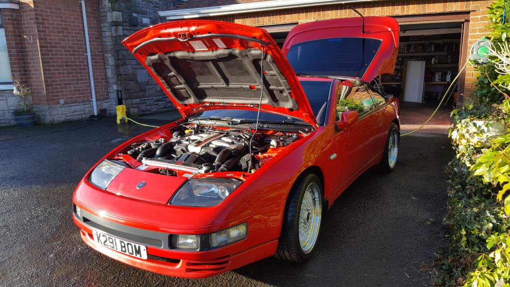

Today I washed mine for the first time since ownership.
Noticed lots of little print chips and blemishes along with my bonnet and spoiler being a complete different colour to the rest of the car. Worst of all though the spoiler has some slight bubbling starting to appear if you look closely.

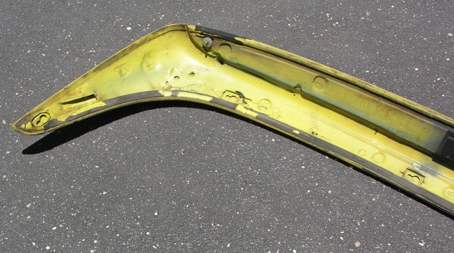

The '89 OEM spoilers are made up of a sheet metal frame over which a dense foam is formed to create the shape. A thin plastic skin is then
applied to the exterior (top and sides) surface to create a smooth pliable surface to paint.
Typically water gets into the foam through poorly sealed edges and then into openings in the metal frame which are used by the plastic clips
to fix the spoiler to the tailgate. The frame rusts and in doing so allow more water to ingress. The bubbles you see are droplets of water that
are trapped between the foam and the outer skin. If you stick a pin in them water will come out rather like a blister on human skin. The foam
behind the bubbles degrades and becomes powdery. The proper recourse is to replace the spoiler.
The photo below show the underside of a spoiler and you can see the openings were the problem starts.

Blow dry I hope Gary? Oh and I hope the paint wasn’t in direct sunlight during the wash procedure? [emoji28]
There was some winter sun and towled dry. I have a large fan in the garage to help me dry it but as I said to Funkysi yesterday I need a proper dryer.

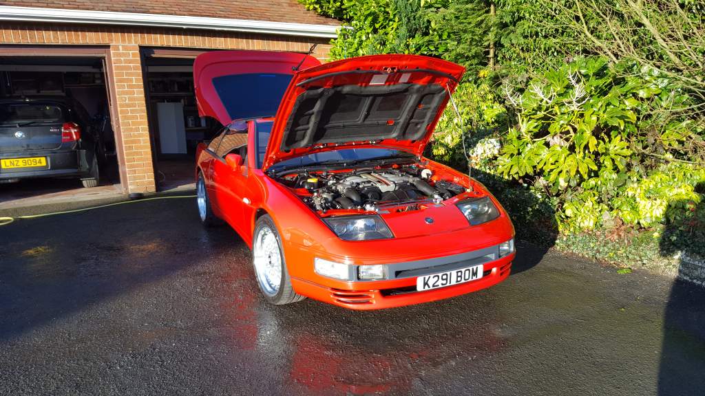

Bit of an odd question but the grey strip on the front of the bumper, is that standard or was a full painted front bumper optional?
Standard
