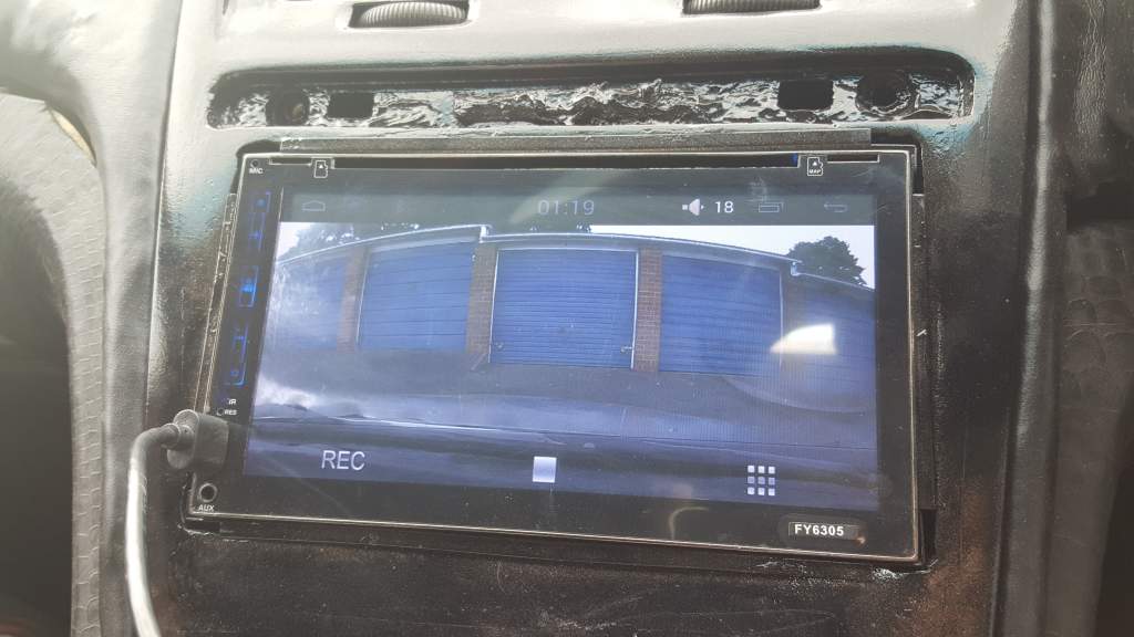

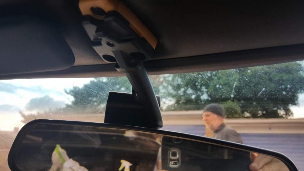

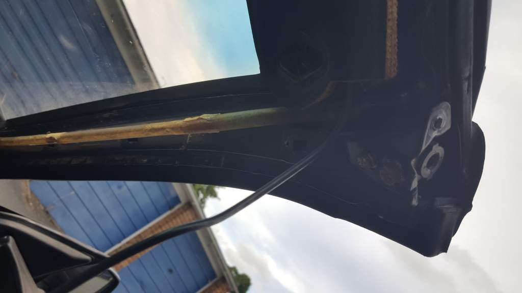

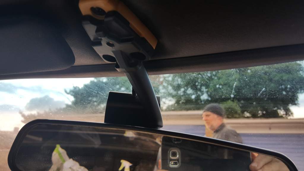

took a brake from the oily stuff today and hid the turbo timer and an alarm window controller box, and also installed my DVR camera its USB so plugs straight into my android head unit, bit of of pain taking the roof lining of and A pillar to feed the cable through

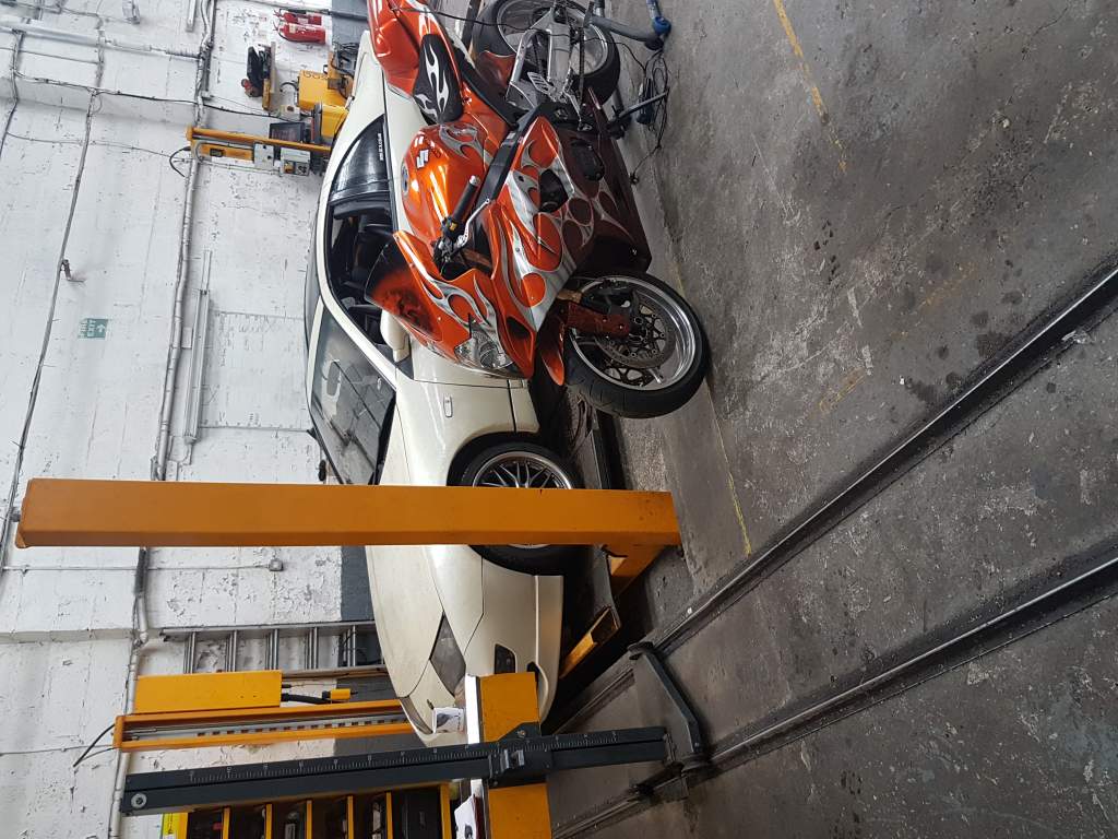

Today I took the car for an alignment on the hunter to setup the replacement hicas tracking:

All passed so now to put some miles on her and swap the interior i bought off keith into it. Also a visit to baz for an r33 gtr brake upgrade

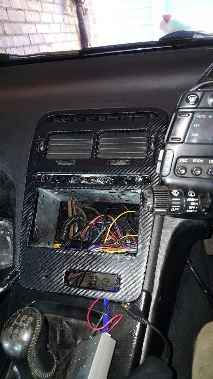

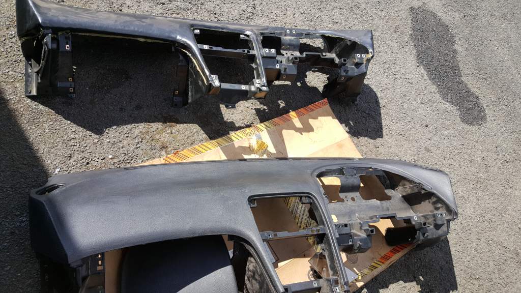

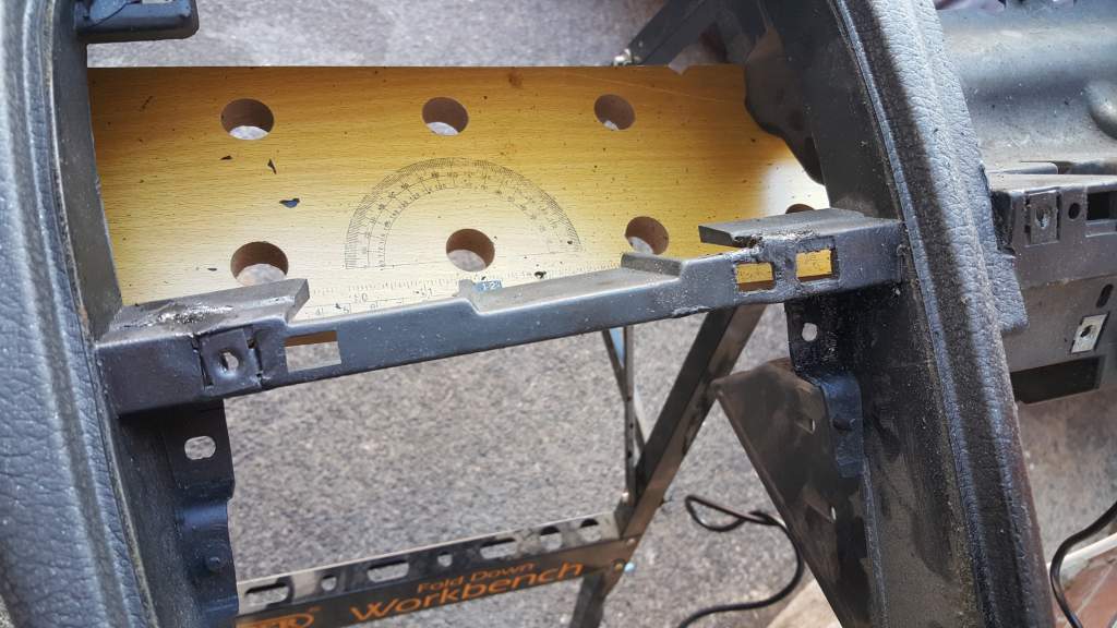

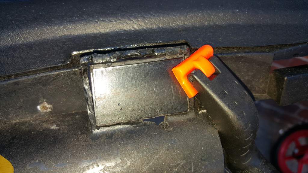

been busy playing with my plastic welder repairing my old dashboard it dont look to pretty but its solid and u wont see it when the stereo din goes on, the mountings for the clocks were smashed so i am having to weld a slab of plastic to it

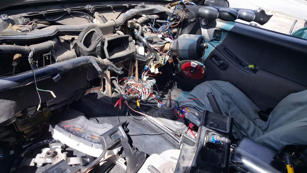

well after finaly repairing my old dash time to pull the car apart ... again :scared:

And whilst I was there I had it back on the hunter for a fine tweak!
Shame, they look better also.
