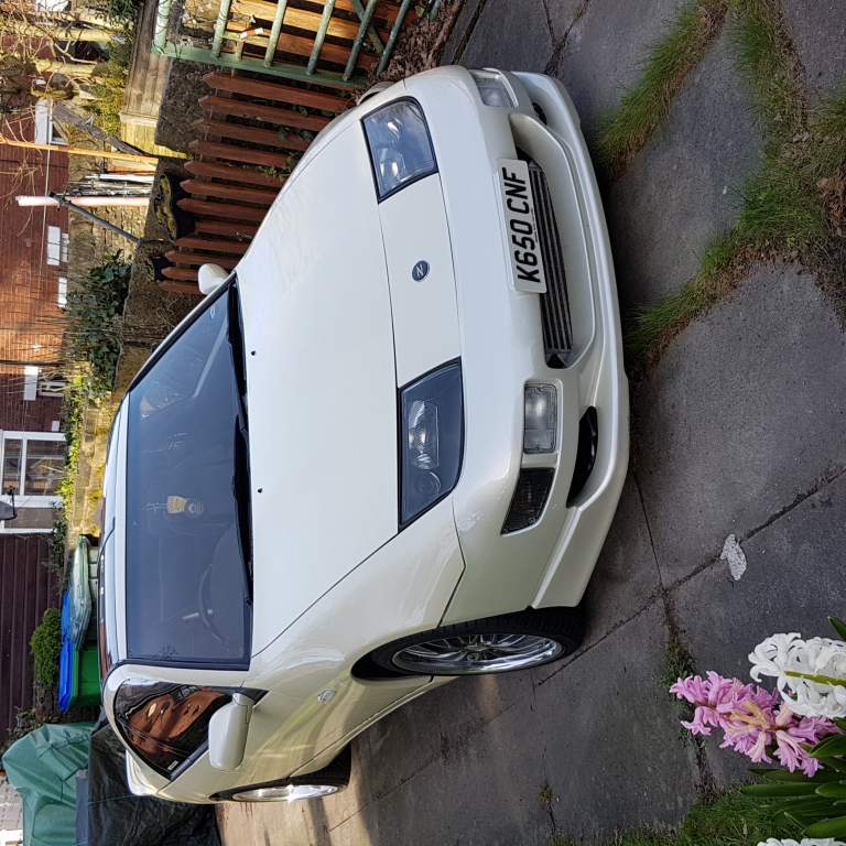

Polished the z today.
Did not have the chance to take it out for a blast!
[ATTACH=CONFIG]105385[/ATTACH]
Wow, already full summer where you are Art? :lol:
Either that or that Hydragea is in desperate need of a dead heading. ;)
