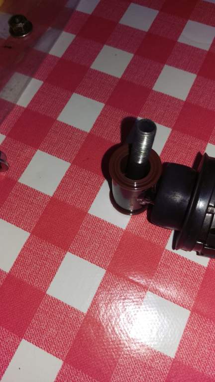

Any chance someone has a new, genuine collar they would send me immediately?
[ATTACH=CONFIG]105048[/ATTACH]
Is that a yes or are you rubbing it in? [emoji38]
Yeah throw me a Pm :)
Postage will be a couple quid

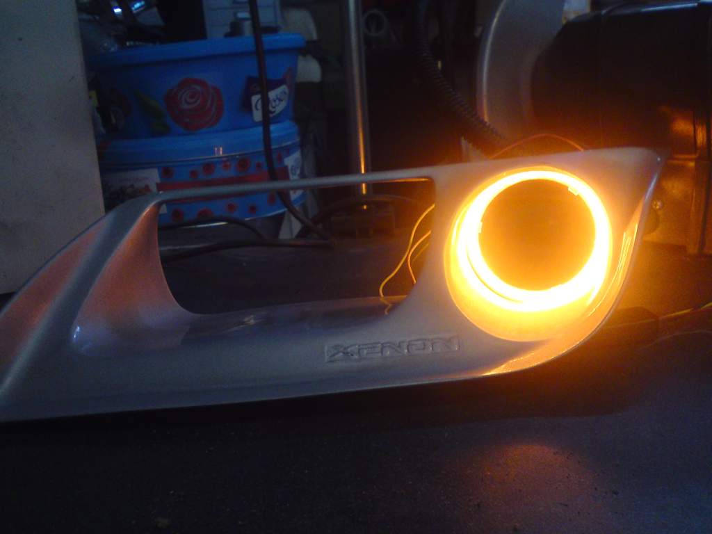

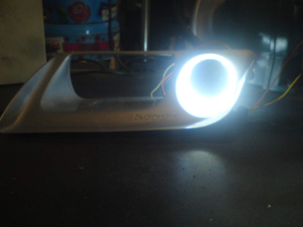

I have briefly come out of retirement to amend/update something i did for someone 18 months ago, switchback halos are available these days :cool3:.
Only quickly rigged up, running or side light.............
[ATTACH=CONFIG]105081[/ATTACH]
That switches to a good strong amber when you signal, it then returns automatically to the white once the stalk is cancelled :).
[ATTACH=CONFIG]105082[/ATTACH]
Excellant work as usual but just remember if the white halo is the only means of a position light then this setup is an mot fail

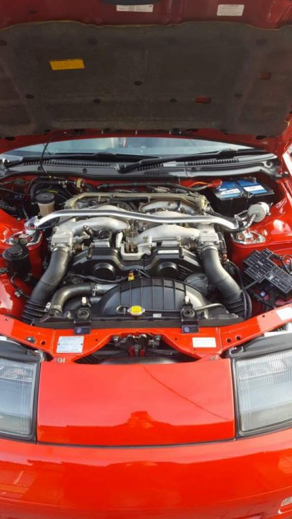

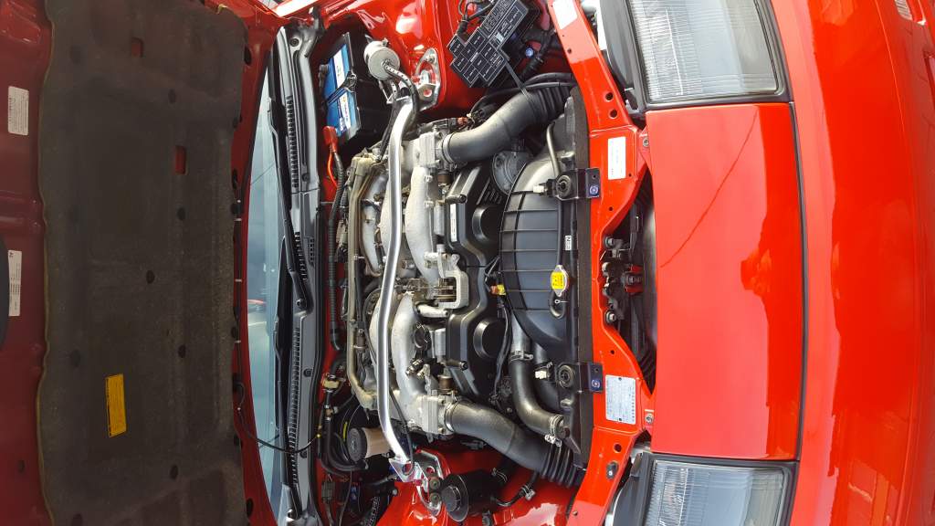

I fitted the carbing strut brace and give the old girl a thorough clean.
[ATTACH=CONFIG]105083[/ATTACH]
Damn this picture rotating thing! There must be a way to sort this?.....
You can fix it by rotating the picture :lol:
It doesn't seem to matter how far along you get, the list never gets any shorter!
This coming from the guy with the impeccably clean Z :biggrin:
If mine was as clean as yours Joely, my list would consist of wax and... Polish??? Can't think of anything else right now lol.
I'm sure you've got a list longer than most by now that you've checked off so far.. I certainly haven't ever found fault with it.
One to be admired for sure
Now you just need to fit a Carbing rear strut Chris. I found it makes quite a difference to the feel of the car's handling.
I didnt really think it would make any difference on the rear andrew as the top of the suspension is bolted on to a box section running across the width of the car.
Maybe it is something i should consider if you feel it does make a noticeable difference.:thumbup1:
Infact the front and rear of a 300zx don't lend themselves to a strut brace. The lateral load is across the sub frames, particularly in the rear. That's why the struts are held in with practically cheese, they aren't structural as such.
Unfortunately though the TT body dos flex and the rear bar helps here. The biggest flex is in the front rails to body on the monoqote chassis.
