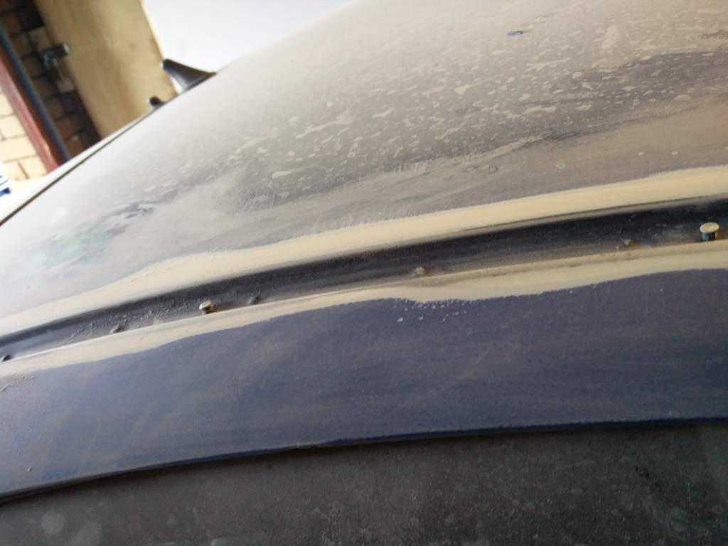

Some Pre-bodyshop preperation.

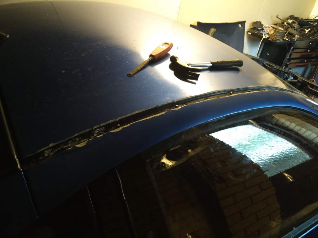

Previous owner of my shell had deleted the Slicktop roof trims.

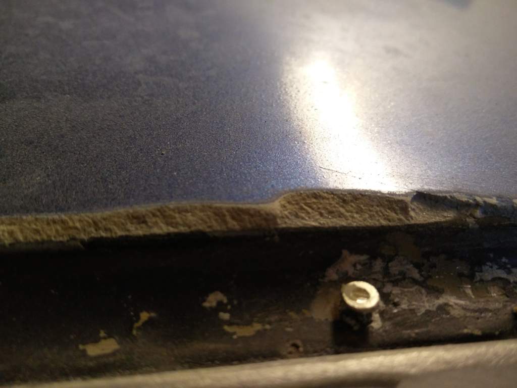

I quite liked the way it looked, but over time filler in the channels had cracked, so I decided to take it back to stock...

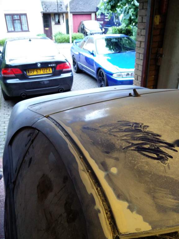

Thick filler :blink::hurl:
A few hours later....
Don't envy you doing that little job.
Its a bit daunting taking a Hammer and Chisel to it :scared:
[ATTACH=CONFIG]98281[/ATTACH]
[ATTACH=CONFIG]98283[/ATTACH]
[ATTACH=CONFIG]98284[/ATTACH]

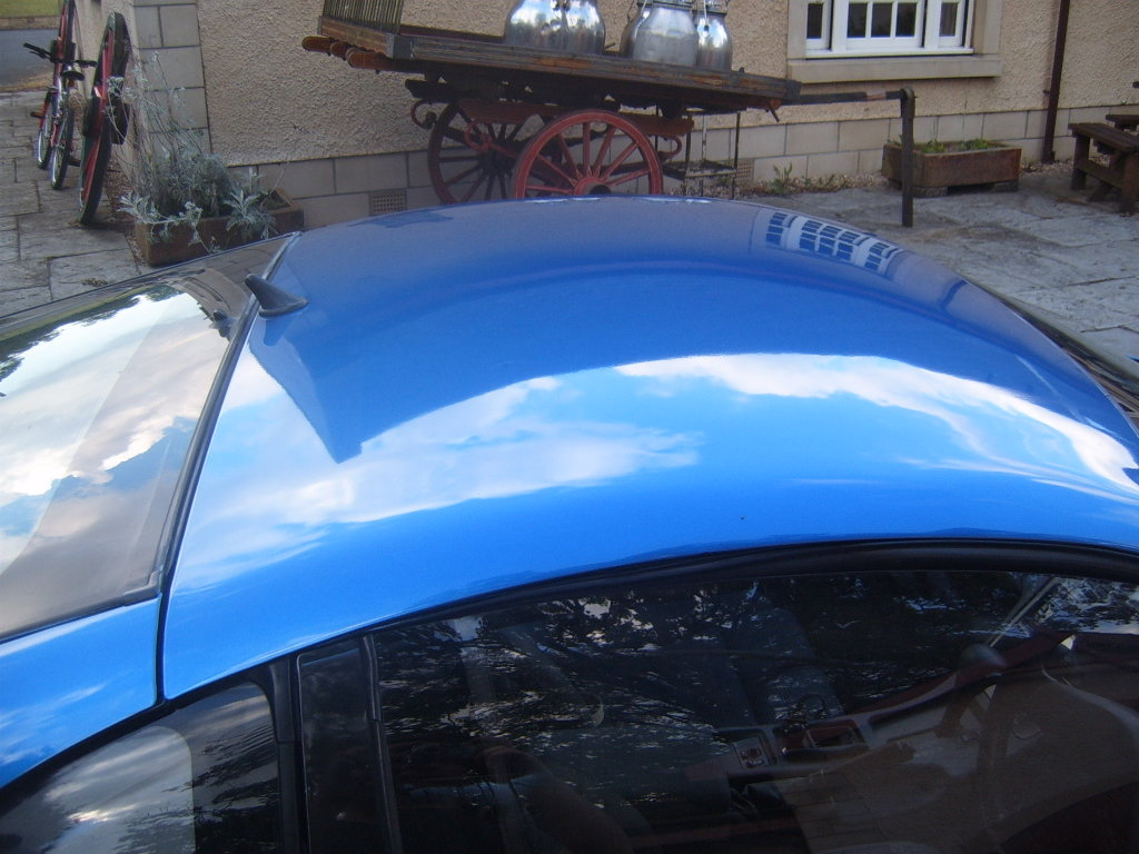

[ATTACH=CONFIG]98282[/ATTACH][ATTACH=CONFIG]98285[/ATTACH]
You won't regret it - brave to get the tools out tho!!

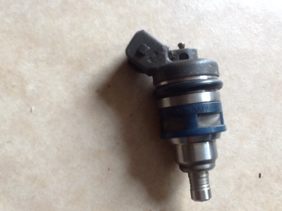

Can anyone tell me if I can fit a series two injector in the rail if the other five are series one type? Will it make a difference or is it a big no no? The injectors I have, have a brown plug socket with two flat pins.. Are these S1 or have they been changed before do you think?
Thanks in advance for advice..
To use a S2 injector on a S1 rail I believe an adapter is needed.
https://www.z1motorsports.com/fuel-system/z1-motorsports/injector-adapter-kit-new-style-injectors-early-fuel-rails-p-3348.html
If you mean the Model series, then yes they are the same.
There are 2 different versions of injectors though.
Phase 1 injectors are the same from 1989 to 1995.
Phase 2 injectors are from 1995 onwards
The later version wont fit in the earlier rail without an adapter kit and different connectors.
Brown connectors are the standard TT 370cc injectors, they are actually purple when new but go brown over the years.

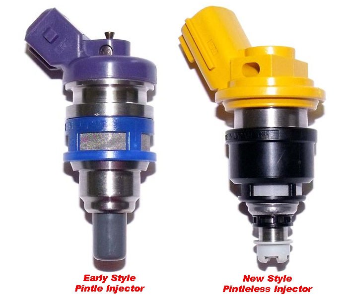

A visual comparison of early pintle vs later pintleless injectors:
[ATTACH=CONFIG]98299[/ATTACH]
Just to add, the early ones discolour. So if it's an early one, most likely, it will be square as seen and will have changed from that lovely blue/purple to chocolate shit/brown.

Like this paul its on its way mate new I had some somewhere [ATTACH=CONFIG]98309[/ATTACH]
Ted you are a diamond mate, can't thank you enough... If I can help you out with anything else you need for your car mate, just let me know and it's yours gratis..
Was beginning to think the agm in July might be missing a NemesizX for a minute.. I have my fingers crossed that the five remaining injectors continue to function until I can afford to replace them all.
