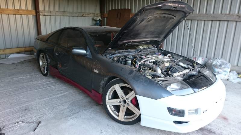

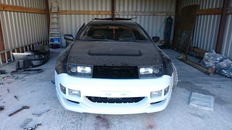

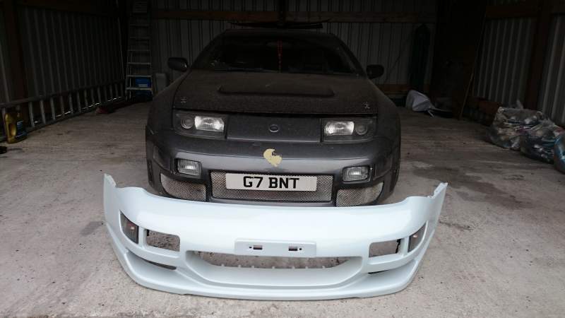

Hey hey hows everyone doing, haven't been posting much so figured a quick update is in order. Had her parked up at a yard I'm renting for the past 7 months. Since then the battery has been flat and removed. No more costco battery for me. Seems the S4 can only last 13 months and even though at 75 quid I had to pay the renewal fee (twice) to just get it exchanged. Good bye costco hello varta 4 years warranty. Fitted the 99 spec bumper and the nose panel I purchased a while ago. Also some greddy side skirts for visuals. Also removed some dead weight.
Wasn't easy removing or fitting the bumper without the correct tools. Didn't have my tool kit and didn't want to around borrowing some. Pain in the culo!!!
Happy to see no surprises of damages, repairs or rust etc Happy days!! :clap:
Edited by princeking
Fired up the first time with new battery, drove her around the yard and back into its shed. Now just need to fix the damage, full respray, smic or fmic (which are most recommended?) and a remap and we good :punk:

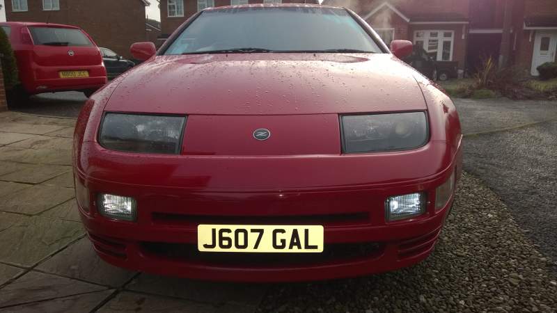

Hey Prince, if I wasn't driving my Z daily I'd have sworn you'd stolen my skirts lol! Exactly the same as mine and even the same colour! Your 99 spec front end looks great mate!
I've got an ab flag type 4 front end on mine, took me ages to find out what it was but now I know! It is a fairly unusual bumper to have as far as I can tell cos I've never seen another z with one fitted..
I do like the 99 spec though. Certainly looks easier to change the sidelight bulbs anyhow! I've got to take the bumper off mine to replace sidelights and indicator bulbs. I'm gonna get the bumper off one day and swap it all out for led side and indicators. That's a job for the warmer months though. I ain't sitting on the cold tarmac on my drive doing it in this weather that's for certain! No piles for me thanks!

That's coming along nicely Prince
Thanks dude almost there

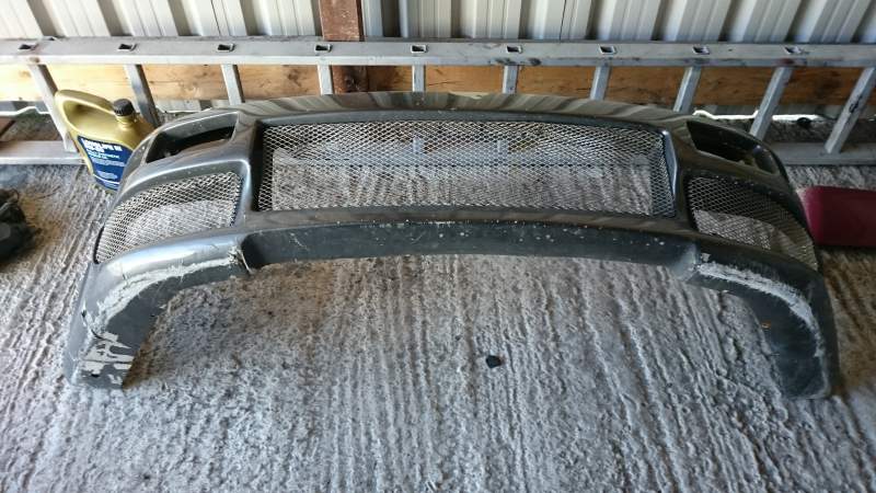

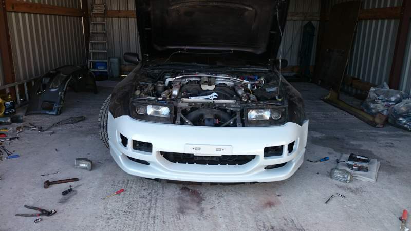

Just a quick question, how easy/hard is it to remove a front bumper on a Z? Mine looks like a pain in the kahunas to be honest especially since the flug bumper seems to have different screw locations to the original fittings.
I know there's a couple under the headlight area, I've seen the holes for access but I'm gathering there are a few located inside the front wheel arch covers?

They might just be yours!! Can get a genuine copy of anything!! I still like the bumper that was on it, cant remember what it is but just wanted a change a little new with old. Removing the the bumper is easy so long you have the right tools, I didn't and took me almost two hours to remove one bolt that's accessed from the side light!! Anyone who saw would've probably thought I was frozen in a break dance pose lol. A hell of a lot quicker with both front tires removed. Id say about half n hour including removing the tires. For me was, one inside each wheel arch, one beneath side head lights (access from side light) and 4 under the nose panel. Mine didn't have no bracket on the sides so will be different for each car I guess. Plenty of tutorials here and online for removing the front bumper.
I removed my front bumper tonight as it's off to someone else this week. Took about 5 minutes. Depending on how much factory stuff has been put back on yours after they've fitted the abflug you'll have 4x 10mm bolts under the nose panel, two 10mm nuts holding the bumper to wing - remove the side lights to access them and you'll need an extension and a deep reach socket, then there should be a cross head screw holding the back edges of the bumper up to the wings. There are other brackets that fit near the wings but mine was the same as princekings and there was no brackets there on my aftermarket bumper.
Mine doesn't have any sidelights at all apart from two slots in the front. I guess you could say they are where you'd usually find front fog lights. This is why I'm imagining that the job is gonna be bacon! (a pig) I haven't seen any way of accessing the bolts securing it to the nose cone yet either! I've seen how the original bumpers secured and if those bolts are still in use for this flug bumper then It'll be a day of profanity and knuckle bandages!
The design of the flug bumper incorporates the standard side and indicator light fittings but they are housed behind the bumper and two slot style clear covers are placed in the bumper so the light shines through.. Great to look at butte genius that designed it obviously hadn't thought of the poor sod that has to change the bulbs!
Every now and then I have to tap the bumper to get the sidelight working so there's a loose connection there somewhere. I'm planning to remove the original lights and use the wiring loom there to retro fit some led sidelights and indicators which will be custom made to fit in the slots of the bumper and therefore if a bulb should give up the ghost, then changing it will be a simple case of unscrew the light fitting and plug in a new one. Simplezzz!
I might be on the lookout for some original sidelight and indicator plugs to keep the plug and play simple. So again if anyone has any old dead or dying bits, let me know and I'll sort something out for them..

As you can see in the photo, there are no sidelights as such to give access to the bolts securing the wings.. Just those two slots in the front which have the original lights directly behind them. There are two 15mm holes in the air ducts for the intercoolers though so I assume there should be limited access to them from there..
I'm certain it'll be a pig of a job especially since that bumper has been fitted since it was imported in 94. I imagine there will be some fighting with rusty bolts, but I'll be replacing the all with 316 stainless steel bolts when the bumper goes back on..
