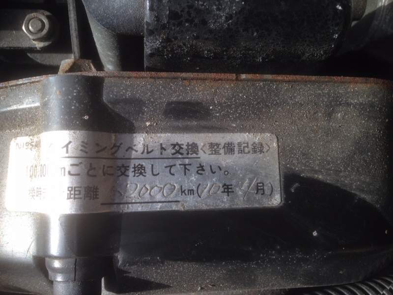

The cambelt change sticker on the case says it was replaced at 62000 kms at 10year (2010), 4th month. (Lucky I speak half Japanese)
I've just realised it could be 4th year (2004) 10th month in which case you could be right O.O

Do you mean this sticker?
The problem is that the car was first registered in the UK on 27 May 2003
and I just can't see a UK garage using a Japanese sticker.
[ATTACH=CONFIG]93231[/ATTACH]
Yes that is the one, 62ks and in japanese the first symbol is year, and the second is month. but as i said of course it could be 2004 it was replaced and im a doofus :pinch:
I am going to replace it anyway, though it will take more than a couple of hours :wacko:

I think the sticker comes with the belt from Nissan so if they have separate part numbers that's feasible.
You get a japanese and UK sticker when you get the cambelt

Just had a thought with the sticker.
English Grease Monkey + Japanese sticker = numbers put in wrong place.
Also I have a feeling Japanese is read left to right, top to bottom.
So isn't it likely the boxes are swapped on the Japanese compared to the English one.
I reckon you are correct with you assumption that it was 4th year 10th month, but I think the sticker has been filled in incorrectly by an English mechanic.

In Japanese if it is written horizontal (as it is here) it is read from left to right like English, but as you say it was probably a lazy mechanic.
