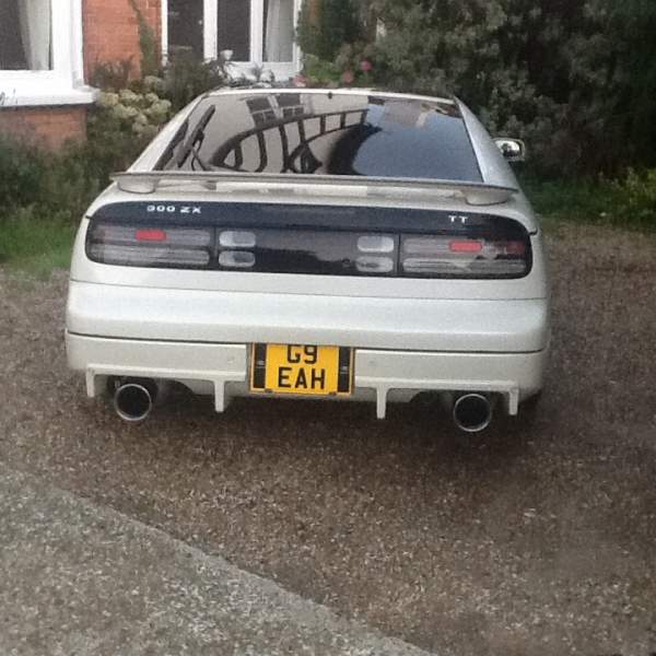

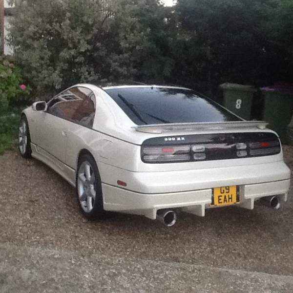

Japspeed back boxes fitted. Love the sound! Not sure if I will fit the middle section though, I leave quite early in the morning :lol:

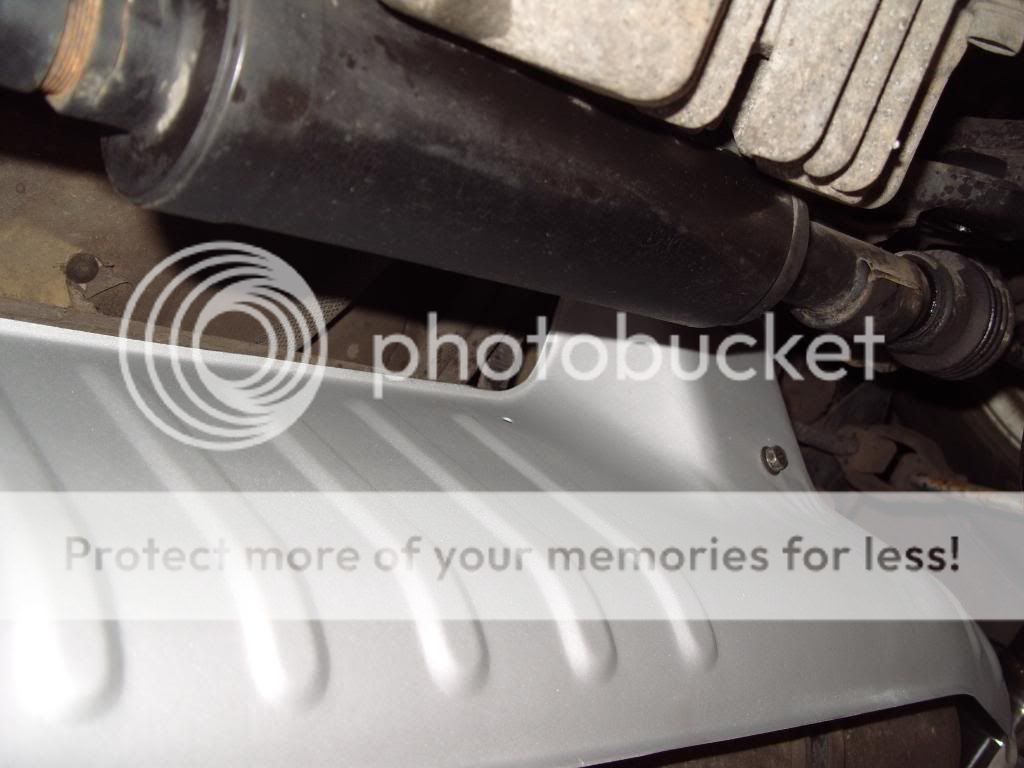

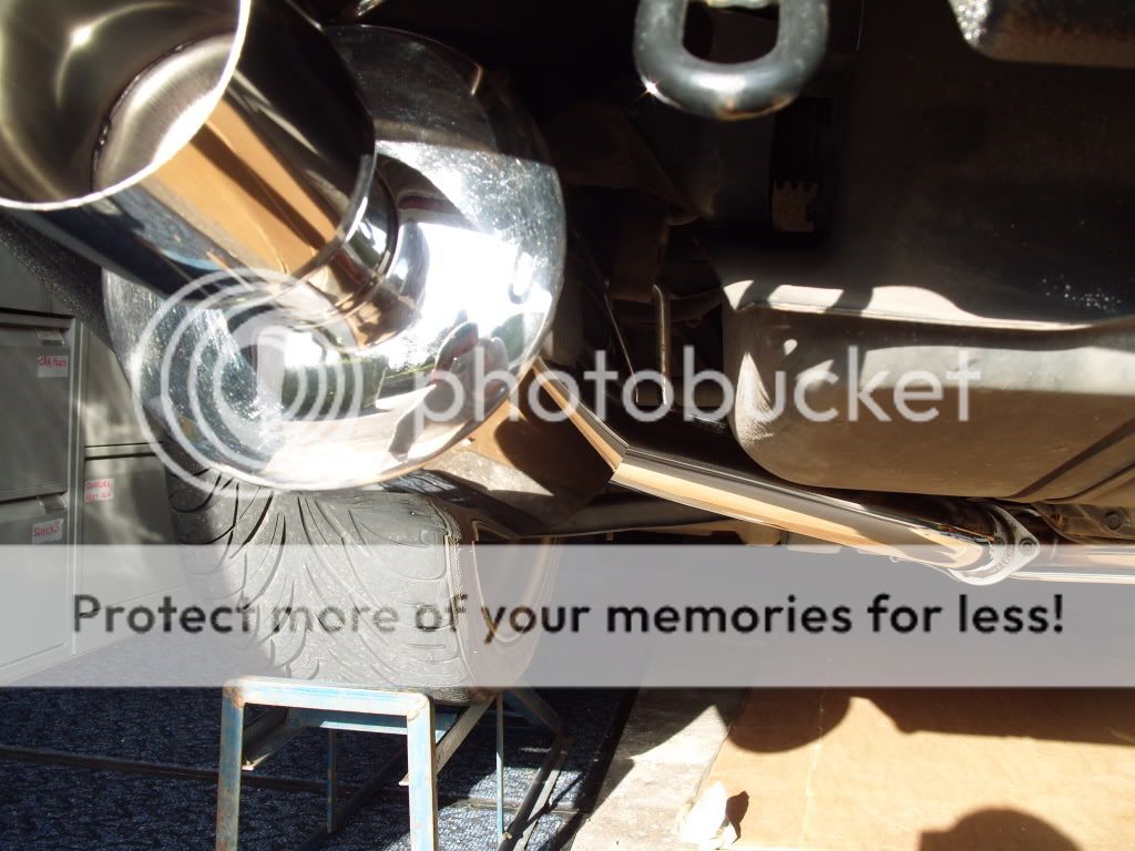

No heat shields on it and it's quite close to the fuel tank...should I be worried?

I wouldn't have thought so matey, there's no heat shields on any aftermarket exhaust and there's plenty of people running them...

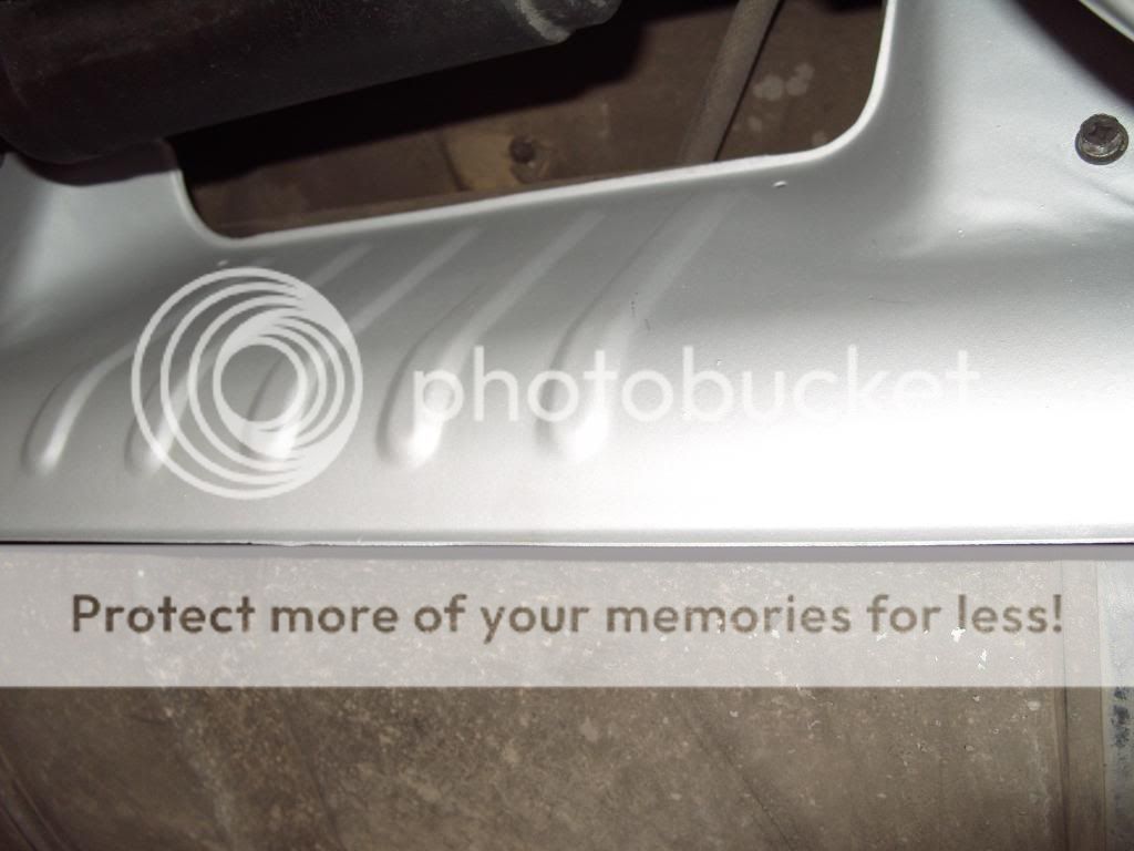

I think he means the heat shield under the fuel tank Rich...a lot of heat can be got from a zorst and ive always re-furbed and fitted my heat shields back on,not an ideal situation to be putting heat into the fuel..

The fuel tank heat shield is on, but it doesn't cover the sides at level with the back boxes. The OEM back boxes have a heat shield but it's sort of moulded on.
It will be fine at the sides Jay. All of us with non oem back boxes dont have heat shields there mate.
