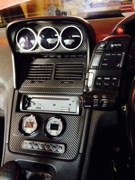

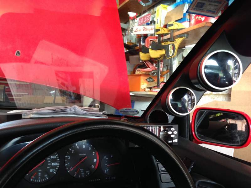

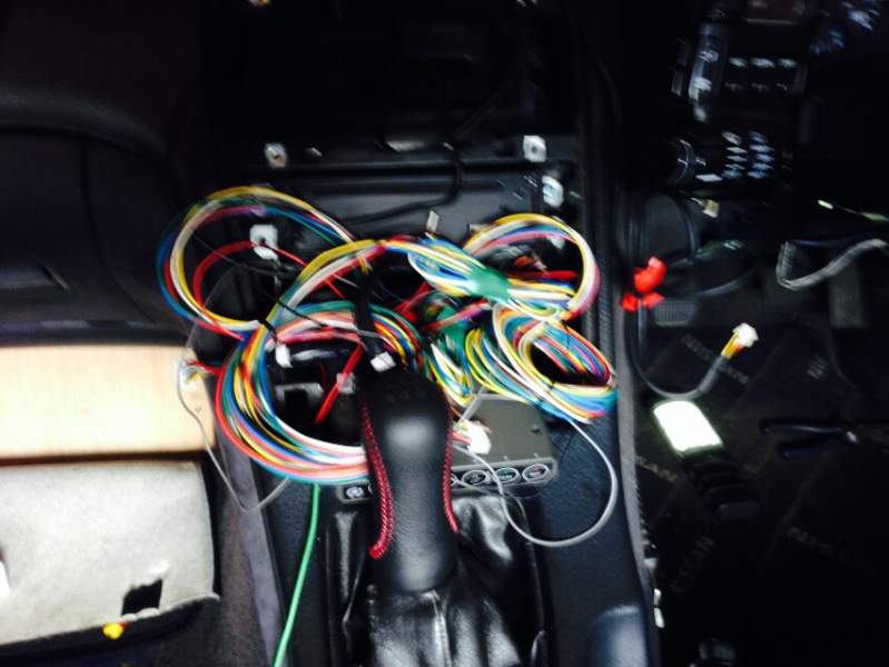

Spent the day sorting out the "spaghetti" of wires for the Widebands and adding more gauges on the A pillar
and fitted my gear knob as well:lol:

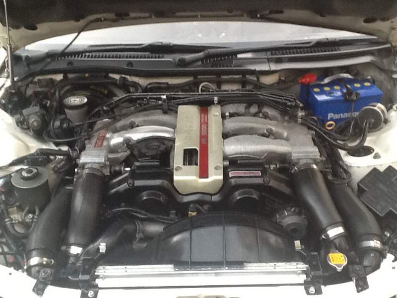

Checked all the rear subframe nuts and bolts were still present and tight, boost leak test then a wash.

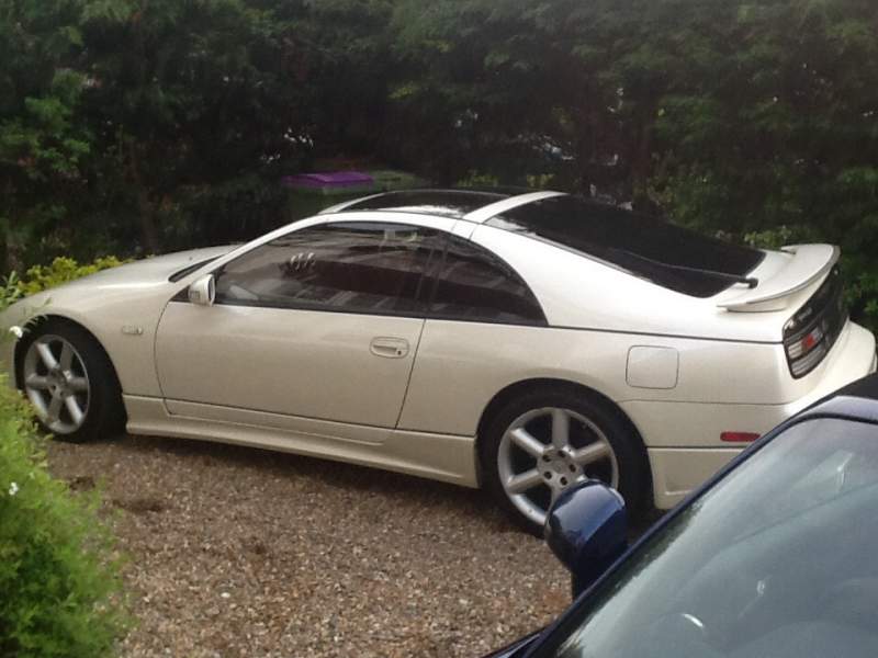

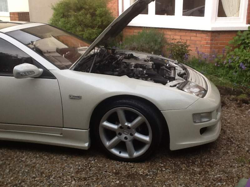

Then I refitted the horns properly behind the front bumper and realised my bonnet is bent upward a bit in middle as though pushed backward, my n/s/f wing is not straight and the gap between the wing and door is miles out at the top..... Looks like someone has pushed the front whilst it has been laid up on my driveway.... The gap on wing to door is huge at top and non existent at bottom now......
Removed front bumper again and fitted intercooler ducting, the fog lights fell into multiple pieces, Chrisbasildon dropped off my new side skirts...... :thumbup: .... thanks again Chris..... Top :nana2::dance:.... lol
Had a visit from the lovely 'Craig' family for a cuppa and to pick up his new acquisition.....
this can happen iff you,ve been jacking the car up on the front nissan jack points (sill/lower wing):sad:
[/color]this can happen iff you,ve been jacking the car up on the front nissan jack points (sill/lower wing):sad:
Only problem is that I jacked it on the main chassis rail as always..... I noticed the veilside bumper had split where it was bonded to the wing when I removed it.... but just thought it was due to body flex....
going to have to check what has happened when I get the side skirts and wing off this week....
Any idea how or if this can be rectified??

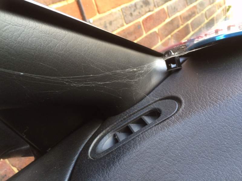

Car is out for the JapFest be nice to meet some of you. I did try to blast the cobwebs out on my trip to Kent and Surrey with the roofs off but sadly I will have to get cleaning for the show.

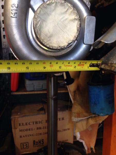

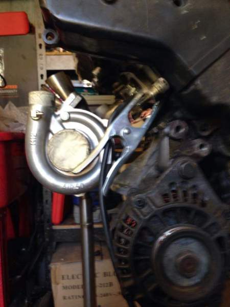

Just realised it's coming up to a year since I originally posted these turbos in this very thread:
Edited by Noz
Also ordered some NGK Racing plugs to test out in the VG. Grade 7 all the way down to grade 10 :D
[ATTACH=CONFIG]87151[/ATTACH]
[ATTACH=CONFIG]87152[/ATTACH]
Fun times ahead.
Edit:
About time! What's each one rated to? (hp or cfm)
Who knows! These are just for placement as my manifolds are being meticulously created from scratch.
I will be going for twin GT3582R with a fully-built drag-spec PowerZed engine

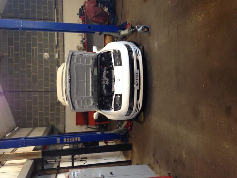

Spent the entire day at Jimmer's. Helped him fix a customer's leaky targa which was a success, then went amount working on my Z. My cam belt was done 8 years ago when Jim built the engine, despite the car only covering 20k since, I thought it time to get it replaced and get all the tensioners checked. The belt looked fairly new still with no signs of wear or weathering (the car is kept in a very dry environment), but it was replaced anyway. Top idler was replaced, complete coolant flush which was very much required!! It will have another change soon as it was well over due and I want the system squeaky clean!
Also replaced the ARB bushes at the front and new drop links. Drop links didn't really need replacing, but they were anyway, the bushes did. Next visit will be after I return from the US and that will be to fit all my new rear end bushes and powdercoated arms etc, new joints, HICAS inners, plus my full Brembo brake upgrade, new servo, SS lines, single piece prop, transmission mount too.image.jpg
