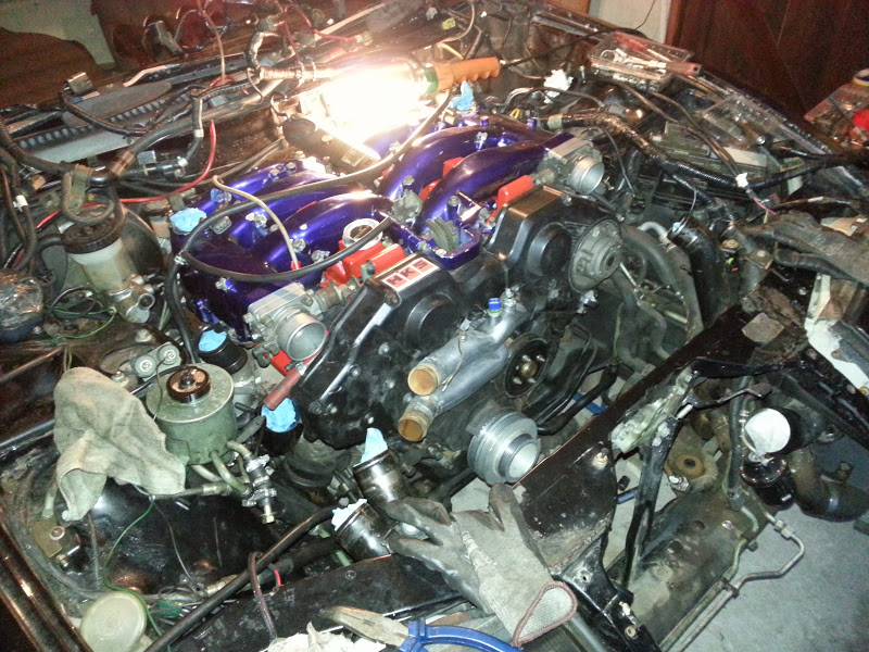

only prepared it (again...) , tomorrow i try to lift the engine (already unscrew everything) :) .
Dont forget to undo the earth strap from the rear bulk head just here the batt is
all so the main Live wire that runs along the back and down at the rear Right side of the engine
Nice work dude it's alot of effort by yourself if you don't know what you're doing isn't it! Lmao, i've never seen anyone pull the whole prop out still attached before.
Is there some pictures of you car anywhere on the site, I like the look of it alot:thumbup1:
Great effort mate...must of been like pulling a bot fly with all that prop on it,never ending:laugh:
Its stuck in gearbox, no way i can remove it :/ .
If You asking about my car all pictures are here - https://picasaweb.google.com/109341889407399430291/300ZXZ32TwinTurbo?authuser=0&feat=directlink :)
looking at the pics..you took a chance holding all that weight from the plenum without the boost solenoid brackets on.It must be stronger casting than it looks
