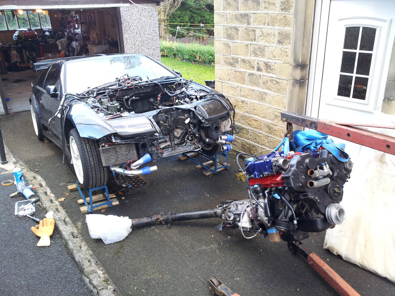

Manual/Auto Box and engine can be removed and fitted

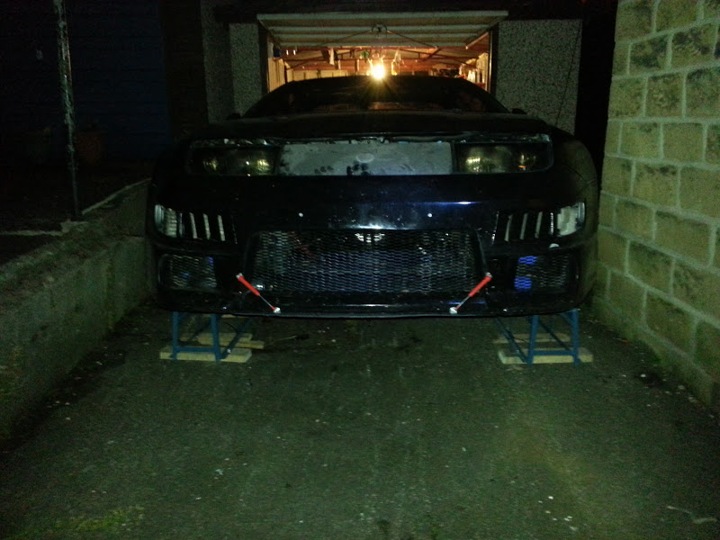

Jack car up Put on Car sands / ramps on all 4 corners about 12" high

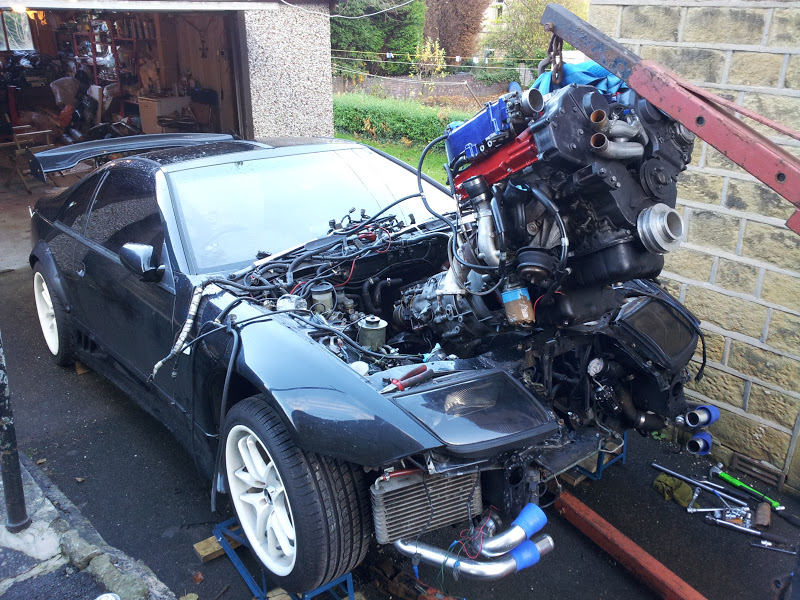

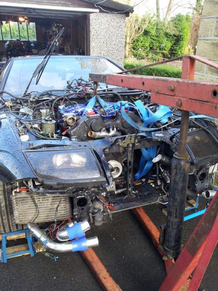

Now when taking the engine out u strap it to the very 4 front of the plenum intakes

started at 5pm today .. engine is now out on the stand at half 7 ..
