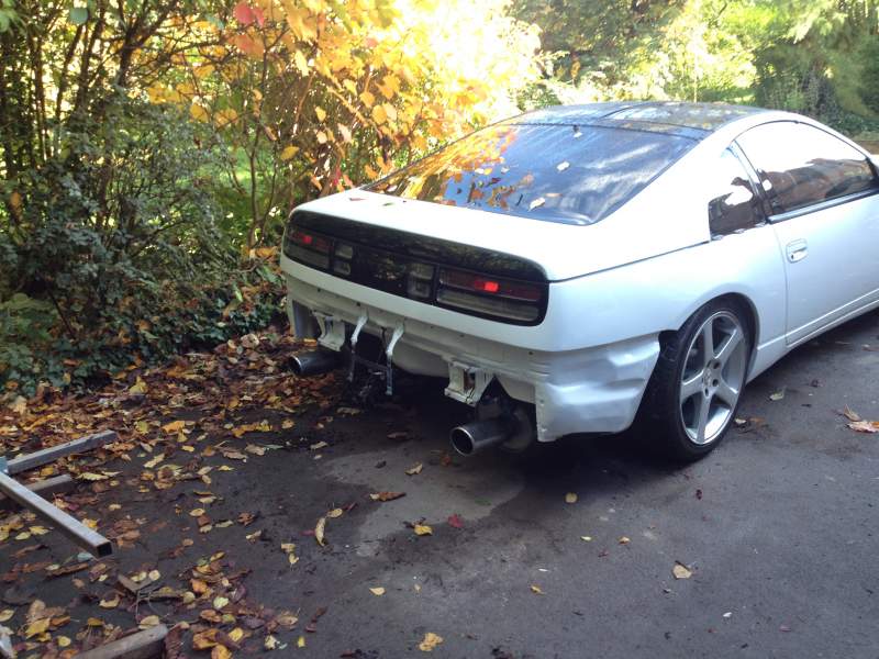

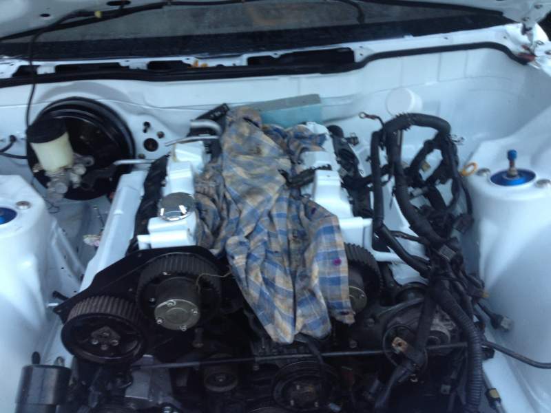

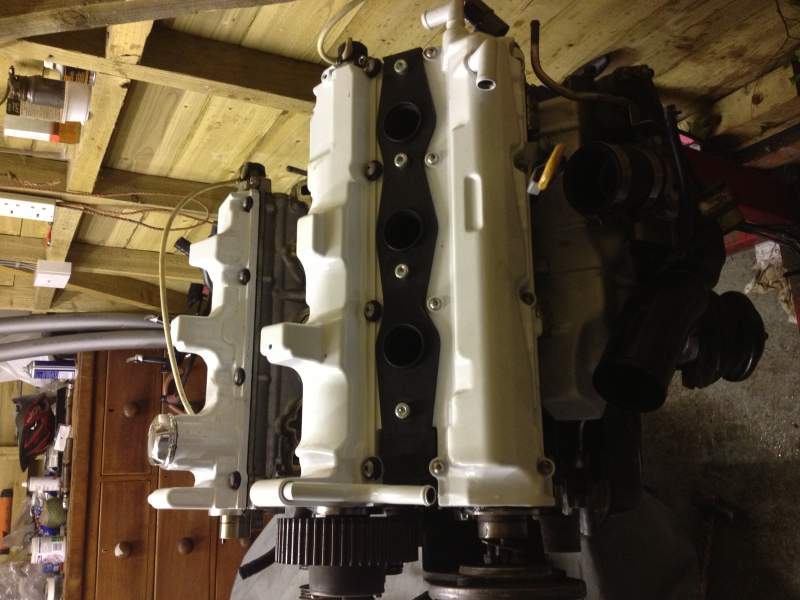

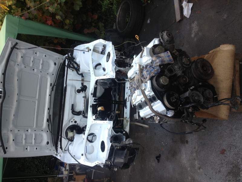

Hey guys
Just wanted to say thanks for the support on the project recently
Ive been in Hong Kong now for about 3 weeks
Ive added a few pics of how I left the car
generally all done, engine still needs work but I was happy with how far I got
