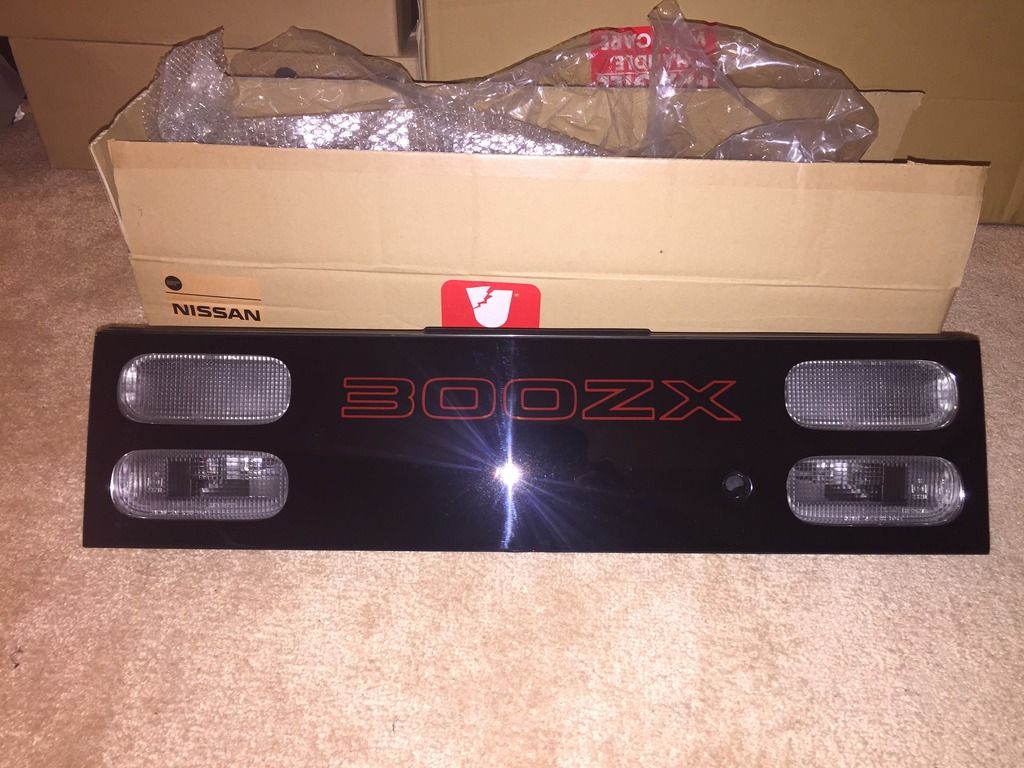

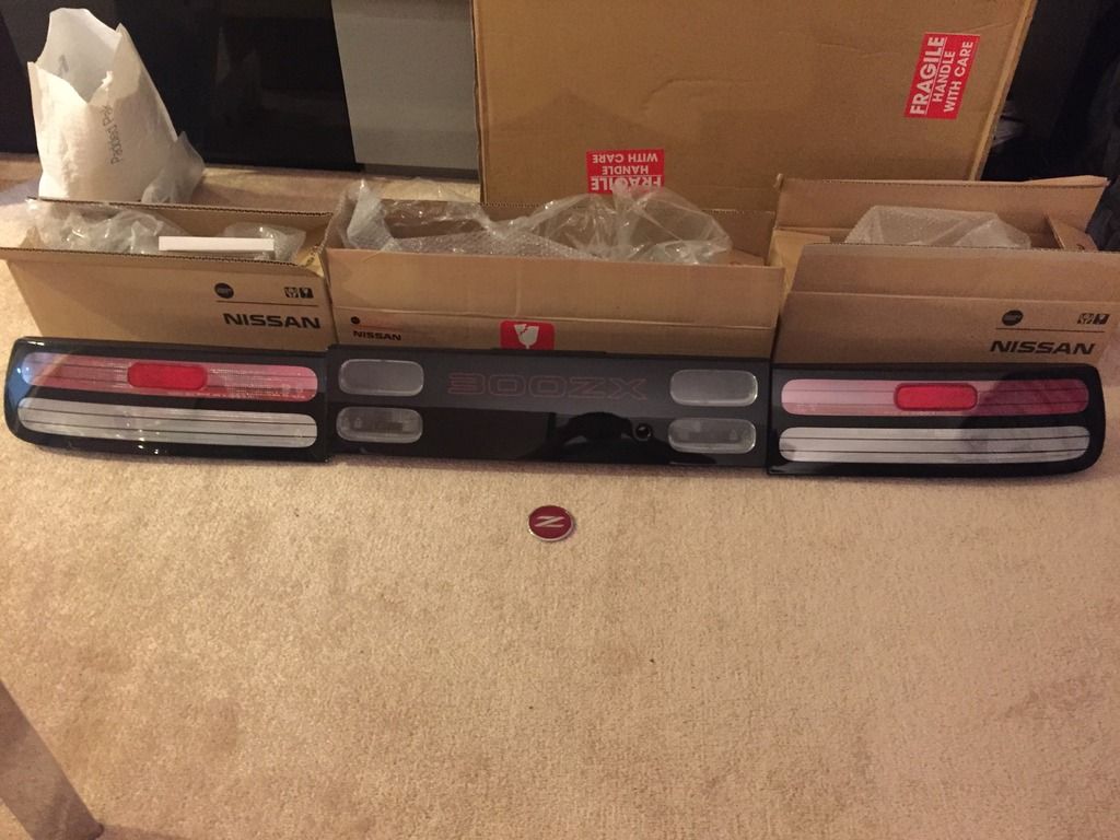

99 spec centre panel
And together with the rear lights

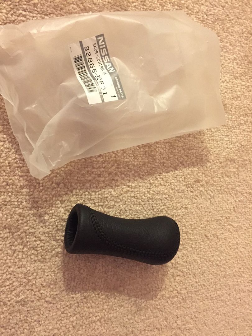

New oem gear knob

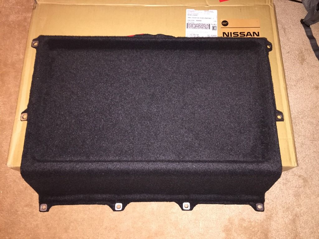

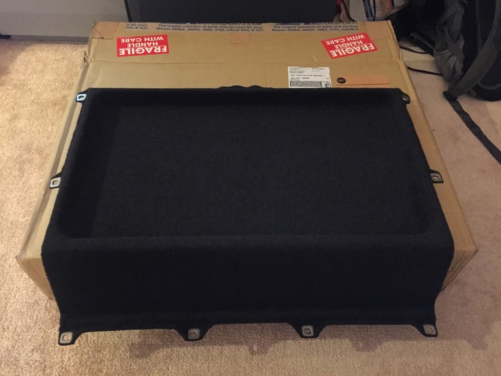

New rear parcel shelf
I was very surprised to still be able to get this so snapped it up as my current one is not up to the std I'm hoping for inside

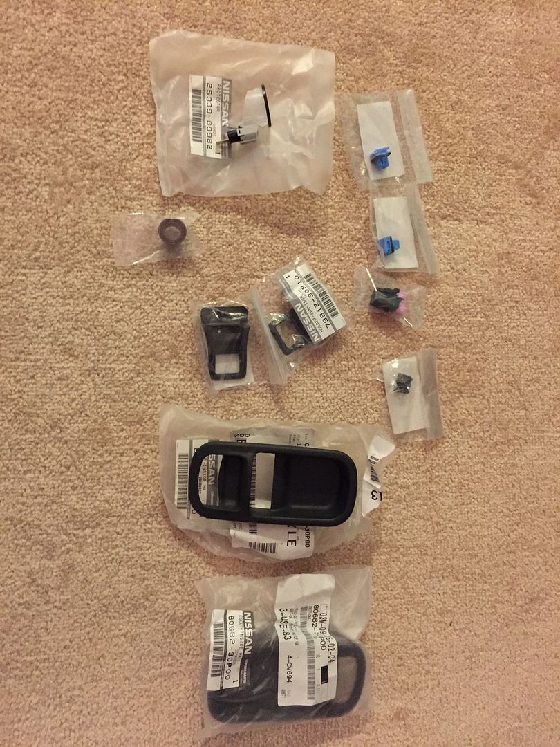

Some odds and sods
Door handle surrounds
Rear sun blind clips as one of mine has broken
Stereo bezel screw cover clips (no more double sided tape)
Perspex strip clips
Cigarette lighter surround (the bulb holder has broken on mine)
New shifter bushes
Oil pressure sender plug

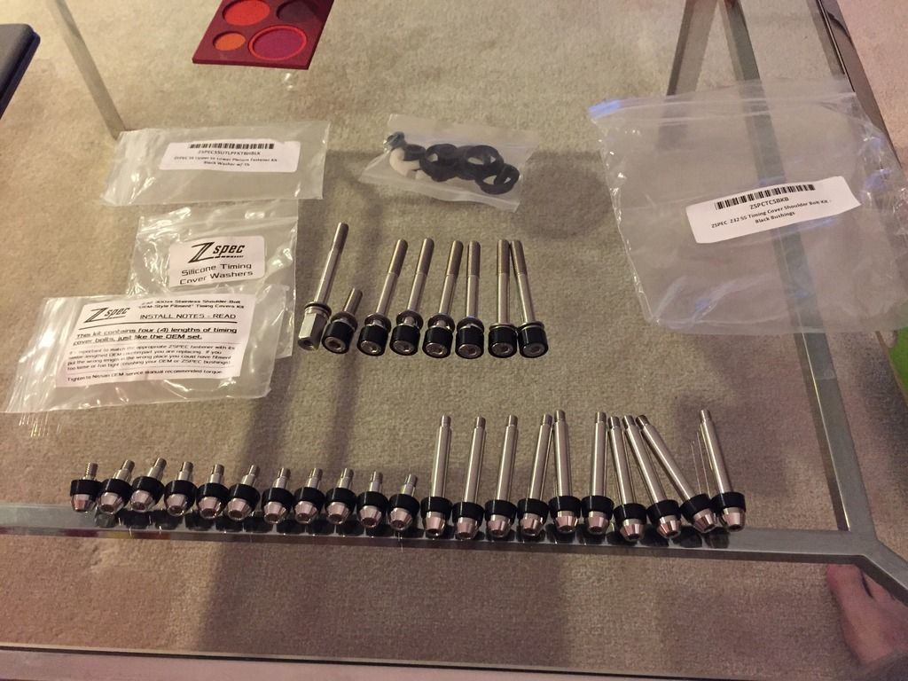

Final bits are a couple of z spec bolt kits
My timing belt cover bolts are not in the best condition and stand out like a sore thumb on my painted cover. Also the rubber washers that sit behind them are very scruffy.
Maybe I'm going a little too far but this kit replaces all of the bolts (I also have some missing) with the correct shoulder bolts. They are very nicely machined in stainless and have the optional poly washers which come in multiple colours. In this case I went for the very exciting black colour.
I also have a new set of plenum bolts with caps (optional throttle cover special bolt)
Also in the picture is the throttle spring washer kit as mine like most fell apart when I rebuilt them

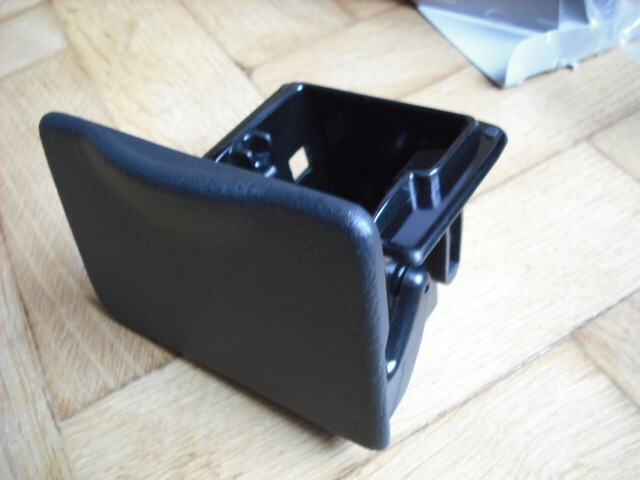

New ashtray

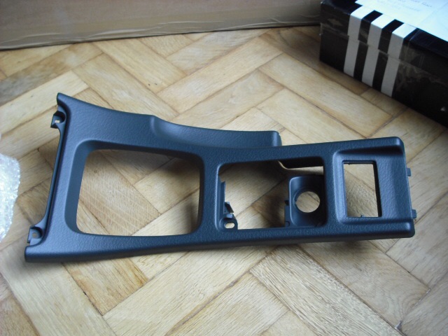

New centre console

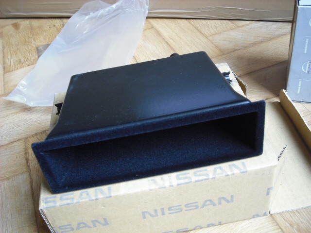

New cubby hole

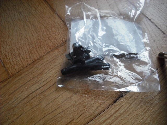

And a new washer jet junction/ clip- many thanks to funkysi for this:thumbup1:

Fitted new centre console

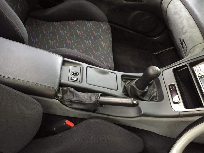

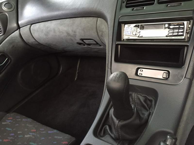

Interior finished off today including re routing the power cable as I have a mid mounted battery
All new centre console bits- leather arm rest and gaiters, centre console, ashtray cubby hole and gearknob
It's amazing how nice brand new stuff feels in comparison to the old stuff

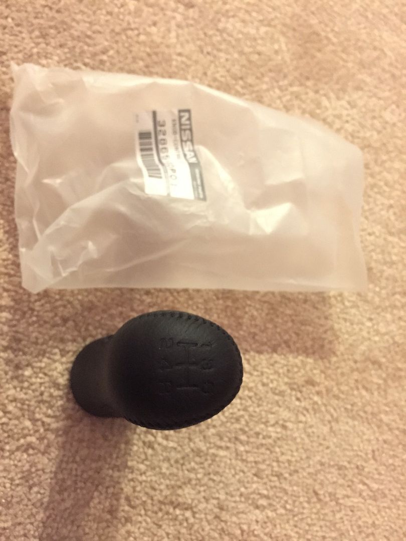

Gear leaver returned to stock with new oem knob, the weight is spot on, not sure why I wanted a short shifter.

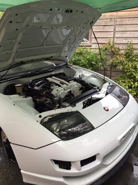

Finally a quick pic of the engine all sorted, except noise.
