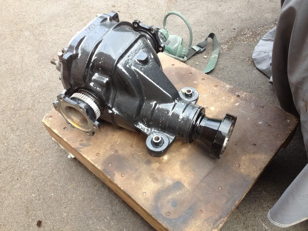

ok big update, lots of paint
drive shafts
p><p>
<img src=[/img]
back plate

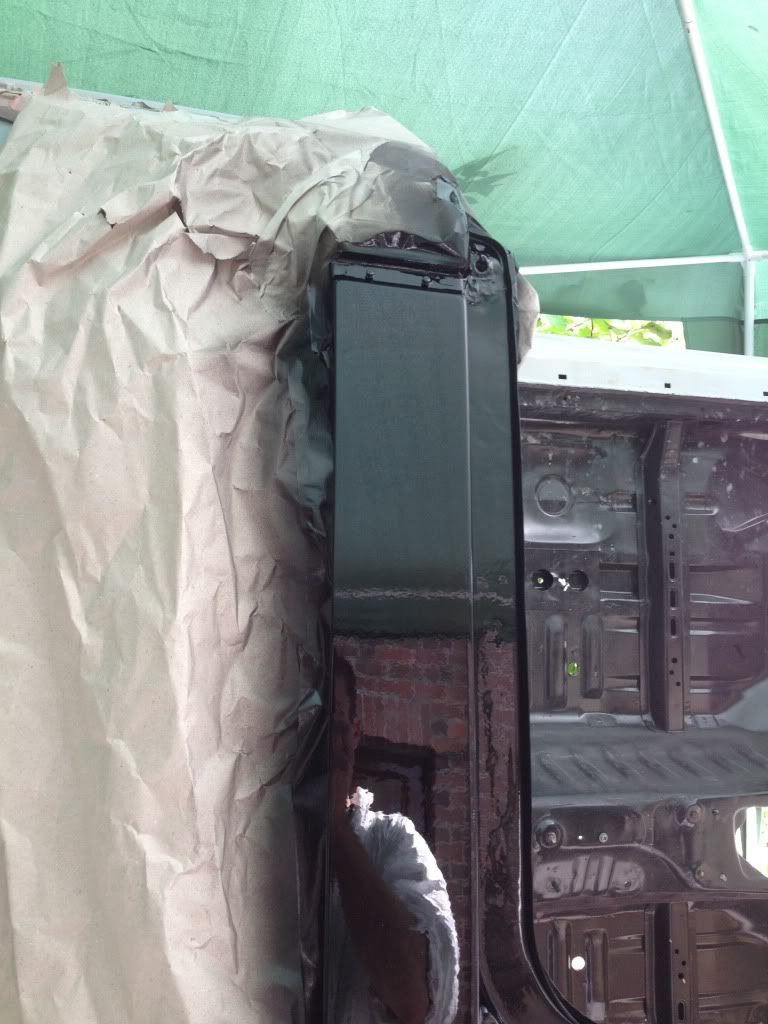

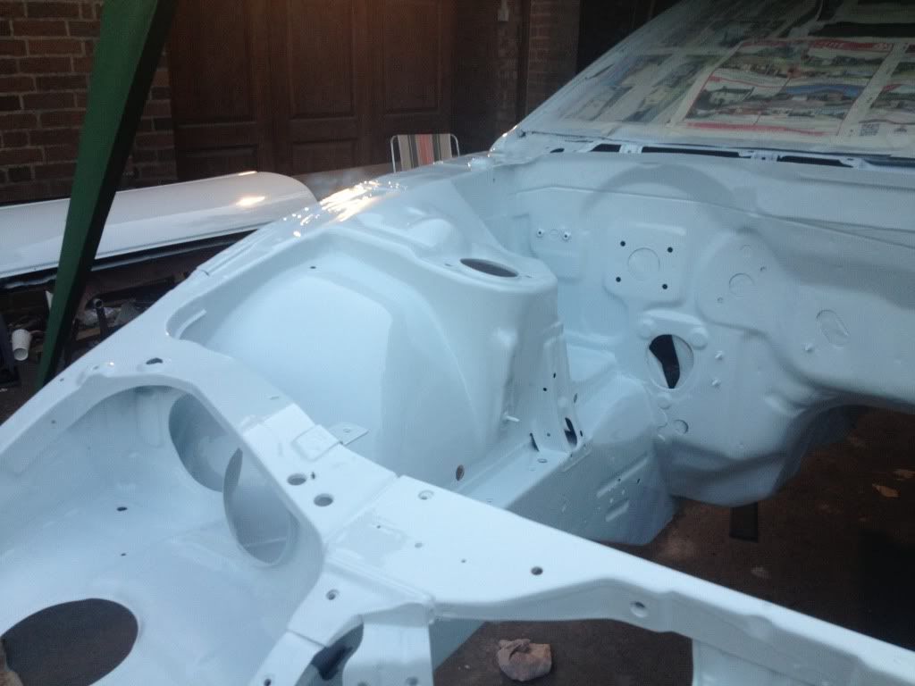

now for the body
the old man sanding down the engine bay, the red paint is a guide coat over the 2k high build, when all the red is gone, its flat
p><p>
<img src=[/img]
p><p>
<img src=[/img]
p><p>
<img src=[/img]
done

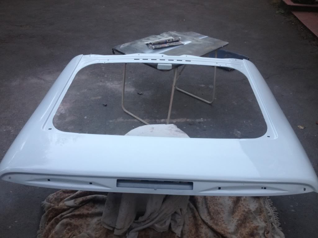

and finally the hatch is also painted but no pic, its despoilered and dewipered. for the record it was a pain dude to previous owners adding holes etc and dents.
no pic at the moment thought. ill find it
doors not quite so bad

a final pic of the typical finish im getting. Im in no way a pro painter and im sure those with an eye for paint will see the orange peel a mile off, im also painting outside so there is no escaping the bugs and dust. my solution to both will be a full wet sand up to 3000 grit followed by a good machine polish, once the paint has hardened for a bit.
looking back over the body tonight I got a few runs and some went on dry. I might give it a quick sand down in the week and a final blow over.
oh and for the record, the colour is ford frozen white. its about as white as I could get without metallics etc which I didn't want to spray.
hope you guys like
Still looks great though mate, im sure it will colour sand and polish out, cut back on the air pressure a tad to lessen the orange peel effect, you will get some orange peeling on most spray jobs, is the wet sand and polish that gets the glass like finish.
