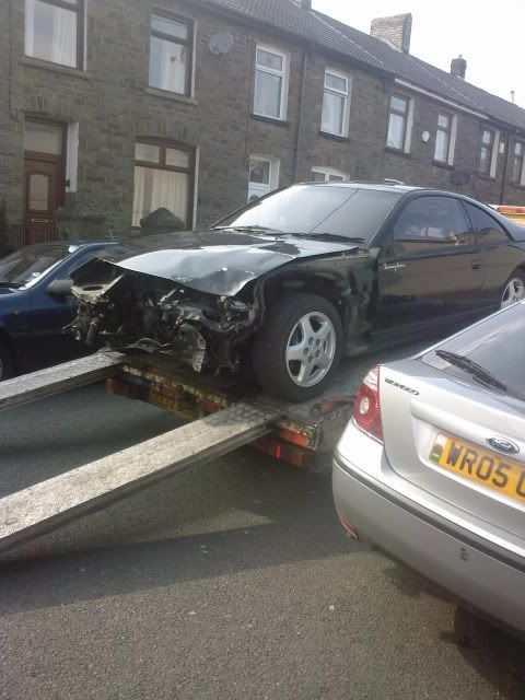

hey guys. as some of you may know i had this car....
after a few months it lookt like this...

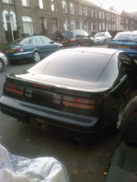

after 4 months ive finally bought this.... :)
Its NA, and auto (not my cuppa tea :p )

the shell doesnt look as shiney as does in the pics, been standing a while, but hope comes up real nice with a good hot wash and polish :)

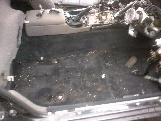

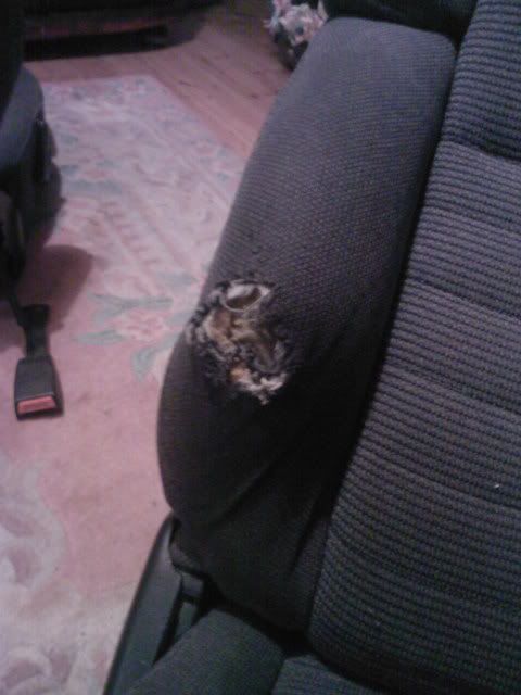

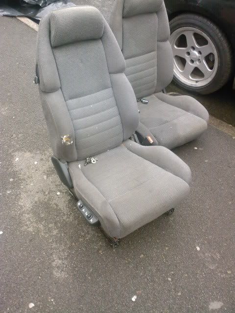

seats removed, as you can see the drivers bolster needs swapping...

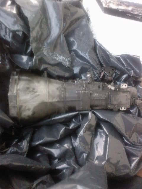

manual gearbox...

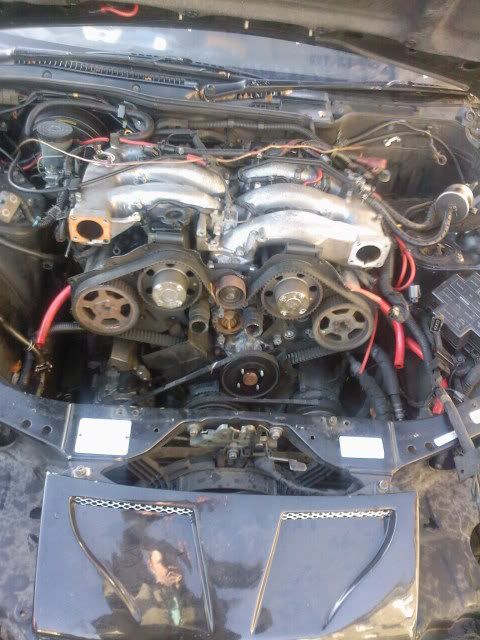

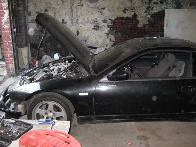

the VG30DE stripped a bit ready to be removed.....

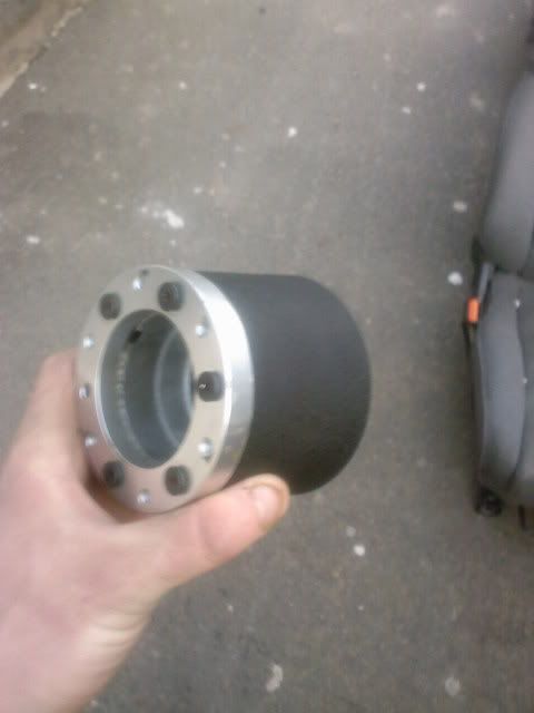

complete pain in the arse, one of the difficult-est things to remove was the steering boss!! (momo boss, with nardi torino adapter)
i smashed the majority of the steering column trying to remove this!!

heres the gearbox...

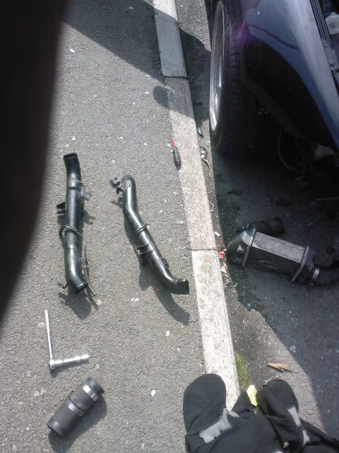

and the IC pipes removed :)
might wanna replace that icooler? or just for test fitment?
just for test fitment. somehow it got damaged, even tho the other side of the car got hit. :confused:

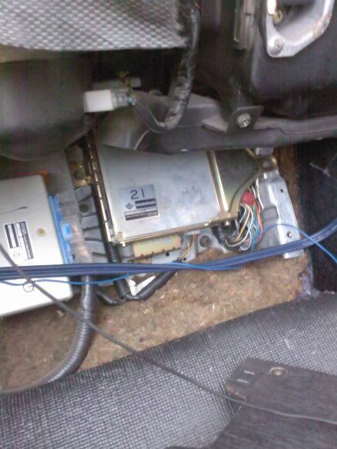

used the Auto Loom, Manual TT ECU.
had bit of stress calculating how to do the prop combination, and had to swap the powersteering belts from the NA block.
anyway, the driver seat has the usual bolster damage, so swapping the top half with one of the seats from the NA car.
complete pain in the arse removing the rings that hold it, and removing the headrest bit etc

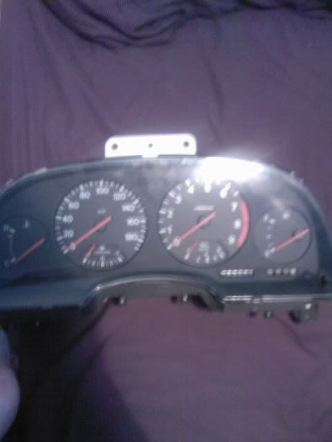

oh, and incase anyone thaught i kept the lightning clocks heres the proper ones lol
Good work mate! Coming along nicely! That offside IC looks a mess though!?
yea its just there to check i remembered how the IC pipes went on.
ive got some new ones courtesy of Anthonyd :duffer:

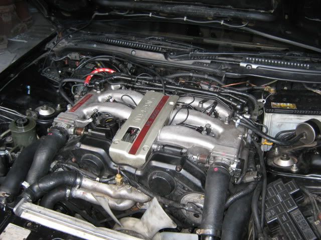

incase anyone forgot, or was interested, heres a pic of the car in its current state
Twin Turbo Engine in
proof of no Hicas solenoid lol
(also removed all the now obselete automatic swtiches and wiring there)
its all up & running, gota sort the piping on the drivers wastegate, and connect the drivers side intercooler.

do you mean the lightning things?
if so im afraid i threw them in the bin, as they were embarrassing lol
