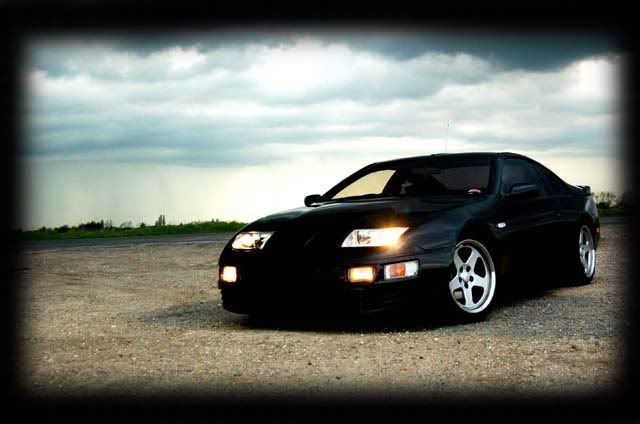

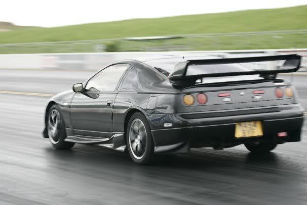

hey guys. as some of you may know i had this car....
after a few months it lookt like this...

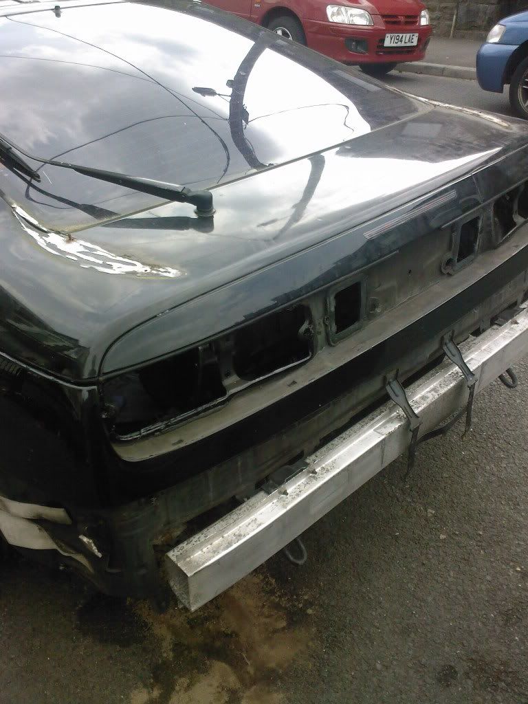

im trying to swap the veilside front bumper for a standard one.
the skirts are off there.
ive removed the gigantic spoiler, which is now in the garden.
by standard bumper is ready to go on, and ive removed the lambo lights, prefered the standard one, as i like how a Z looks standard (bodywise)

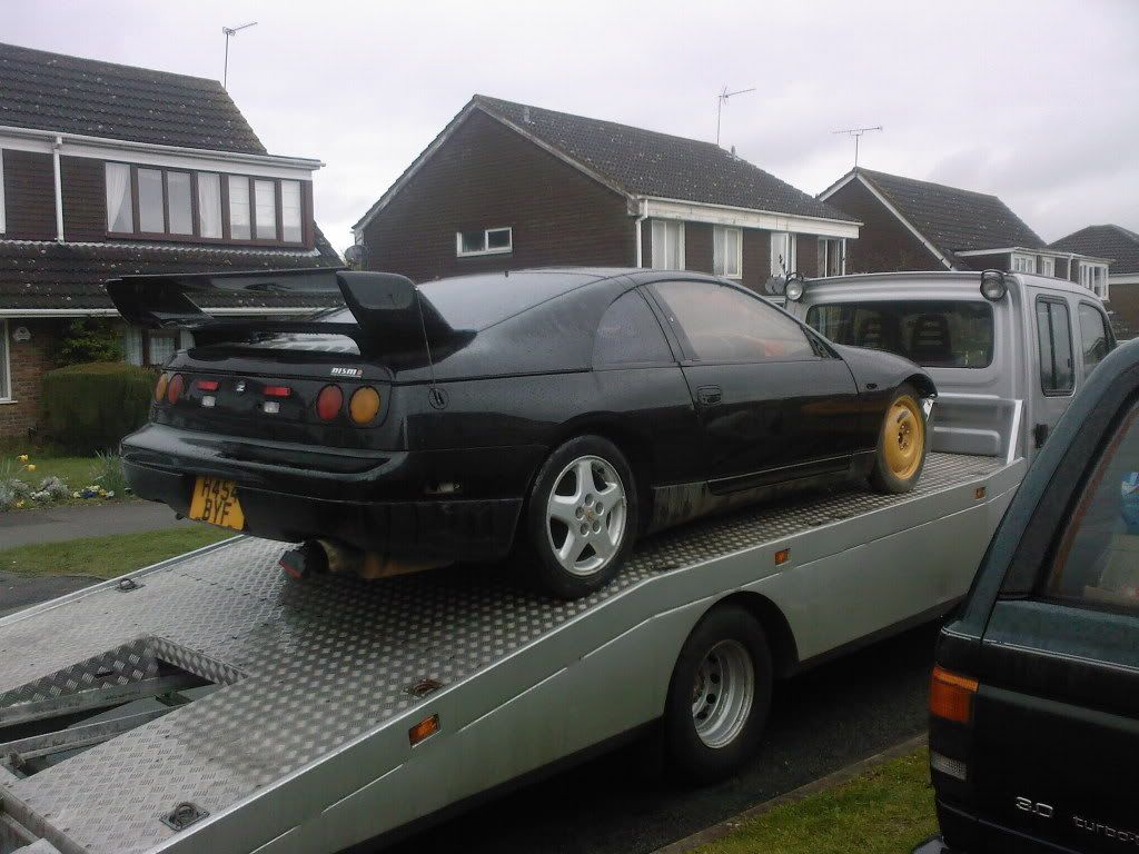

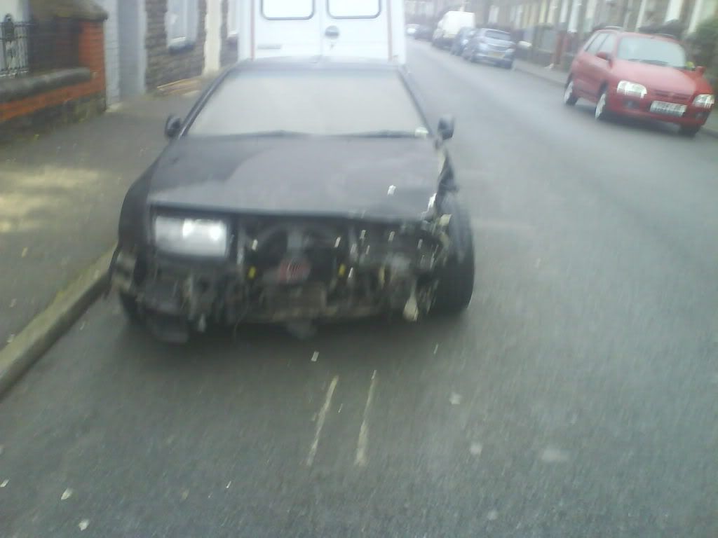

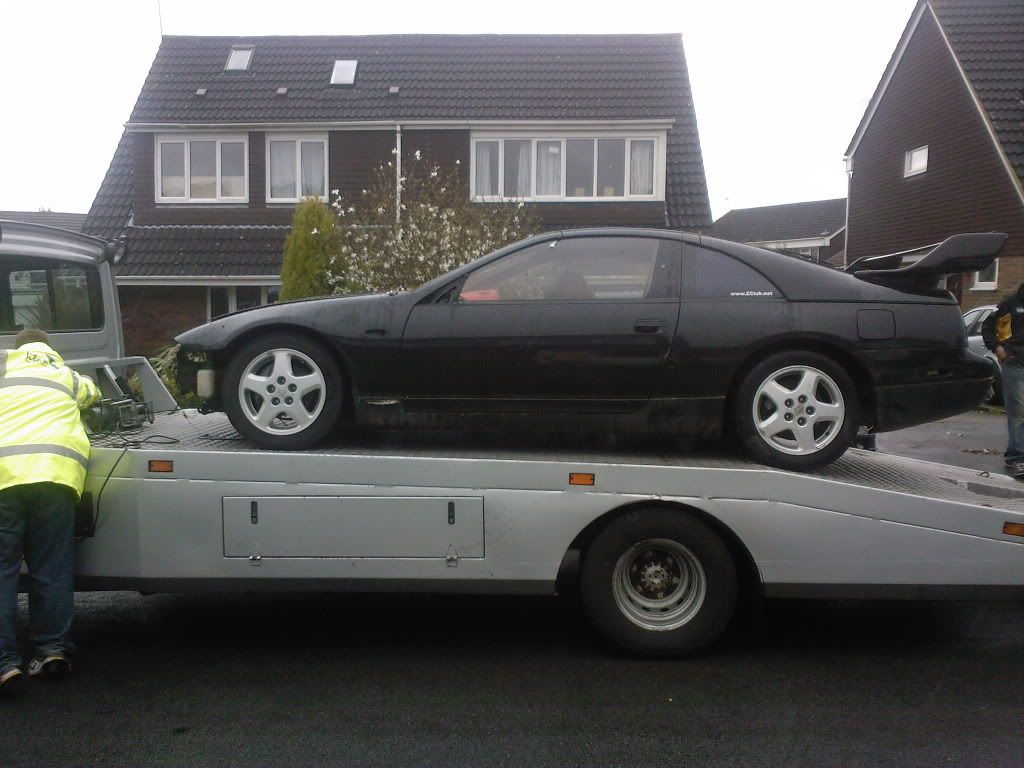

heres the car when we picked it up...

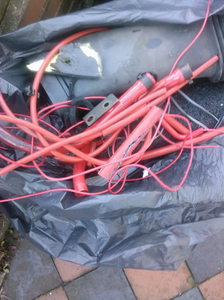

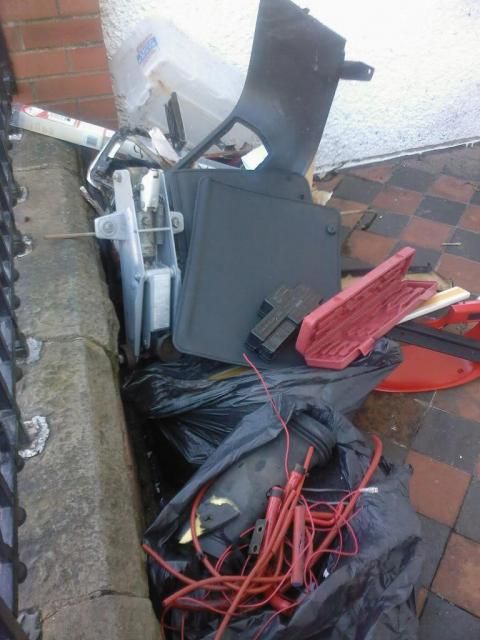

first thing was first was to clean the inside out, 2 black bags of rubish, and loads and loads of read hoses/cables etc etc that made it lookt cheap

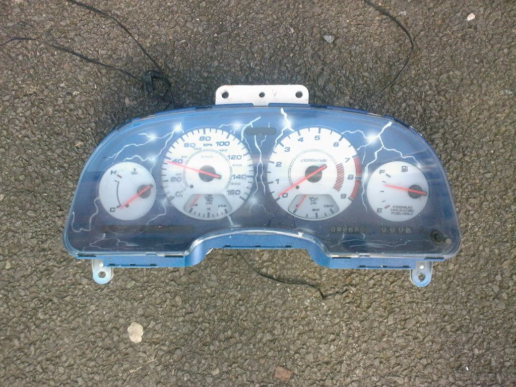

and these awful awful awful clocks! lol

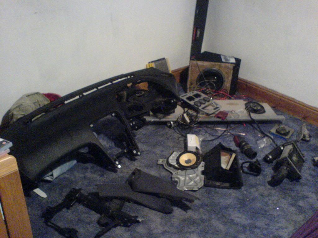

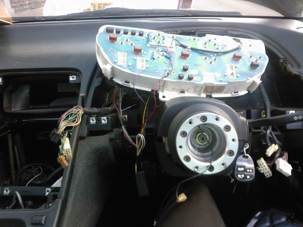

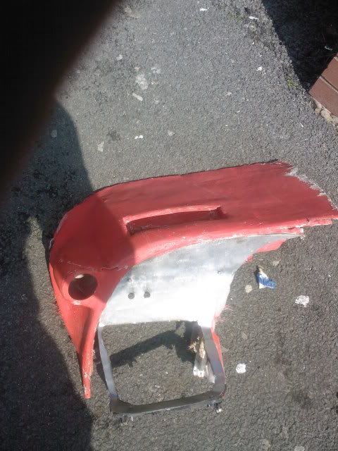

dash board was all messy, as it was covered with leatherette, and had 4 or 5 holes init where god knows what had been screws into it. and as someone mentioned, awful read panels!

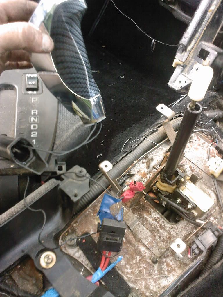

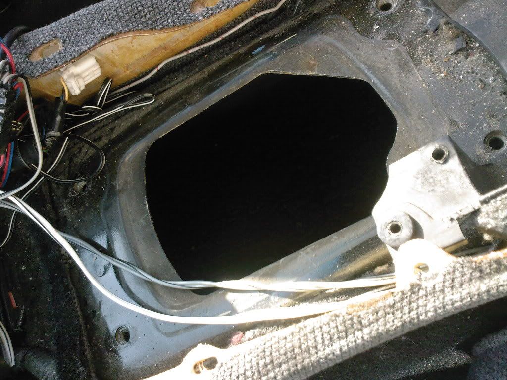

then was time to get the automatic shifter off, and auto box off.

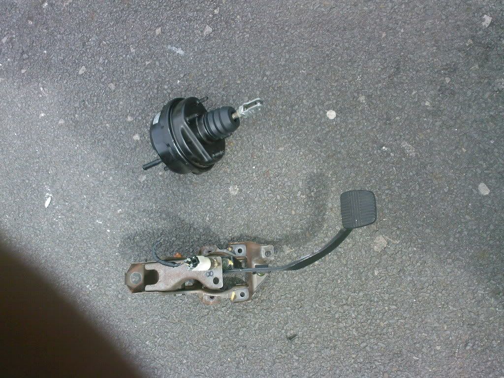

clutch pedal removed from the manual...

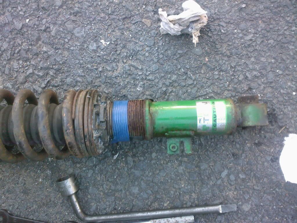

Tein coilovers removed from mine
spoiler and lights removed, and bumper also. going to stock rear end as prefer it

So glad that horrid bodykit and rear lights are being removed. Sure is an ugly bugger in the first 2 pics! Amazing to see how ugly people can turn a beautiful car into. Nice to see the project moving along. Be good to see it complete. :cool:

PMSL @ those clocks! Have no idea what went through the person's mind that chose them!

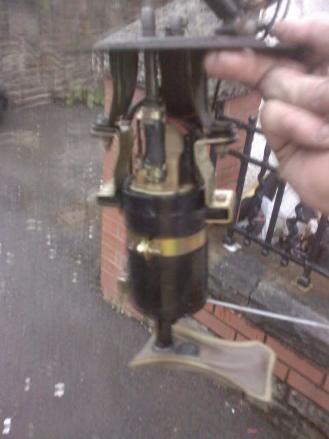

swapped fuel pumps

removed dash

removed clutch pedal (that was loverly job :rofl: )

gay automatic selector,
Wasn't one of those hideous Navan shifters was it that looked like this?

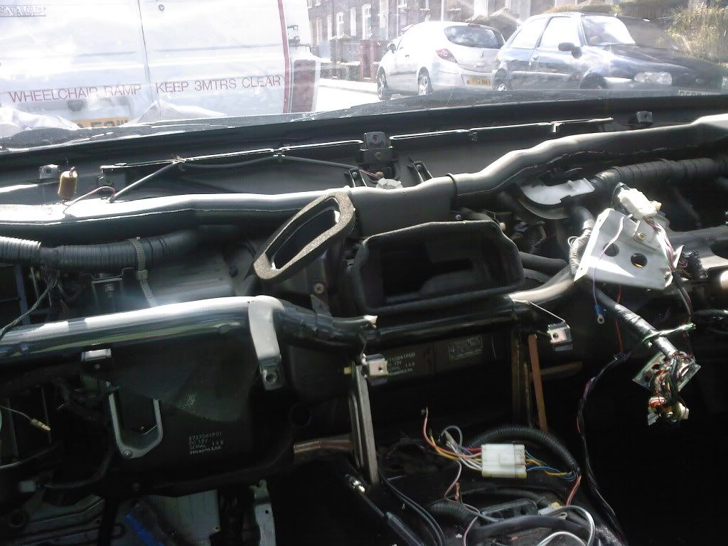

out of intrest how hard was it to remove the dash. my1 needs a bit of work
quite straight forward to be honest mate, theres a guid one here, but theres not that many bolts holding it down, and their easy to get at.
the glove box took the longest, but read the guide and u know what ur doing.
was a bit tricky removing the window de-mister without snapping it tho lol

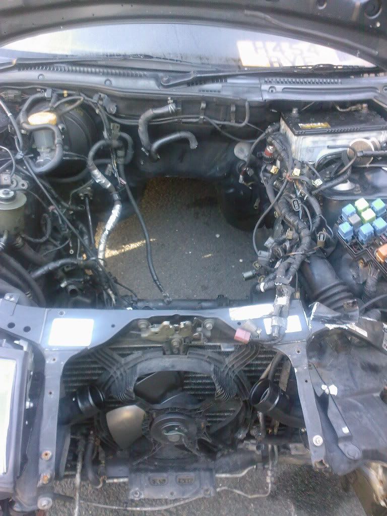

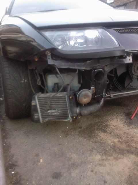

as this shell is NA, there are obviously no intercooler piping.

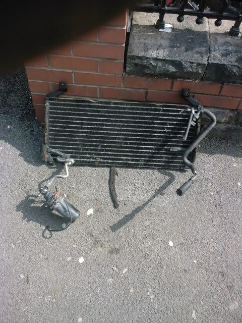

the NA aircon rad is a bit bigger than the TT one, so theres no room for the IC pipes with NA aircon rad.
as aircon is just un-necessary, and heavy, its being binned. :p
intercooler pipes removed from the TT,
and fitted :)
quite easy to be honest, was a pain in the arse removing the pipes from the TT, but when the aircon rad & engine rad is removed its very easy, they just fall out

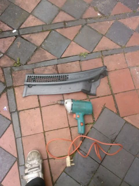

needed to remove a panel from the old car, as the new one didnt have.
the plastic screws had been rounded, so drilled out with the 1980s black and decka lol
fuel pumps swapped
heres a random pic of that dash :hurl:
