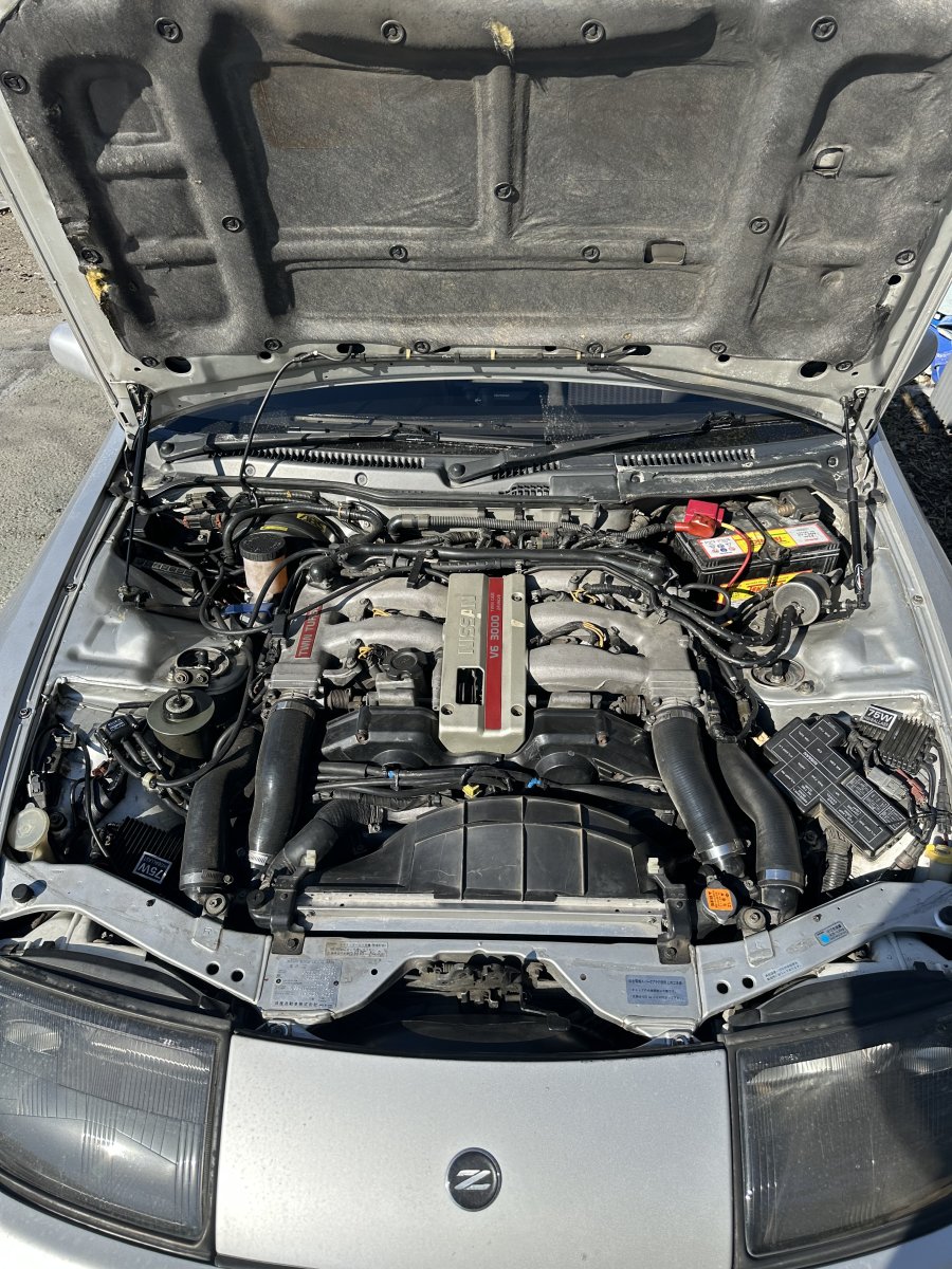

  1. So updates ..fixed most of the above… Brakes are amazing + ebc red stuff pads Car now is manual since November 2025 Has stillen sway bars front and back. More sound deadening and amp installed Window sliders fixed, new front fog lights installed Some interior trims tidied up and Hks boost control installed because I had it sitting near by😁🤷 Parts arrived from USA… thanks to czp 👌🏻 Intercoolers, aluminium radiator, oil cooler 19row Link ecu / haltech dual wideband. ( mfd28 for gauges) and sensors , boost solenoid Arm 320 lb fuel pump with new assembly.. 850 late side feed injectors, r35 coil pack and adaptors Egr delete kit , second apexi air filter 🤞🏼 they will be installed by the end of the year.. also energy bushings almost done need to install the rear subframe and differential ones .. power goals safe 430/50 bhp until the turbos give up 🤷🫣
