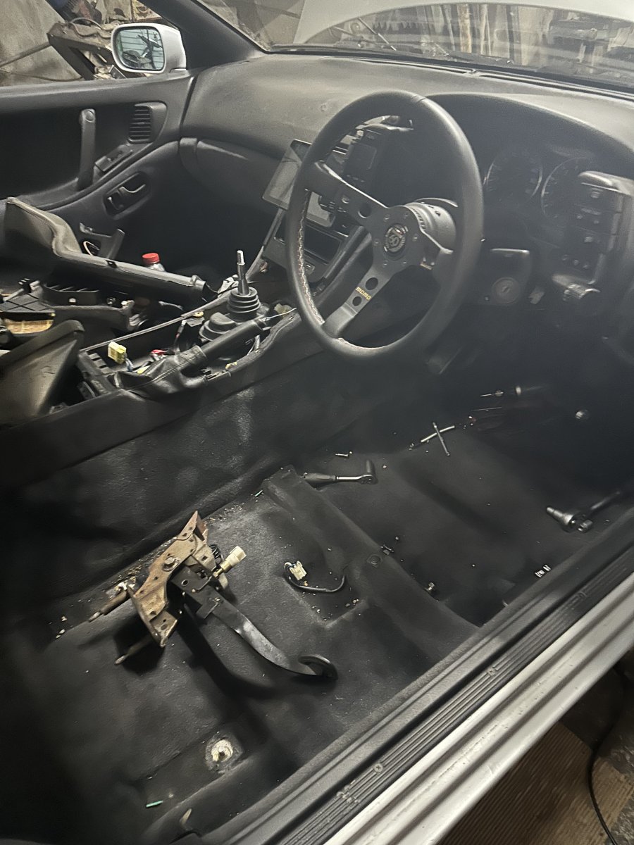

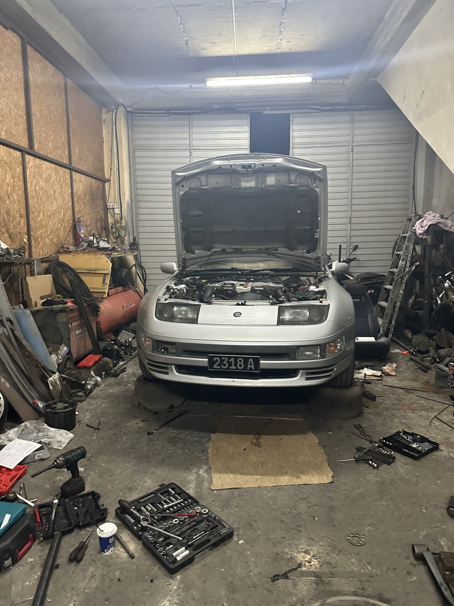

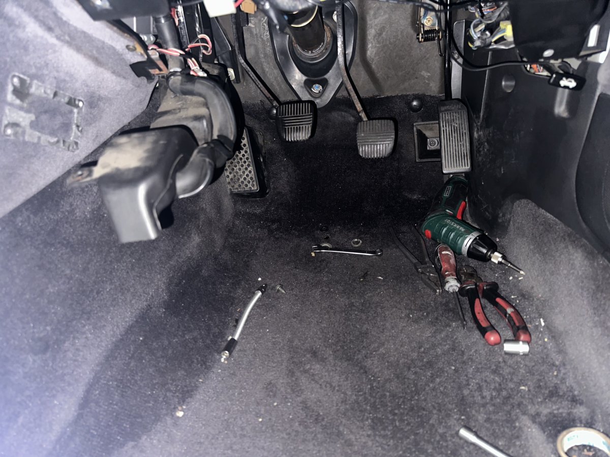

More updates due to a friend backing up to his manual conversion I ended up with the parts..
manual gearbox from a TT, with short shifter
shaft 1/2 from the manual, vacuum pipe
Aftermarket light Flywheel used
ย Sandwich plates, clutch pedalย
slave clutch cylinder with braided clutch lineย
na master clutch cylinder.ย
ย
ordered the front and rear oil sealsย
ordered a gasket for the frontย
reverse light sensor due to being unusable(cut plug)ย
got the staff from Ihtar in eBay Rev it Up with us.ย
ย
ย
ย
Also got the Stillen hicas delete from ebay
and a gktech en/vg clutch fanย
and an spec air filter from Torquen ๐Ÿคž๐Ÿผ itโ€™s not going to take 3 months to arrive as the brake adapters ๐Ÿคž๐Ÿผ๐Ÿคž๐Ÿผ๐Ÿ™„

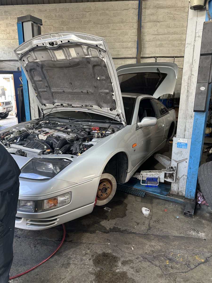

Back to Cyprus ! so front tension rods finally installed after fighting with intercooler pipes and sway bar so ..much fun but the braking shutter stopped and the car feels solid .. just need to find a way to install the plastic air deflectors for the brakes ๐Ÿคช
Plan is clean it tomorrow and make them gold wheels shine again ๐Ÿ˜
