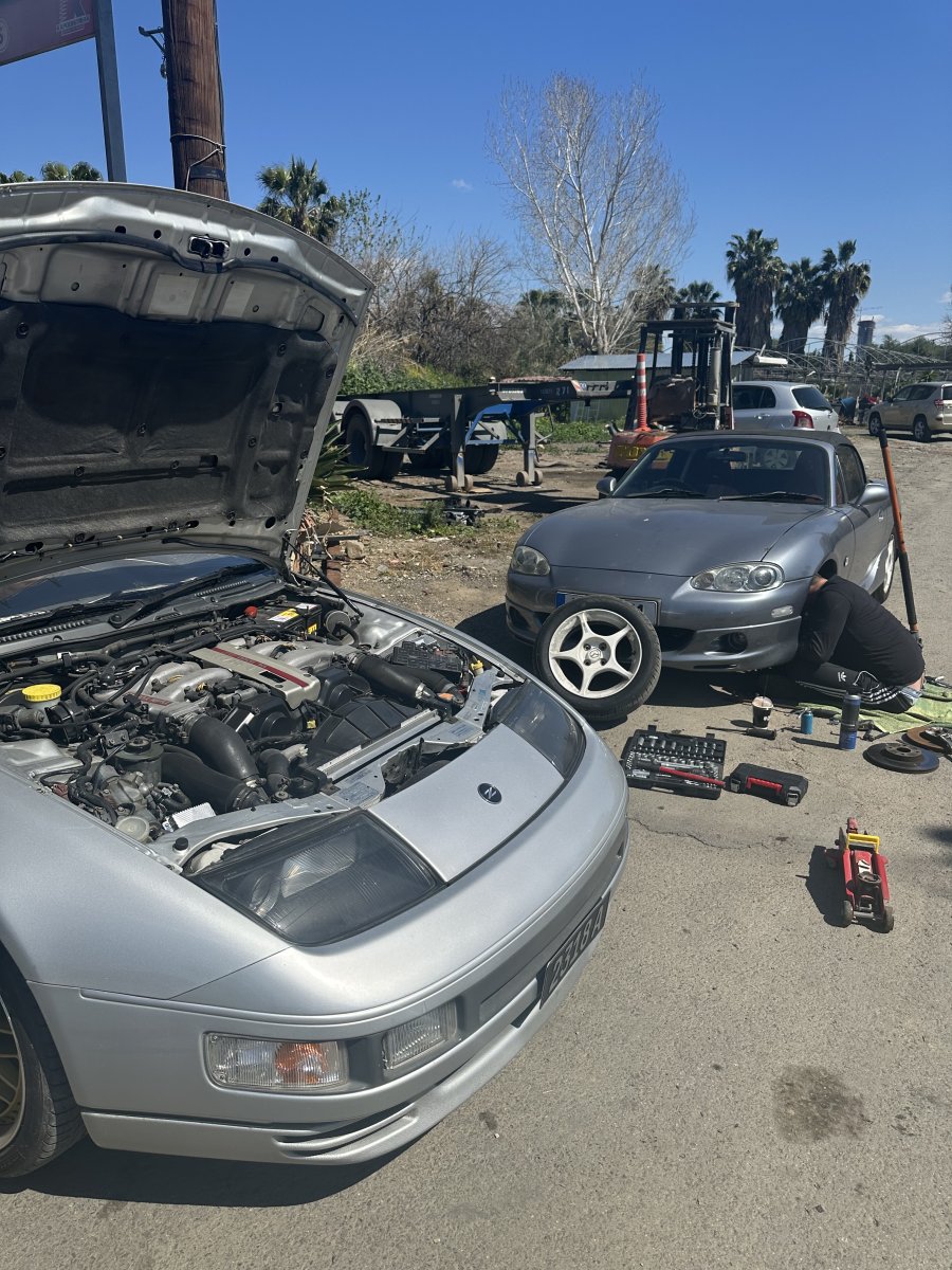

  • A friend around is also a nice add on
  • Things move slower than expected now that I am back home.. updates.. Installed the gktec fan ( it’s loudish) Apexi filter is stalled Front strut bar installed Mono steering installed.. Xeon lights and
