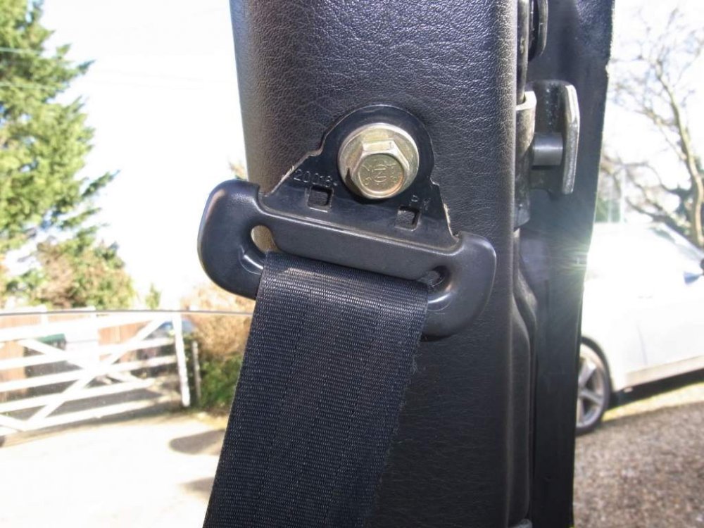

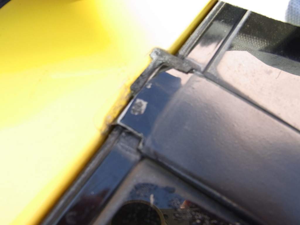

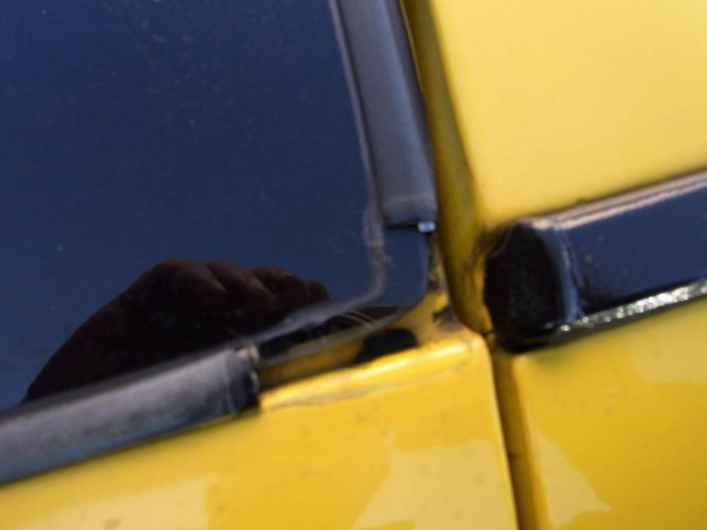

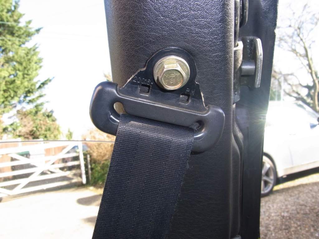

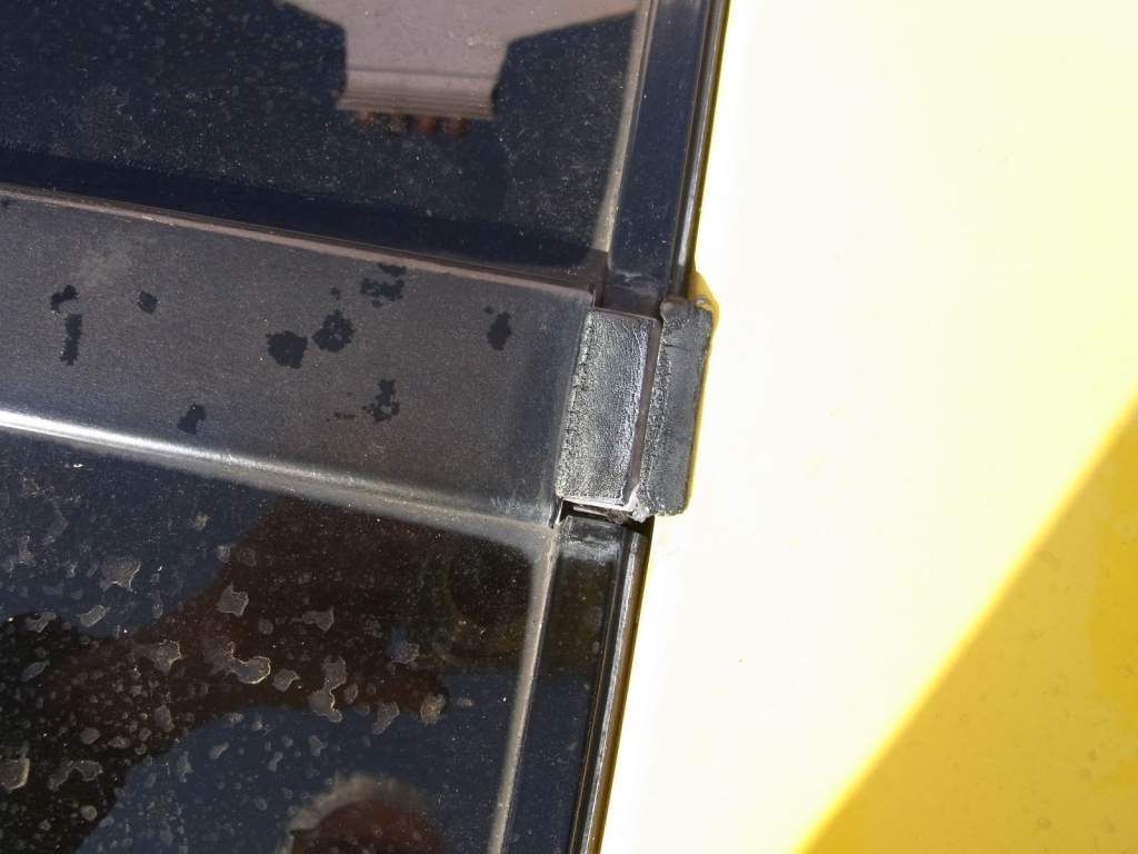

Hi have bought a Z that's a lot worse than I thought if anyone has any of the following please let me know Many Thanks All Items are for a SWB NA Stainless Exhaust system Steering Rack Trim for top RH corner of tailgate glass Trim for both ends of centre section of T Bar Trim Cover for Door only visible when window is down (both doors) Trim cover for seat belt mounting at top of door (both sides) Rear trim panel that holds third brake light Rear internal boot trim that covers where tail lights & centre garnish are Front Bumper I would like the trim that covers the radio and the bit that goes to the arm rest, but hopefully another member advertising parts who I have messaged still has these, I have attached photo's of the area's missing bit to try and clarify Any help gratefully received Thanks again regards Marc

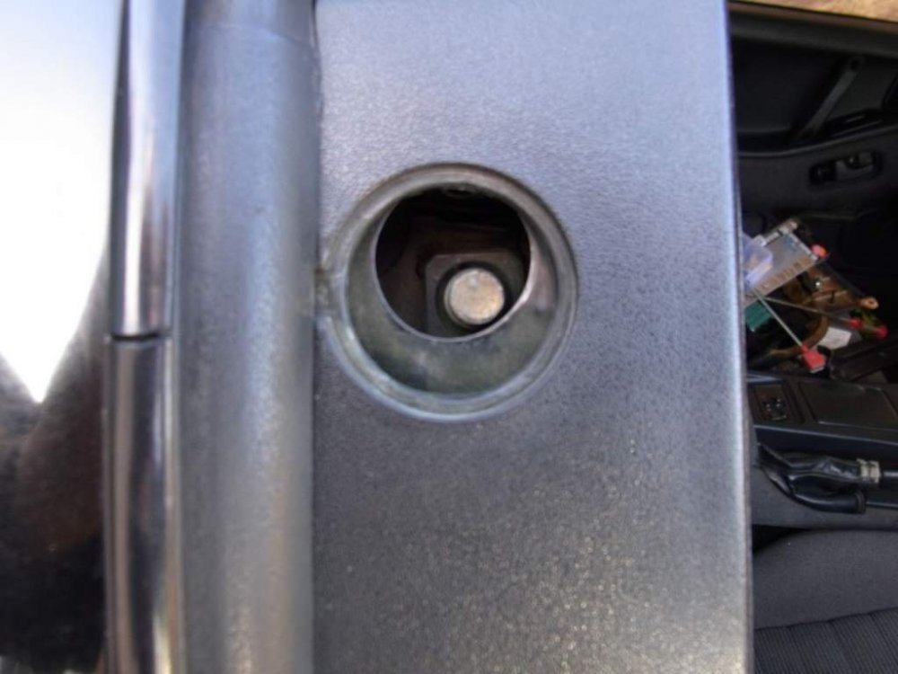

I am working on the replacement rod carrier for the lock barrel, can anyone post up a picture of the rod (with dimensions if possible) that fits on the lock barrel going to the part that locks/unlocks the door as this part is missing and I will have to try & manufacture something to replace it. Also can anyone recommend a supplier of exhaust systems that are not going to be more than the cost of the car, also boot is getting wet and I have traced it to a crack in the panel that holds the third brake light, its cracked right through so I need a replacement are they difficult to source ? fortunately the previous owner kept in under cover so the boot floor, wheel well & under the tool kit is all solid, but I dont want the boot to get wet Thanks again everyone

Hi Alic there is no plastic part on the back of the barrel and there is no connecting rod from the rear latch that would be able to be attached to the plastic part (if I had one) and the key will rotate the barrel almost a full turn so I'm assuming like everything else I have come across in this car the broken parts have just been removed and thrown in the bin I have had a look at the link and I assume that the larger hole with the two slots goes over the back of the key barrel, I cant tell if that's what is missing as there is just nothing there at all, presumably the other hole requires one of those plastic snap over clips to hold the metal rod that connects to the lock. I will email them to see if they would send to the UK, I have also looked at the link that Gaz 300 posted, can't find any electrical connectors so I'm thinking that my car has never had that large white plastic surrond that controls the Key Hole light and the factory alarm system which I assume my car would also never been fitted with, hopefully you can fit the part to take the rod without the support of the white plastic surround.

Well another day on the Z and it just keeps coming, drivers door will not open on the key, (to much faffing around & run the battery flat so no remote locking) have removed the door card only to find that there is nothing on the back of the lock barrel, I assume that there should be a metal bar of some sort & some way of attaching that to the end of the barrel & presumably the bar should attach to the internal door lever somehow, anyway that's all missing and the cast handle has been bodged, so if anyone knows of or has those missing parts or a complete drivers O/S door handle I would be delighted to hear from them. The only way into the car was through the passenger door as the lock on the tailgate does not work on the key either (always been opened from the switch by the drivers seat previously) I will investigate as time permits, would be nice to get just one job complete. Any help or advice gratefully received Best Regards Marc
