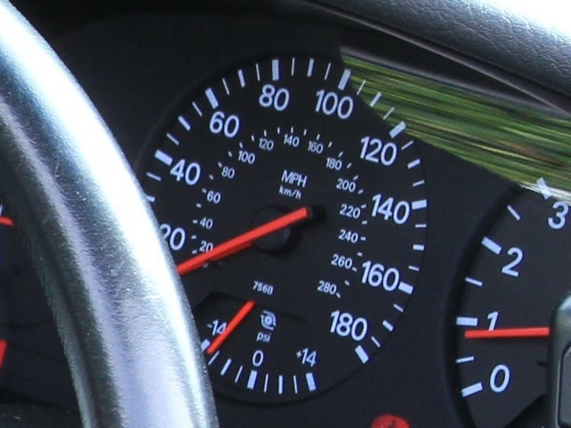

Due to new MOT rules in Northern Ireland my MPH clock will be an mot failure as they now need to show both MPH and KPH. So I need a MPH/KPH speedo cover plate and over the last few months I cant find any for sale. Does any member know where these can be found or do you have any?

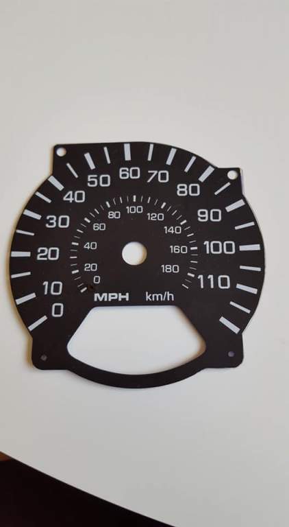

Look what I found buried in my garage! I thought I bought a set of 300zx clocks a few years ago but when I searched weeks ago the only clocks I found were for an Audi so I gave up. Then today while tiding up the garage I found the 300zx clocks and they have the MPH/Km/h. Happy days :thumbup: Now just need to fit the new face.

So my jap clocks have a speed converter attached to them to make it read MPH but now have a MPH/KPH face so do I need to remove the speed converter? It feels like I am doing 60 mph and the clock is reading 40 mph:sad:
Edited by Gaz 300
If you have fitted the dial face that you posted a picture of in this post then you do need to remove your converter, the standard JDM KPH dial reads to 180Kph so needs the converter whereas your replacement only goes to 110 in MPH roughly 180KPH, I had the same issue with the speedo on my GTO

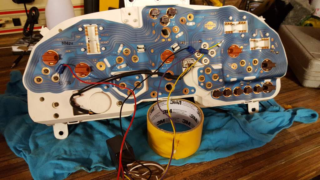

Thanks Marc I have already disconnected the speed converter and now the speedo wont work...... Back to the drawing board.
If I remember correctly when the converter is initially fitted one of the tracks on the flexible circuit on the back of the gauge unit has to be broken so the signal can go through the converter, that connection needs to be remade when the converter is removed, if the converter has a manufacturers name on it you could obtain the original wiring diagram for installation and see which track or tracks were interrupted.
