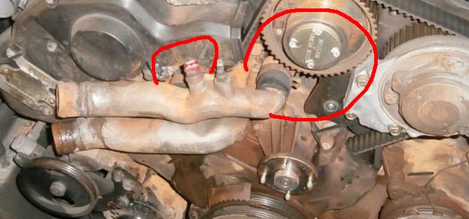

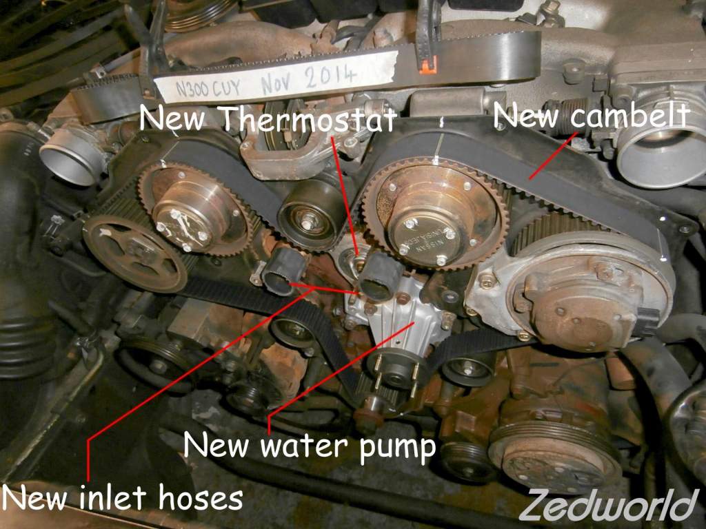

No need to remove left hand cover cam covers, the right hand one would help a lot, but not really needed and saves messing with PTU etc. Assuming it is the inlet hoses that have the problem, remove radiator cowl or rad if you wish but again not required. Remove water pipes to alloy pipes, unclip wiring loom, remove fan blade ( just the blade ( 4 x 10 mm bolts).
Now you have a good view access to look at the rubber pipes, if split then you need a long hex drive 5.5 mm maybe 6mm ( from memory )and a 12 mm socket on an extension to undo the fixings for the alloy pipes the lower one first to give more access to the pipe clips, release the hose clips with long nose pliar`s and pull the alloy pipes out.
Now the remainder clips can be removed and the two water pipes cut off as they tend to stick onto the steel outlet pipes from the block. Clean and fit new rubber pipes (with a smear of silicon sealant ) , fit rear clips in the correct position and fit the front clips with the tabs facing down but push them back, refit the cleaned alloy pipes ( with a smear of silicon sealant ) and do up all of the fixings, NOW pull the front clips into position. and assemble everything in reverse order.
When refilling the system always have to heater on max heat and the fan on at least low speed and econ activated, this just opens the matrix valves to aid air bleed, add the max amount and wait till it drops, once you can not get any more in start the engine and allow to warm, adding as required.
The rubber hoses are quiet expensive from Nissan so it is easier to buy a one meter length of 30mm pipe from your local factors and just cut to length, exactly the same thing.... just cheaper.
Pics from a belt service I did some time back in the workshop, they should give you a little insight in to what to expect, of course these are for cambelt and pump change so a lot more stripped out than you would need to.
Have fun
Jeff
