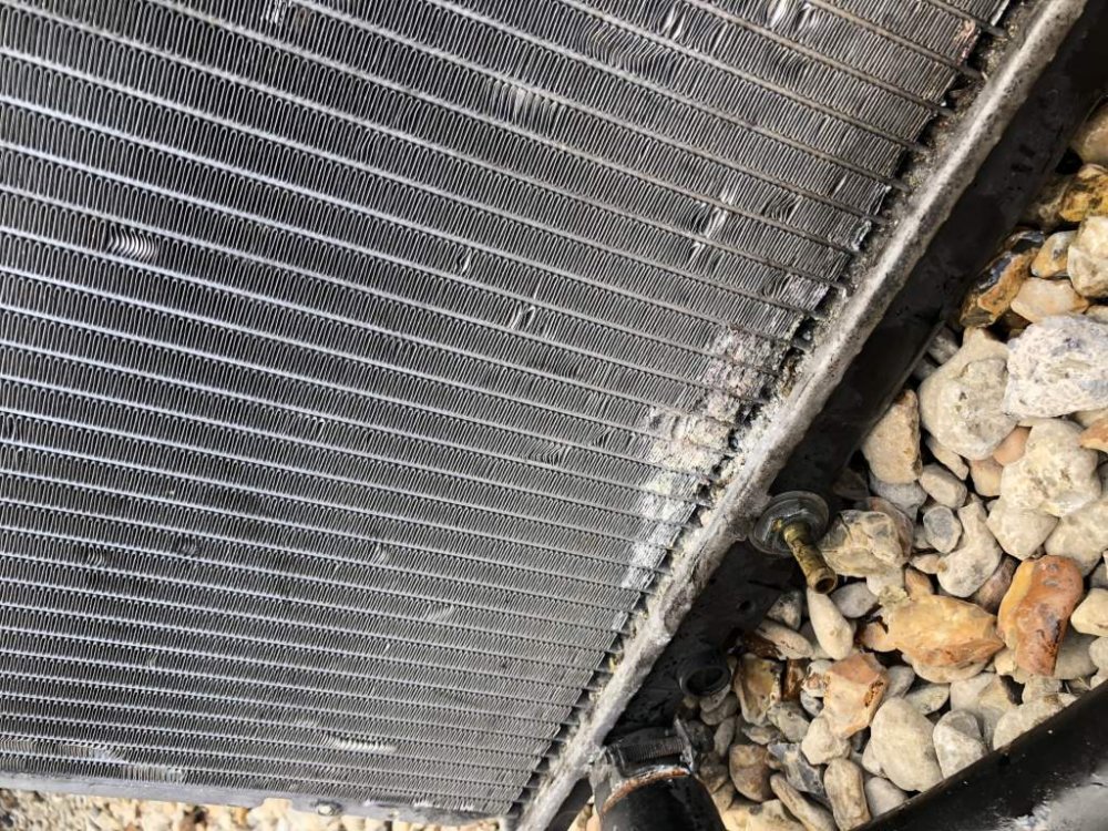

Radiator for Manual NA is it the same as Manual TT Radiator
Hi I need a new rad for my Manual NA, is a Manual TT rad a straight fit or does it require modification
THanks in advance for any help

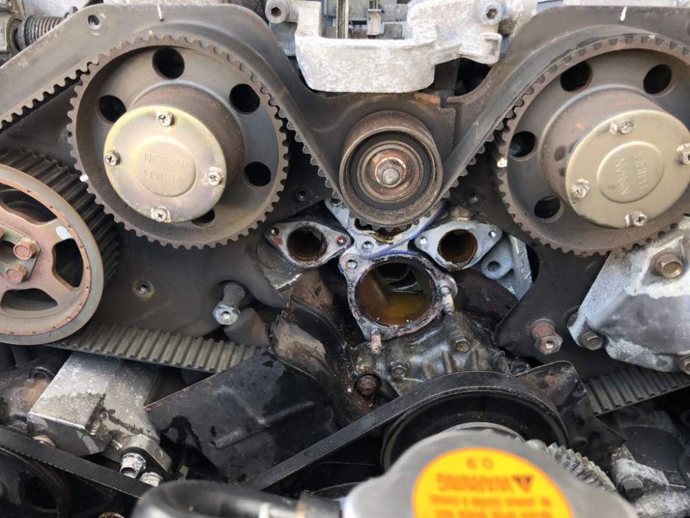

OK guys, have ordered the hose for the bypass, removed rad, removed fan, and have managed to remove the thermostat housing, however one of the M6 socket caps (the one you cant see without a mirror) has been butchered by a previous owner/mechanic all the socket caps and nuts are removed except that one, seems almost impossible to get to
Anyone had this problem & found a satisfactory solution, I am a bit stuck now

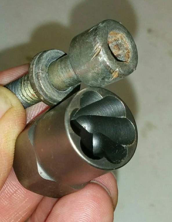

This type of tool should do the job:

Andrew, what size and manufacturer is the pictured removal tool please, and do you need to hammer the tool on to the socket cap before attempting removal also did you use brute force of a air hammer
Many Thanks
Made by Craftsman (see my earlier post #24 on alternatives) marked #8. The bolt head diameter is 13mm.
The tool is case hardened and cuts into the bolt head and grips it as you turn it counterclockwise. Just use
a ratchet handle and push the tool firmly onto the head of the bolt and turn.
I have a set like this. Cost about £13 and never let me down. Great tool to have

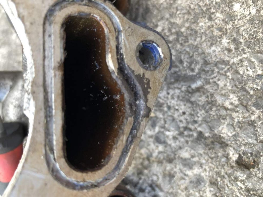

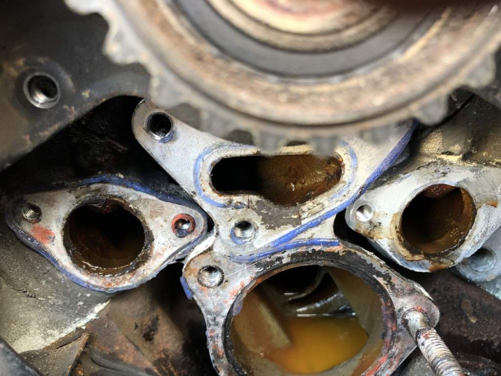

Thanks to AndrewG for tool recommendation, after a bit if a struggle its off, I have removed the Bypass hoses but the condition of the steel tubes bolted to the block are in very poor condition, so if anyone knows the part number or even better has a pair they would be willing to sell me I would be most grateful.
These cars certainly have a Interesting design round the cooling system, it seems very prone to failure with those two bypass hoses and the mix of materials used, will be spending the afternoon trying to locate a replacement socket cap
The two aluminium hose connectors appear to have been sealed with a liquid gasket and the Socket caps have been treated with threadlock, is this the recommended procedure for refitting these items ?

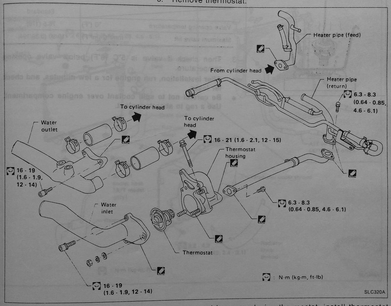

Liquid gasket sealer is specified (KP610-00250 or equivalent) for the aluminium inlet and outlet pipe connections. Threadlock on the
socket caps not required - see below from FSM (also shows correct torque settings for the bolts).
Part#'s and pictures for the items affected (from a US dealer):
https://conceptzperformance.com/nissan-infiniti-nissan-oem-300zx-coolant-bypass-tube-90-96-z32-14053-f651a_p_1914.php
https://conceptzperformance.com/nissan-infiniti-nissan-oem-300zx-water-pipe-coolant-outlet-bolt-90-96-300zx-z32-16163-f6510_p_4990.php
https://conceptzperformance.com/nissan-infiniti-nissan-oem-coolant-bypass-hose-nissan-300zx-z32-14055-f6511_p_1000.php

Mine was a fairly long journey and having been told it was the Rad leaking, just made sure it was topped up when we stopped for fuel, when the gauge started climbing and we pulled off the road, coolant was pooling under the front of the car, have a look when its been running, through the fan towards the front of the engine I could see water coming from what appeared to be the water pump but on closer inspection the coolant was coming from above the water pump.
When I eventually got the aluminium casting for my top (the one with the sending units in) only one of the Bypass hoses had a hole in it but it does not need to be very big once the coolant comes out of the hose it was spraying down the block, hitting the fan and sending it everywhere.
Ok guys, my hoses have arrived, showing how inept I am at this, can someone please clarify before I start :
1) The RTV silicone sealant needs to be applied to one of the mounting surfaces for the two stubby tubes that mount on the block to take the bypass hoses
2) The RTV silicone sealant needs to be applied to one mounting surface on the top hose connector where it mounts to the block (the one with the sensors in)
3) The RTV silicone sealant needs to be applied to the recess that takes the thermostat
4) The RTV silicone sealant needs to be applied to one mounting surface of the thermostat housing (bottom hose fitting)
5) Do I use the same RTV silicone sealant on the inside of the bypass hoses where they mount on the top hose aluminium casting & on the stumps coming off the block
Please let me know how much of this I have got wrong
Many Thanks again for everyone's help
Silicone all but not 5.
You can usually tell things with silicone as they have a little groove for it
Morning Alic, the top hose ally casting has a groove in it, but the thermostat housing is smooth on its mounting surface and on the block where it mounts also the stubby tubes that mount on the block are also smooth on both the block and the tube mounting face, so do i put just a small bead of sealant on one surface ?
Correct. Not too much.
Best idea is to tighten the bolts down finger tight and leave for about half an hour, then clamp down. This way it doesn't force all the rtv out the way and creates a good seal
