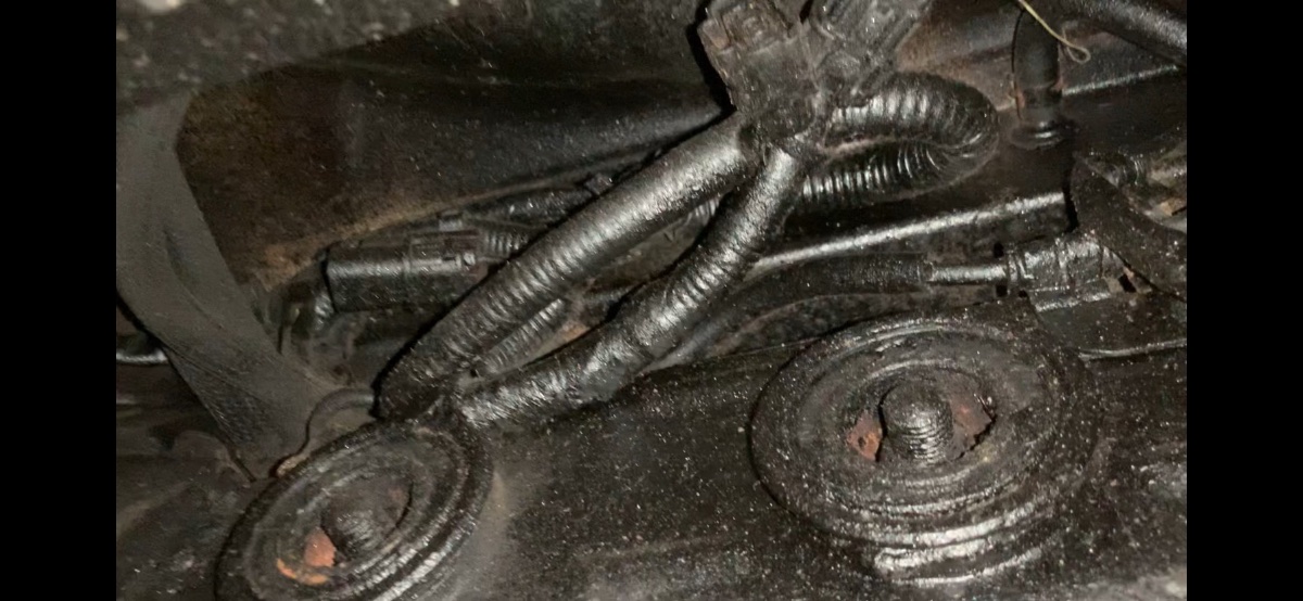

  5. Managed to find time to crawl underneath today, and found the (hopefully) attached image. Looks like all the connectors are still there, so hopefully it’s plug and play! That said, a) I don’t have the facilities to raise the car enough for the amount of spanner-wielding this would need, and b) it’s going to need Conzult to make sure it’s calibrated, so I might see if Jimmer is up for doing the actual plugging and playing post-lockdown ? Thanks for the help chaps!

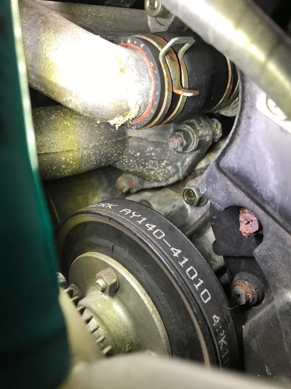

  19. Just an update, after looking through those instructions I thought I’d give it a go! Having sourced the new hoses, the right spec coolant and some new long-nose pliers and having a day free I spent an hour or so stripping down today, only to be thwarted at almost the last hurdle by complete inability to remove the 6mm Allen keys holding the hard pipes on. Despite a long soak with WD40 they wouldn’t budge, to the point where the ball head on my long Allen key actually snapped off! Probably not been undone since they were put there in 1996. Given that if I snap the head off one of the bolts it’s game over (and there are 3 more to remove) I’ve put it all back together and I’m off to see Jimmer next week. I’ve put some silicone sealant round the hose in case it helps stem the leak. So, not an unqualified success, but at least I know the rad comes in and out easily enough and the coolant looked nice and clean. Thanks everyone for the excellent advice and links. Chris
  20. Yes that’s what I thought, looking at it. Might pop down and see Jimmer and let him work his magic on it, I can just see me scraping loads of skin off trying to get access! Thanks for the advice
  21. Thanks for your reply Tony. I can’t even SEE the engine end, had to stick my phone down a gap to get that picture :). How much has to come off to get access? And is it possible to replace just one of the two short hoses, or does the other one have to be disconnected to remove the pipe and get clearance?
  22. Morning all. After smelling a bit coolant-y last night, I found a puddle under the Zed this morning. After crawling around underneath and tracing the path back up it looks like it’s coming from the short black hose at the top of the picture - in fact you can just see a blurred drop falling in the picture (assuming it’s uploaded ok). If I read the manual correctly I think that’s one of the outlet hoses from the radiator to the head? If so, any pitfalls in replacing it - or advice on how best to get at the rearmost clip, which I can only just about see! Thanks, Chris
