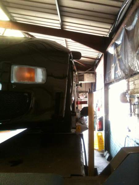

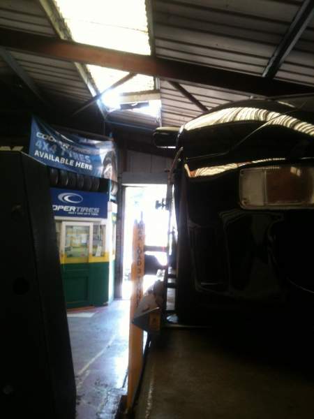

  1. With both of them out, it will be causing your problem. Also, with you saying you're driving with the wheel at 1o'clock to compensate, the HICAS will be trying to 'help you' at higher speeds, and so may be exaggerating the problem. Let us know how you get on, it's just a process of changing bit-by-bit until it goes away really :)
  2. I would definitely say 2deg out will certainly be noticeable when the car is on flat ground. I've recently sorted out a long running camber issue with my car, that the previous 2 owners couldn't figure out. Mine was 2.2degrees out, and pulled to the left, as well as scrubbing the inside of the tyre. What you need to work out is what part is out bent or worn. The annoying thing with camber, is that so many parts have an effect on the camber it's hard to tell which bit is causing it. With the car on flat ground, look down side of the car, and see where the front wheel sits in the arch. 2.2 degrees on mine meant that the top of the wheel was about an inch further in-board of the arch that the 'correct' side. Once I noticed it, you didn't need any tools to see something wasn't right! I have since fitted Adjustable top camber arms to compensate, and now the car runs so much better. It's advisable to replace the front tension rods when replacing the top camber arms, because replacements have bearings that don't like the side-ways movement of the big rubber bush on the original tension rod puts on it. Japspeed sell both bits, but they can be found a fair bit cheaper on 'the bay' Hope I've helped and not confused you by my ramblings! good luck!

  8. Hi All, Having owned my Z for 7 days now, I'm still in the process of trying to iron out any problems before the really bite me in the butt! I took the car for wheel alignment today, because the steering wheel wasn't quite sitting true in a straight line, which may have been throwing the HICAS out. The wheel now sits straight so that's one part ironed out... While it was up on the ramp for alignment, I noticed the drivers side front has a fair amount more negative camber than the nearside. The pictures aren't all that clear, but the drivers side wheel is a good inch further in at the top than the passenger side. This is confirmed by a worn tyre on the inside edge. offside Nearside What do I need to be looking at tomorrow when I get the car up on jacks? Other symptoms include vibration at 65ish, which I had put down to wheel balance Vibration under high speed breaking, which I had assumed was warped rotors. Any other suggestions on this would also be appreciated. Hoping to get this car handling the way I know it should!
