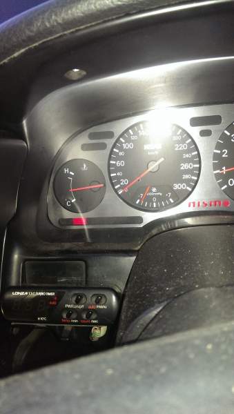

  14. I've unscrewed the left hand bleeder screw filled up with engine off until it came out of the bleeder cap took just over 2 litres sarted car left rad cap off and put heaters on full the car is now at normal operation temperature and the stock gauge is just below halfway as always but getting no bubbles at rad area heater is working ok...... But there is an odd noise ill see if I can upload a video

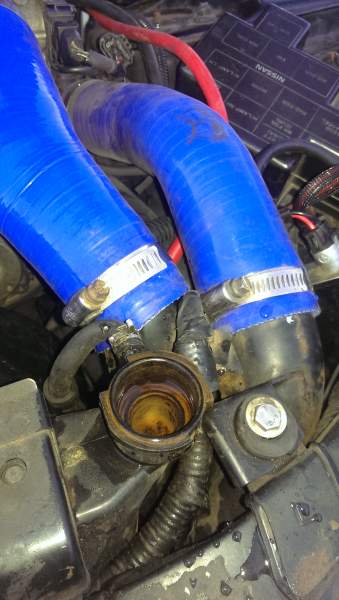

  15. Ok ive just removed the cap and there is no visible water even when I squeeze the left hand side radiator pipe. ive checked the expansion bottle and the level is half way up on the dip stick............... Im wondering if this is anything to do with the garage flushing and putting antifreeze in last month. maybe they didn't fill it enough or let any air ect out?
  16. Thank you, the rad cap did feel loose as in it would wiggle side to side , ill check first thing in the morning, many thanks

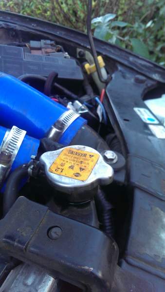

  17. Hi, Cars been running fine until I gave it a drive today, I noticed that the heater wasn't as hot as it should be, car was at normal operating temp according to the dial and the fan would come on and off as normal .but when I parked up with engine off I had a look under the bonnet and saw that the radiator cap was hissing and steam coming from it. Anyone know what this could be? ive spent so much on her the last year im worried that it might be head gasket? ;(
