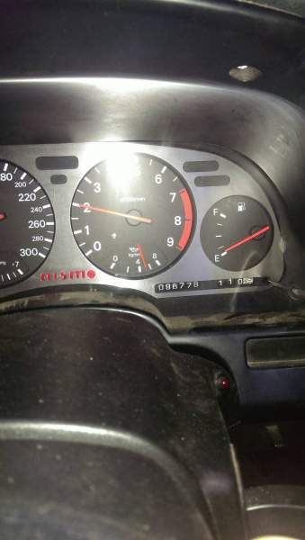

  6. Hi does anyone know how to set these up? Manual online is very brief. Got the boost working fine. It's the oil pressure I can't seem to get going properly. I've recently had my oil pump changed and by doing so it has sorted the annoying whinning sound and fixed the random tapet noises. I have disconnected the Oem sender and fitted the aftermarket one and wired it up correctly to the control box. But my readings are erratic. From cold the cars oil pressure starts about 2-3 as it warms the creeps up to bout 4 then once at Normal operation temperature the pressure rises above 5 and 6 when driven and drops when idle And sometimes drops to zero. Then while driving again sometimes the reading goes up to 10. I'll be very grateful if anyone can shed any light on this as I've spent hours trying to work out if its normal or wrong!! I can post a video if it would help

  19. At some points I too have zero oil pressure and it's exactly the same sound as the chap in YouTube
  20. Ok had this problem for a little while now it just appeared one day. and this video on YouTube is exactly the same as mine and the noise goes after the car has reached normal operating temperature. Even with an oil change and a good filter it seems to make no difference. The noise is always there and always the same length of time. In this YouTube link it says possible oil pump of feed blockage. Seeing as my oil pressure gauge is very erratic maybe this is the problem YouTube link Photos of oil pressure gauge I have replaced the sender with a new one as well morning Normal operating temperature So is it worth buying a new pump? Do these often go wrong? Or could it be a blockage?
